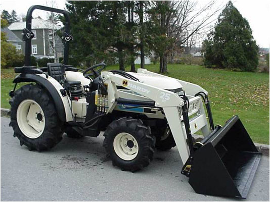

Anything wrong with this setup?
(B206305) Dual-Axis Remote Valve Control - Truck Equipment, Truck Bodies, Truck Accessories & Equipment Parts - Kaffenbarger Truck Equipment Ohio Cincinnati, Dayton, Columbus, New Carlisle, Sunnyvale Texas
Alternate suggestions or sources?
Seems like a good way to keep a compact open station free from hose clutter by placing the spool valve below the foot boards,
Control unit plus two cables for a bit over $100 seems worth while
If the valve you are going to use is a spool valve, this remote valve will add your $100 to the cost of the spool valve.
If the remote valve is solenoid, you only need wires to the dash or joystick.
   / Remote valve control reference
The three spool DCV is made by Lamborghini. I'll be responsible for the cable connections at the valve.
Trying to end up with a install like this one. attached pic.
Three spool valve with a single dual valve remote actuator plus a single valve remote actuator.
