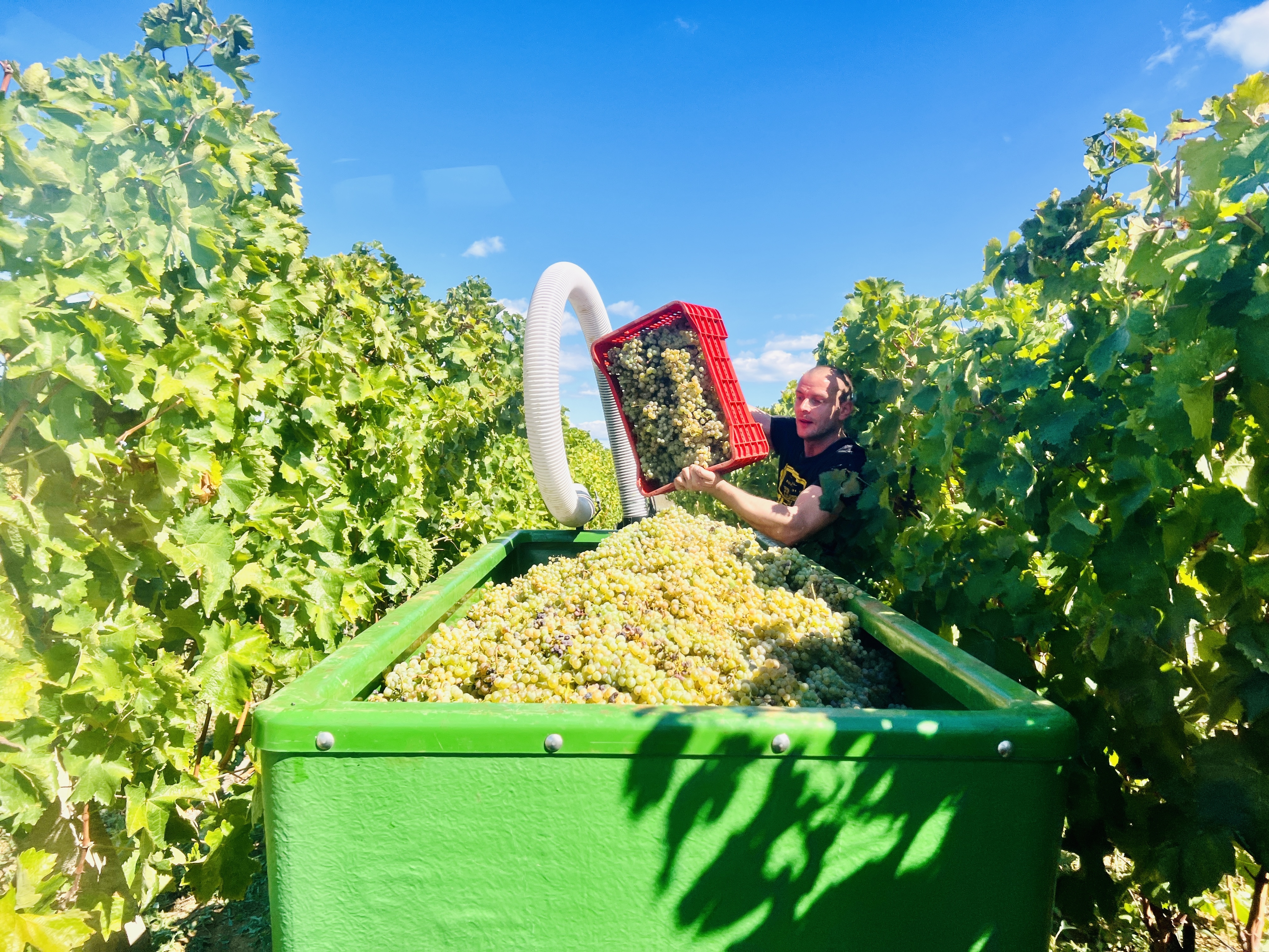

Hello, I was wondering has anybody wired a remote on/off PTO on a Kubota tractor? During our grape harvest, when unloading grapes from the grapes trailer (auger/pump, pto driven) in to our destemmer, sometimes I am alone running it all, it would be really helpful.
When the destemmer is full I need to run in to the tractor to shut the pto off, when the destemmer catches up, I need to turn it back ON. I need to stand next to the destemmer because I need to watch for any hard (scissors, rocks..) objects in the grapes.
I did some research, I think I will need a remote and a remote/relay, found some cheap ones running on 533 MHZ and a DPDT 12V relay to piggy back the priginal PTO switch and an isolation switch to kill power to it when I do not need this option.

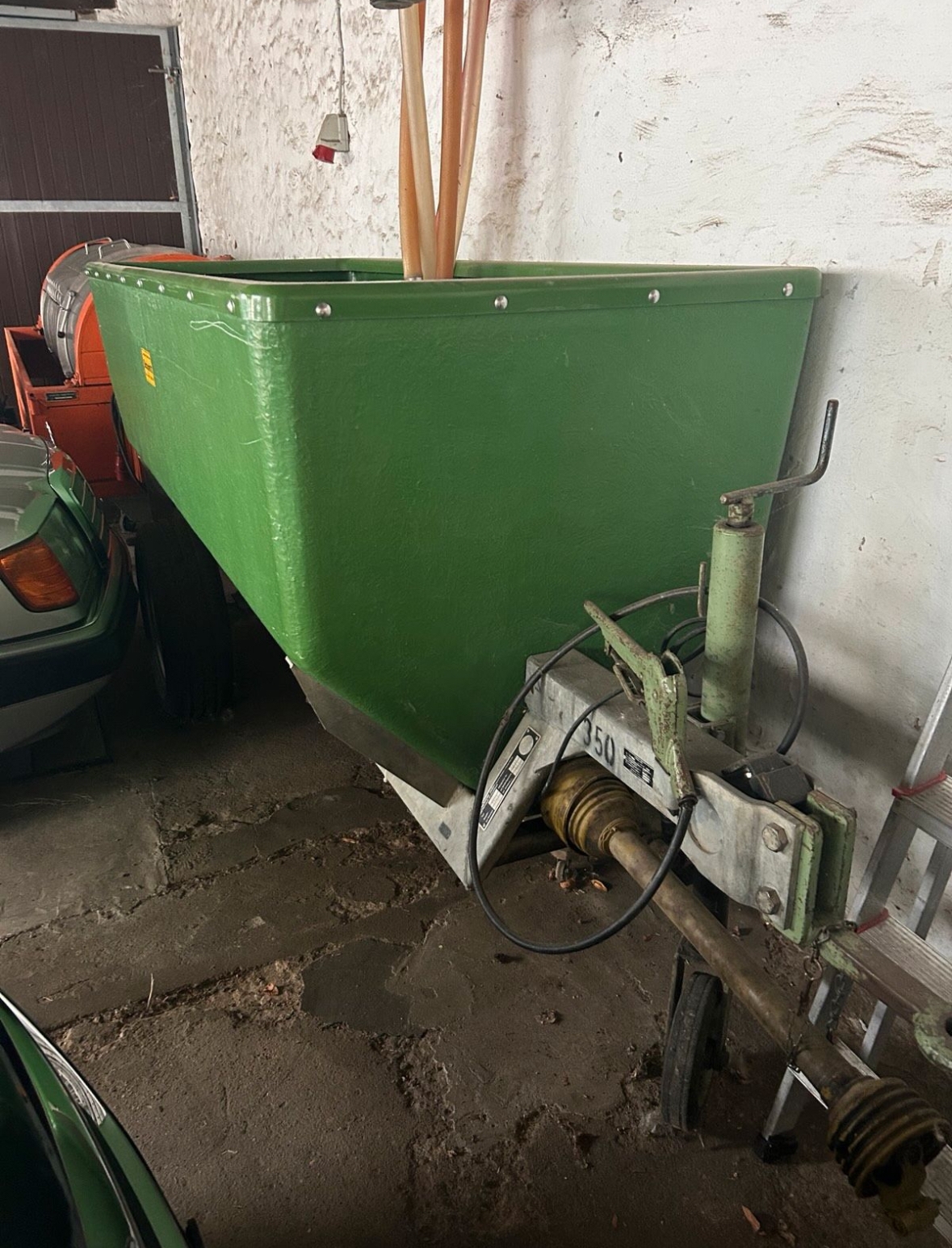

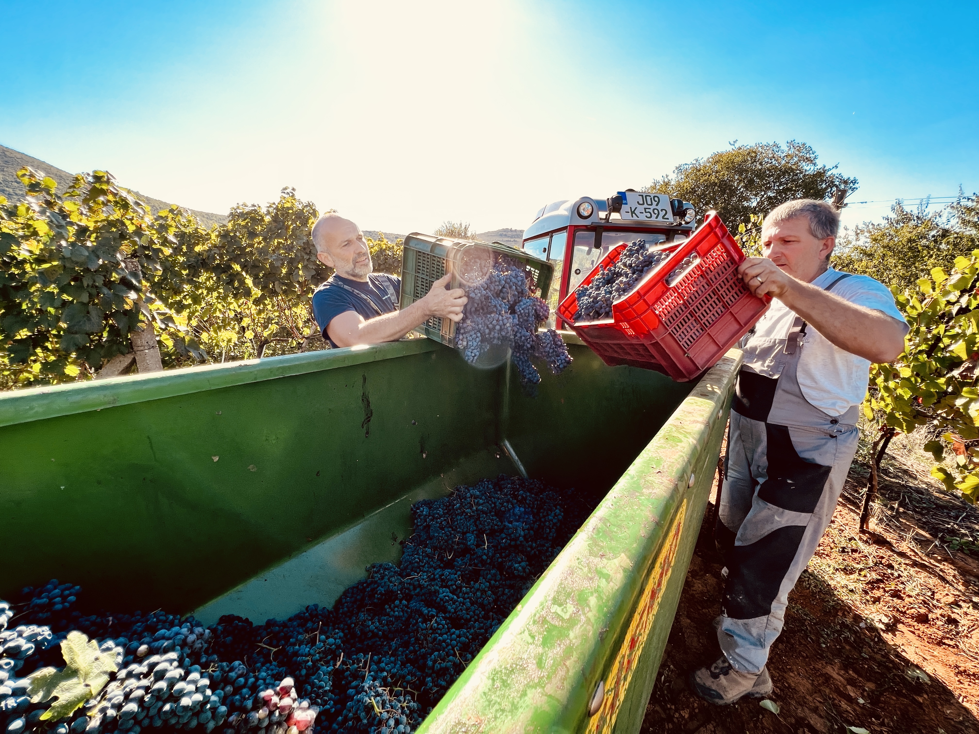

Thank you guys, much appreciate the input.i ordered some 3 pin Deutsch pigtails, they should plug right in when I unplug the original switch, it is easily removed… I will hardwire the wire in to the trailers, we have two. Use the original switch by making a easy removing mount.
I would not want the switch to be exposed to the weather while in storage, it has a original tarp but still.
Some photos of the trailers…
