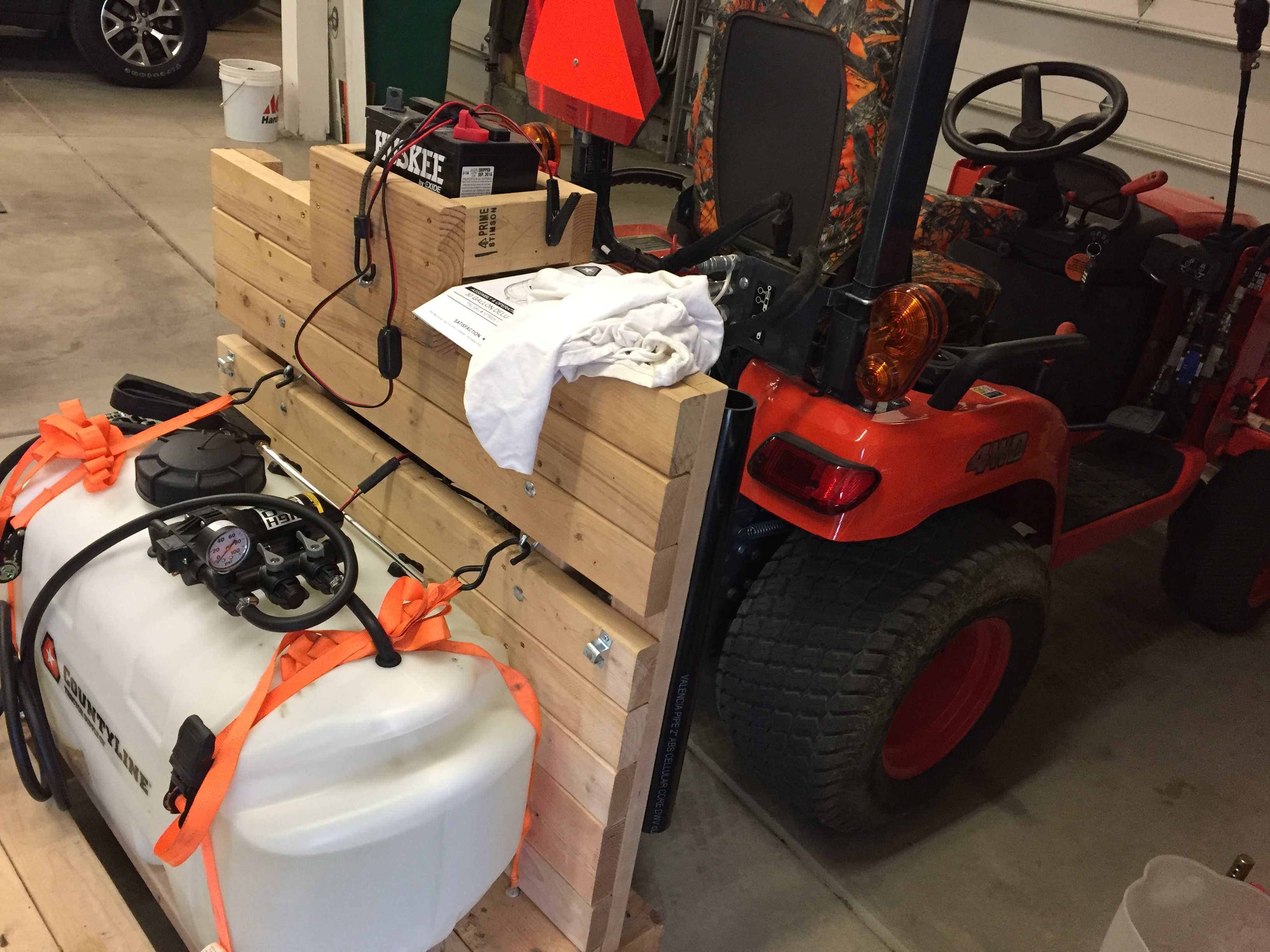

Hello.
Looking to see if anyone has added remote or extra battery cables or attachment points on a BX2370 (or similar model).

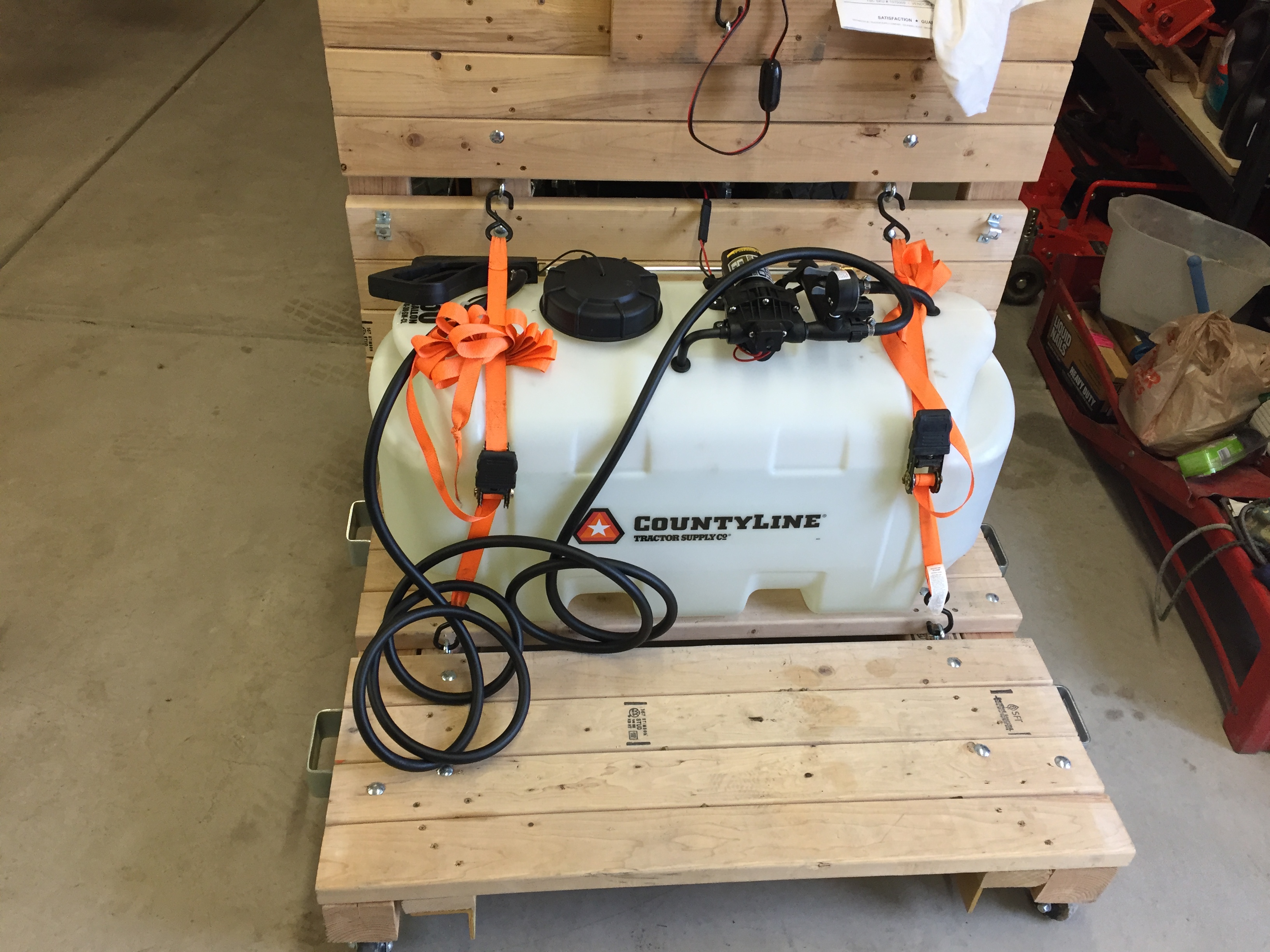

I am running one of the "Countyline" 30 gallon sprayers strapped to a carry-all for spraying my fence line. The sprayer works off of a connection to a tractor/car battery. I have rigged up a box that holds a battery, but the battery has to be charged in-between uses.
Since the BX has it's battery behind the radiator screen in the operator compartment, and hooking/unhooking cables is annoying, and having cables running next to my seat is less than ideal, I would like to mount cables to the battery that terminate near the back of the tractor that I can attach the sprayer to those?

Just run a line from the battery down to the back in corrugated conduit (cable tied all the way out of harms way) to an anderson plug attached behind seat somewhere that can't get damaged, then have an anderson plug on your sprayer so you can plug it straight in. And of course, do the usual, fit an inline fuse at the battery on the positive lead.

The Hard-wired Anderson plug is what I fit for customers who require 'remote' power on older tractors. An alternative is to fit a multi-pin trailer connector and just utilise two of the available pins..
But I believe the BX2370, like most modern (S)CUTS and even Ride-on's, has a dedicated 12V DC Power outlet which accepts a 'cigarette-lighter-type' plug.
Why don't you just use that power source?
/ Remote battery cables on BX2370 #7
there is already a power source for hooking up 12v devices in the back of the BX just above the 3 pt. inside the wire loom is a black electrical taped bullet ends. you have to dig inside of it a little bit to find it.

For my sprayer, instead of the alligator clips, They make a cig lighter adapter with an on/off switch. I plug it under the seat outlet and wrap it around my side handles a couple of times. They should carry them at your local ag store.

I put a ring terminal on the bolt of my starter. From there into a fuse, then up to the dash where I drilled a hole for a toggle switch. From the switch I went back down by the firewall and inserted it into the braided wire protection and pushed it back to the rear end. I then mounted a cigarette outlet on the rear cross member/fender bolt. The outlet has a plastic plug in it to keep junk out, but it certainly isn't sealed. May give me trouble down the road, but works fine now. I use the outlet for my sprayer, my aux lights (already had ROPS lights on the regular wire), and a battery tender so she starts nice during winter.
The sprayer load is 8 amps, the fuse is 10 and the switch is a 20 amp. The first switch, I accidently grabbed a 6 amp and it didn't last long. I put in a 15 amp and the contact melted off. So I put in a 20 amp. If that melts, I kept the receipt and will put in another one for free. But while it's working, it works well. Very convenient for spraying.
