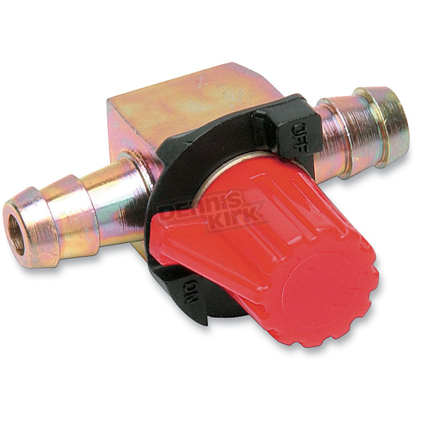

I ordered this little 5/16" in line shut off valve. Even if I leave everything as is, I will add this before the first filter.

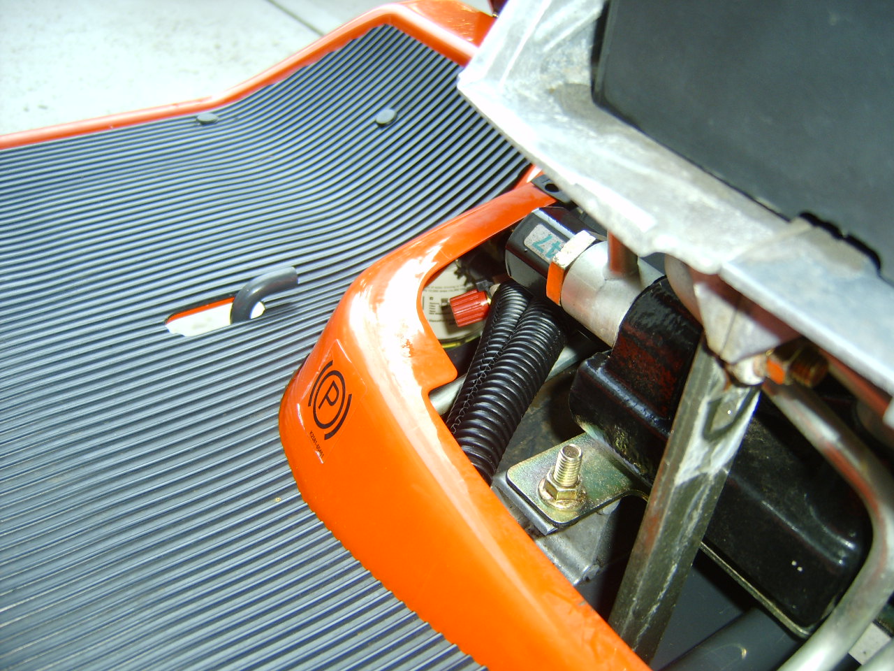

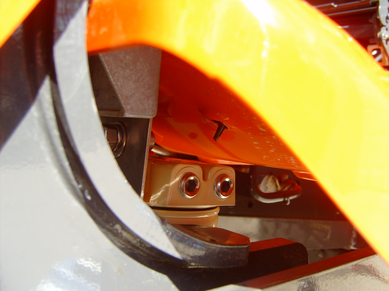

Update: filter installed and left pump in place.

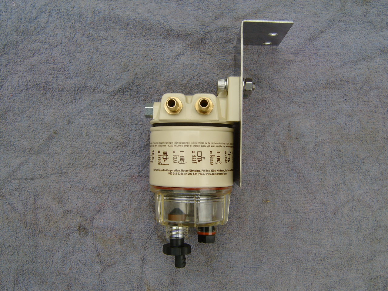

Well I spent enough time looking at it and finally came up with a plan and mounted my filter. I decided on mounting it behind the loader bracket instead of in front of it. I had turned the wheel all the way to the left and then jacked up the left wheel until the axle hit the stop on the frame. The front left wheel really tucks in very close to the frame and the loader bracket, so I decided not to mount in that area.
I made a stainless steel bracket that slides in between the front left floorboard mounting area. Just take out the one carriage bolt holding the floorboard, slide in the bracket, and but the bolt back through and tighten it.
I had read in another post about the Racor casting being rough. Mine is brand new out of the box, and the 1/4 pipe threads were a little rough about half way in. The new brass hose barbs did not want to go in smoothly by hand. Also, the little approx. 1/8" bypass hole that you see looking at the inside of the casting had a chip of metal stuck in it left over from machining. So I took a brand new 1/4 pipe tap and aluminum tapping fluid and cleaned out the four threaded ports. Then I took the vent plug off the front and gave it a good hot soap and water wash and thorough compressed air dry to make sure there was no more machining debris in the casting.
I used Gates made in USA 5/16 fuel hose and split wire loom covering like Kubota uses to cover hoses.
I had pressure washed the tractor before I started so that everything was clean, and then during the install, I took off the plastic baffles below the radiator, it makes it easy to run the hoses. I had never had them off before, and that was quite a surprise, amazing how much grass and dirt was packed in there. Cleaned it up in there while the baffles were off before I put them back on, good for another few years.

That's probably as good as any place, nice install. Also make sure the drain valves on the bottom of the Racor are tight, mine came loose right away and leaked.
/ Relocate the BX25 fuel pump forward.
#11
Thank you. Yes it already left a drip from the drain. Being cautious not to over tighten it being all plastic.

Nice job. Since I have yet to move my filter, I'm going to take a look at where you put yours. Maybe do the same. One thing I'm not sure of on yours - can you see the filter to see if it has water in it?
Also as far as locating the filter before the pump, like someone said, with the tank so much higher it's all gravity fed down to the pump so the lift pump really just needs to lift the fuel up to the engine. Same as with the OEM set up.
#13
Thank you. Yes you can see the filter if you kneel down and look up under the floor board.
