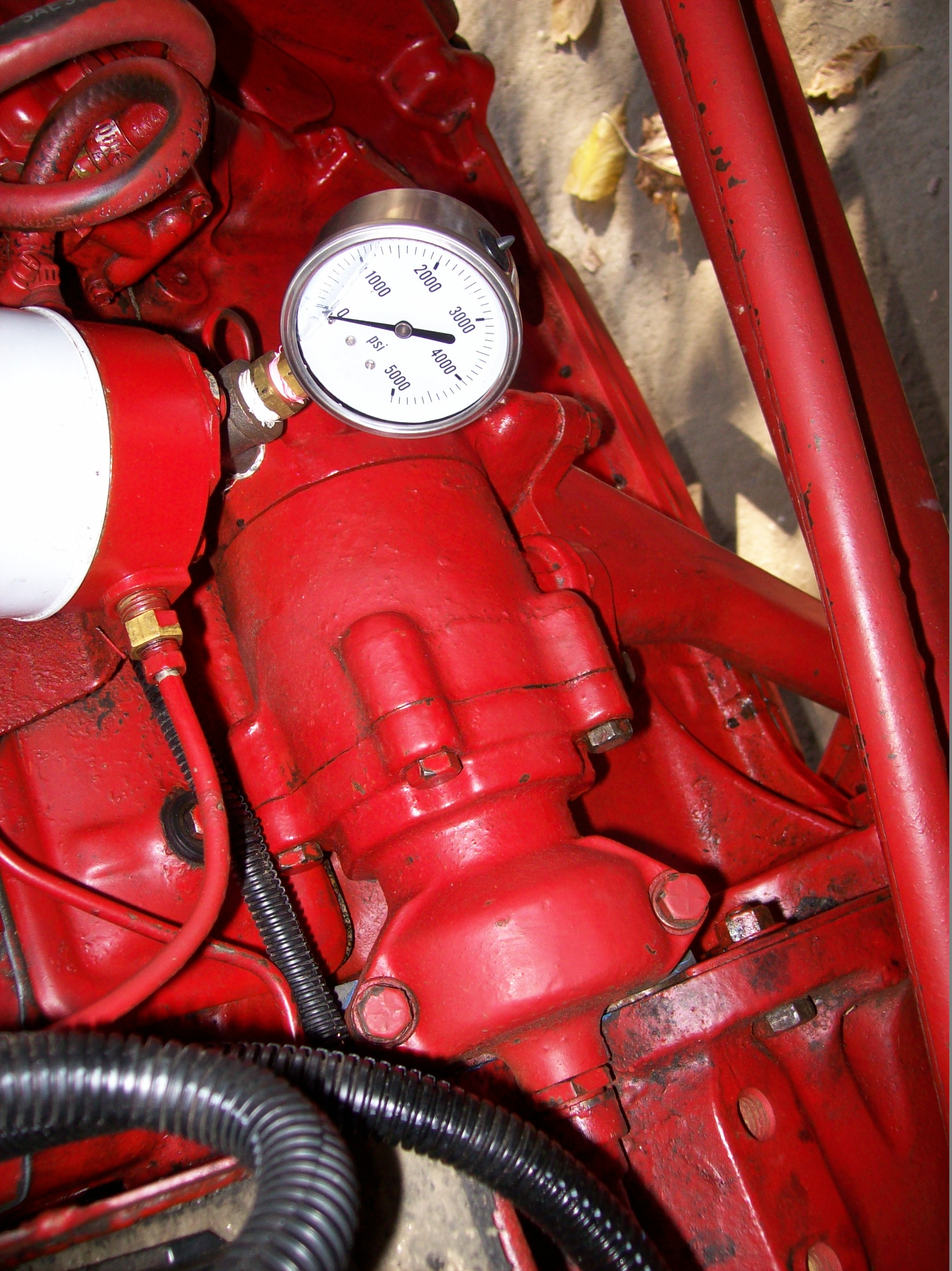

11-15-14_861D pump gauge 1.JPG Probably not necessary, but after I had trouble with my hydraulic system I mounted a gauge permanently on my 861D's pump so that I can see at a glance what my pressure is from the driver's seat. I forget what I paid for the gauge, but found it on eBay pretty cheap.

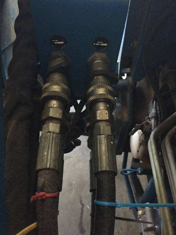

Post an update if you figure this out. I have a friend's tractor doing almost the same thing. When he tries to move the loader it just squeals.
I don't know much but, I'm driving to him next week to see what I can figure out. He took some pics but I can't tell much from them other than there are 2 quick connects that supply the loader valve which is mounted between the frame and the tractor with a cover over it.
It must be getting fluid since the relief is tripping. Maybe not getting back to the sump or the relief valve is stuck open. The 3 point operates ok.
From the pics he sent it looks like a PITA to get to the loader valve.

View attachment 555743 Probably not necessary, but after I had trouble with my hydraulic system I mounted a gauge permanently on my 861D's pump so that I can see at a glance what my pressure is from the driver's seat. I forget what I paid for the gauge, but found it on eBay pretty cheap.
I make this comment because I am concerned with your safety not because I want to criticize your work.
You have used a iron plumbing fitting, a street elbow to be exact, to mount your gauge to. Plumbing fittings are not designed for hydraulic system operating pressures and can crack. A high pressure jet of hydraulic fluid can be injected right through your skin. Same for the brass reducing bushing.
Hydraulic fittings are not expensive.
Dave M7040

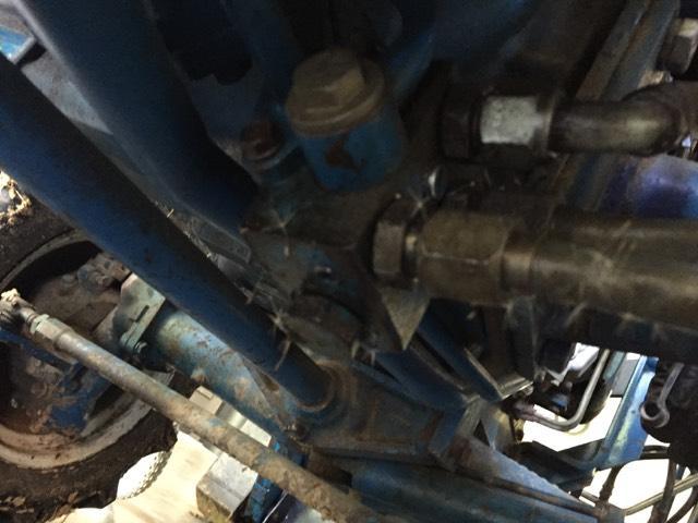

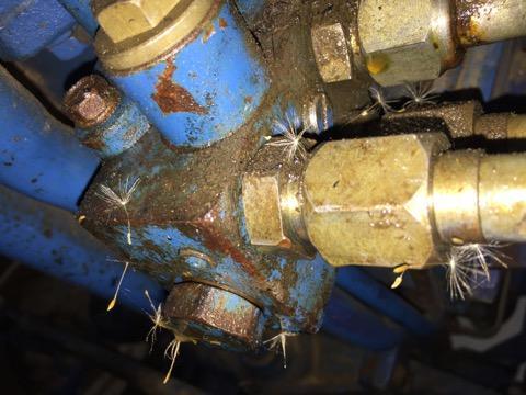

I'll try. Been a long time since I posted any pics. I doubt it will help you because the valve is hidden under a cover that needs to be removed.
/ Relief valve adjustment #10
Trying the pictures

Can't tell much from the pics he sent. I'm assuming the 7th hose if it has one is for power beyond? This guy was no help at all I couldn't even get him to take the cover off and tell me how many lines were attached to the valve. The loader used to work, it just quit. He replace the hydraulic pump before he called me.
Dave M7040
Thanks for info. I was not aware I needed hydraulic specific fittings. I'll look into replacing them.

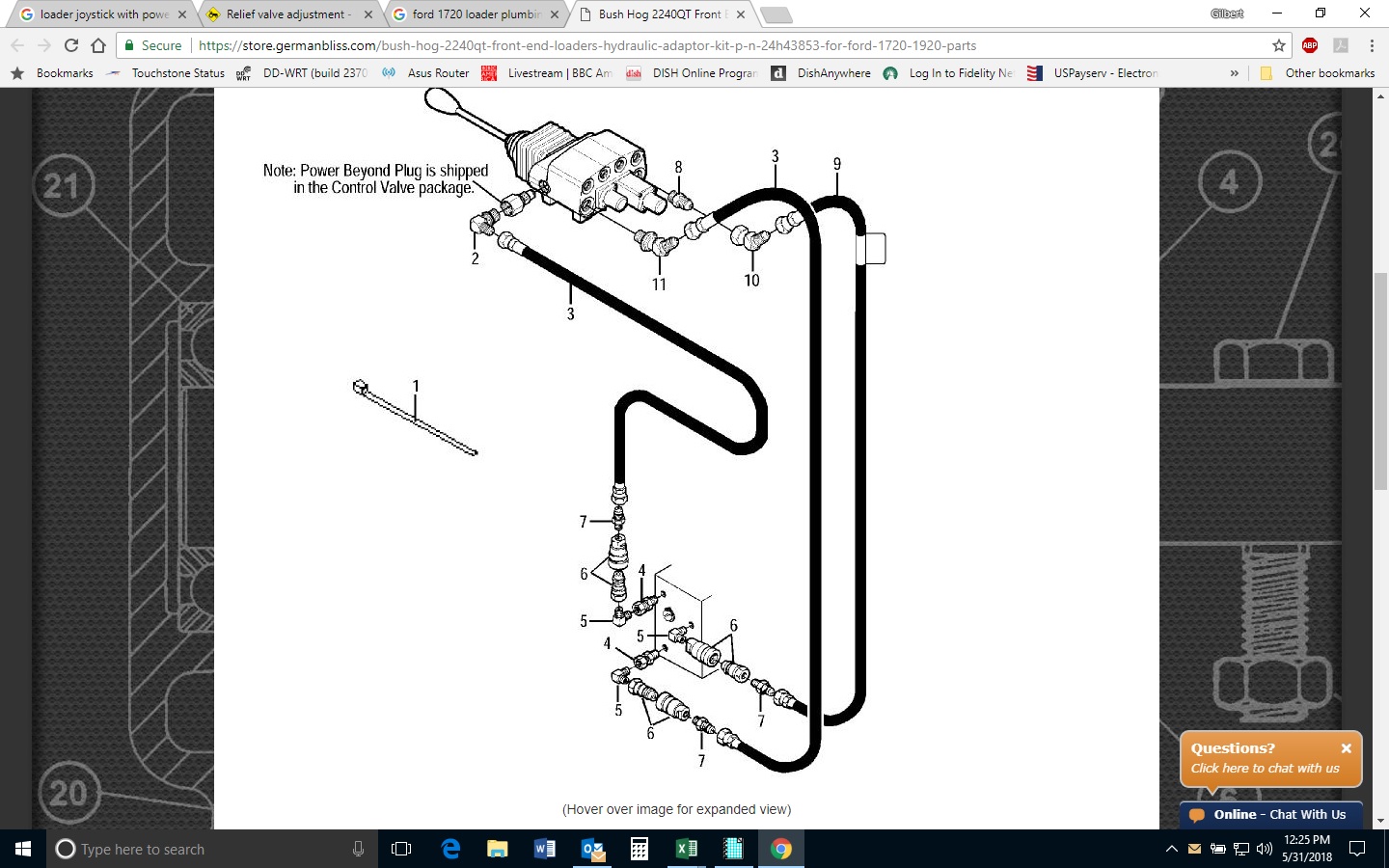

I found a diagram online of the block on the tractor. It is using power beyond to feed back to a port on the block. I'm assuming the block is plumbed internally to do this. Since the TPH is receiving power from the loader valve and it has plenty of power I'm thinking this guys best option is replace the old valve with a new one. He just needs a 2 spool valve with power beyond capability? This diagram, although not his valve, has a picture of the block under the floorboard. I checked all the hoses twice. Everything is where it should be.
