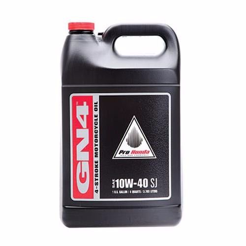

There is a system for it, easy to learn. The manual will specify a temperature range so you can choose the weight (10W-40 etc), and an API service rating, such as "SJ". The code "SJ" is kind of like numerical. Where SJ 'exceeds' SG for example (J being 'bigger' than G). So if the manual specifies SG, then you need SG, but can use higher rated oils such as SJ, SN too. If manual specifies SJ, then you can use SJ or SN (not SG). Oils rated "SJ" or higher are common, easy to find at any auto parts store. I bet your manual specifies SG. Think of G like "Garden Variety" where almost ANY clean oil is a blessing to your Honda.
Below is an example of an "SJ" rated oil. It says, 10W40 SJ
442777d1443971934-regular-auto-oil-atv-_12-jpg
Your Honda is built like a tank. Change the oil per the owners manual and there will NEVER be an oil related failure, no averted crises, no headaches no wallet-aches. Your Hondas biggest danger is NOT the oil formulation, the MAIN danger is that you "might not change the oil for YEARS".
