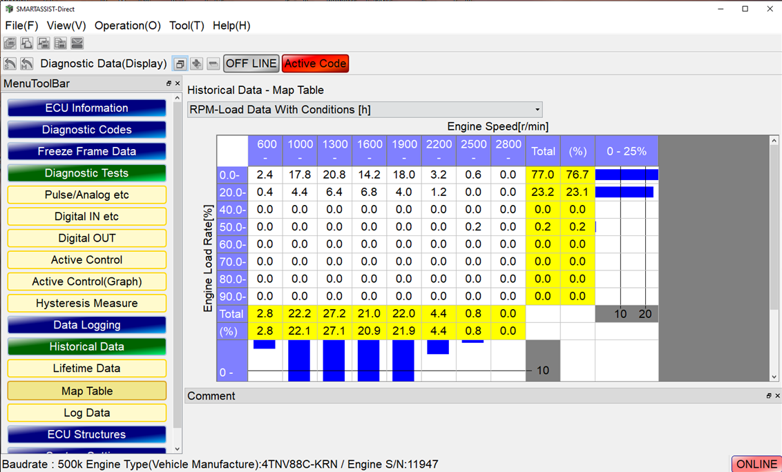

#42
David, To me it sounds like you are not running the engine hard enough, in todays emmissions you need to run above 2500 to keep the soot filters clean. Techs at most shops will tell you they are designed to run higher RPM`s, most Techs say run it like you stole it!
the issue is the YT is not reporting data back accurately. They say the average rpms is 1550 and I know I always run it 2200 rpm or higher.
Since I got it back from the dealer 7/3, I've been running it at 2200 rpm or more and it still did a regen after 13.5 hours.
Like you said, Yanmar just recommended I run it at 2500 rpm and see what happens.

backhoe trench digging and grading a quite a bit of dirt with a box blade and bucket.

Ran my YT347 at 2500 rpm and above as Yanmar suggested. It regenerated again at 12.5 hours. I will be calling Yanmar tomorrow.

Andy, Thanks for the suggestions. Sounds like I’m operating my tractor about the same as yours. I’ve gone through all that, running at a constant 2400 rpm while using the backhoe, at the suggestion of Yanmar. Im always running it above 2200 rpm. The last 3 times it Regend was after 6 hours. Yanmar sent me a data logger to monitor the tractor and sent it back after 3 Regens , but the data wasn’t good. I have 320 hours on it and lost track of the number of regens.
Yanmar is sending out one of their engineers next Thursday to look at the tractor and take fluid samples.

Idling will cause more frequent regens. Also, when the regen light comes on and blinks every 2 seconds you should press it until it starts and continue working. If it is blinking every second with a yellow lamp and diagnostic trouble code of 00 00E87.16, you should do a stationary or parked regeneration. This is done when the tractor is at operating temperature, park brake set, range select in neutral and pedals released. Then press and hold the initiate regen button until it starts. It should last 30-45 minutes depending on how much soot is built up.
