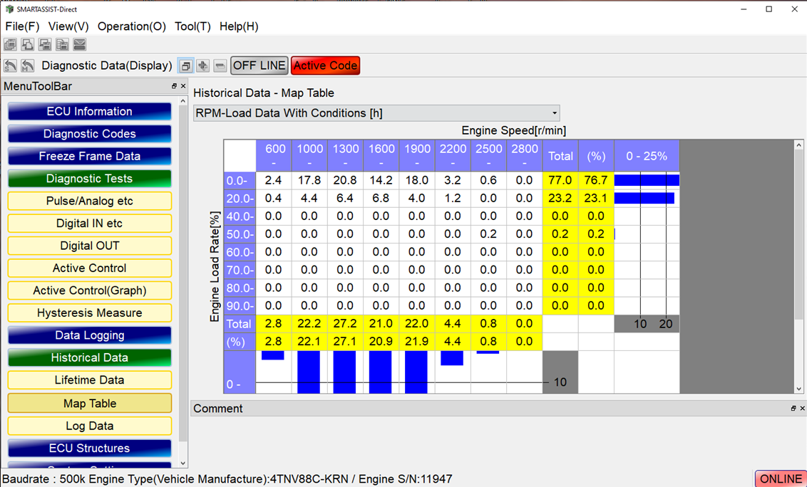

Talked with the dealer and he said he had to pickup the tractor so he could hook it up to a laptop and send Yanmar the data. Yanmar determined that I was running the tractor at an average of 1300 rpm and the re-gens are normal. There is no way this could be true, since I always run it at 2200 RPM or more after warm up. This was recommend by the dealer when I first bought the tractor. The dealer said Yanmar was ready to throw parts into the tractor which tells me there's an issue.
$200 out of my pocket for pickup and delivery.

Ok just taking a look at this post I own a tier 4 Yanmar tractor and the only time there is an issue with regen is when my wife drives it. I was doing the math based on your attachment and it says 95.4 percent of the time it runs under 1900 and looking further 73.2 percent of the time is 1600 and below so by that information directly from your ECU I see no problem.
Well I believe the ECU is wrong based on how i drive the tractor. My wife also drives our tractor and she's a stickler about keeping the RPMs above 2200.

Sir I beg to differ with you the Tach may be wrong, if I understand the system correctly the dealer can put computer on it and look at the Crank Sensor to determine if the Tach is off. The tach gets its signal from the Crank Sensor and if the Crank Sensor is off tractor will not run correctly if it will run at all. Sorry just trying to help you

Well TRACTOR RED if you had payed attention to this thread you would see that they did receive a screen shot (it was in his original post) and it looks like everything was correct accept for RPMs if you do the math 74 percent of the time tractor ran under 1900 only 4 percent above 2200 which from what someone said its a possibility of an incorrect tach. You would think that Yanmar would have looked at all sensors and there readings and if anything was out of spec and if there where no associated codes then the would have a hard time diagnosing the issue, and when it comes to contacting anyone if it was my tractor the dealer would be first then some sort of technical assistance from the factory definitely not a SALESMAN.
/ ReGen YT #36
A few things, One screen shot not additional ones so we don't know all the info, so we have to assume somethings, Depending on what was sent to Yanmar, they would have seen specific settings , sensors, rpm, all the regen info, etc, there is a lot if info to ck over. With the tach, the dealer can see the rpm on the tool to compare to machine. We assume there was no issue? Also what did the dash say concerning regen ? What I meant by having the owner contact the Yanmar sales manager ( not sales manager ) is that he will push the service dept to find out why this dealer/customer has been having this issue and dealer can not solve it.
