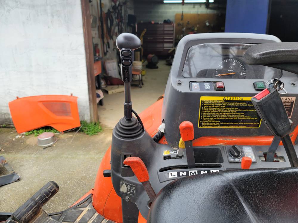

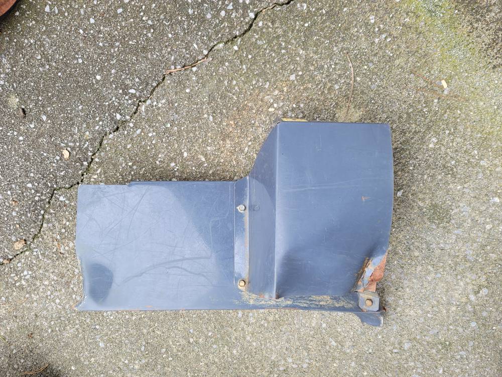

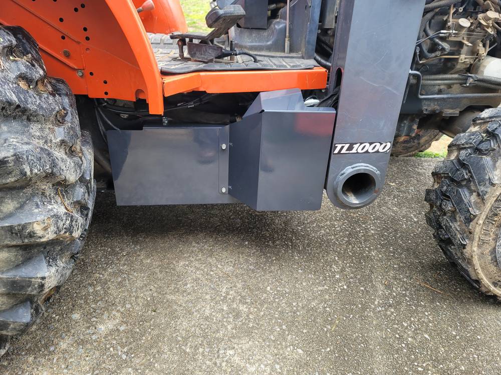

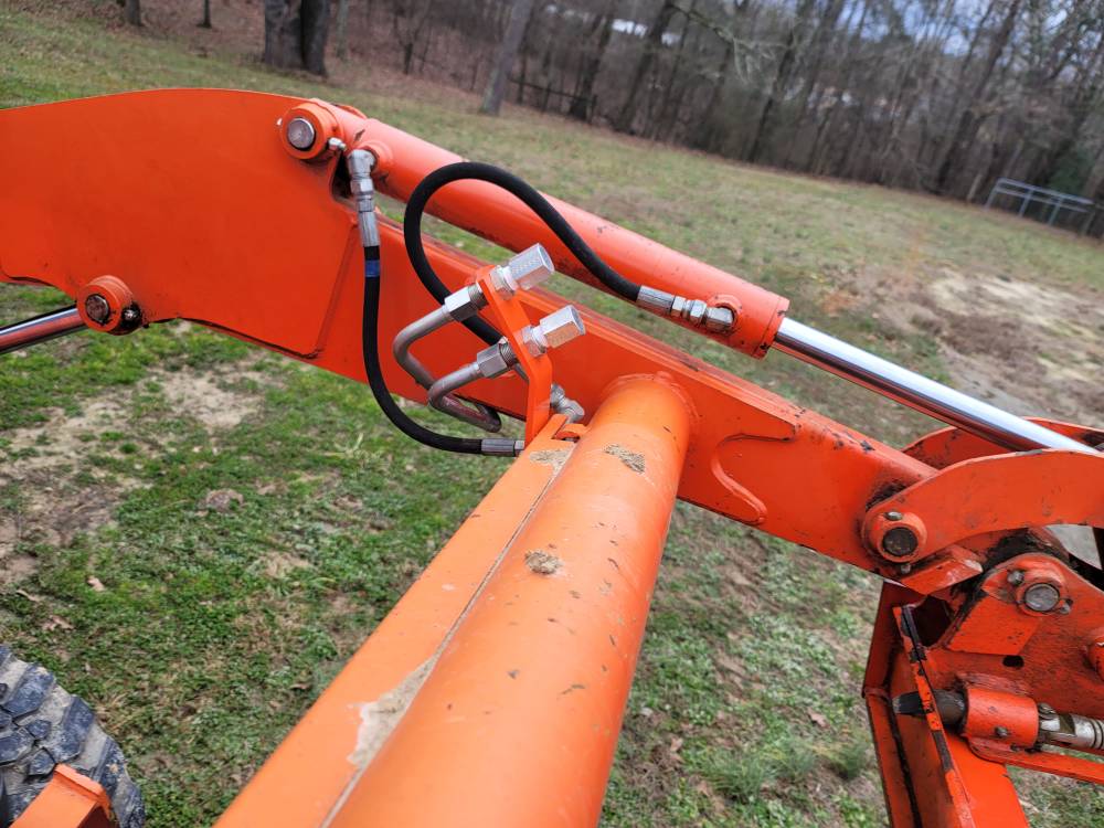

Gave the Bota a little love. The loader valve cover was beat up pretty good and the cover for the filters was missing. Also, for Christmas got a 3rd function kit. I'm not impressed with the handle, seems kind of cheap but I'm sure I'll get used to it. 20210127_143858.jpg20210127_143850.jpg20210127_143920.jpg20210127_143930.jpg

The factory/dealer installed controls for the 3rd function used poor-quality wire, I ended up replacing that with 18 awg. and never had another problem.

Gave the Bota a little love. The loader valve cover was beat up pretty good and the cover for the filters was missing. Also, for Christmas got a 3rd function kit. I'm not impressed with the handle, seems kind of cheap but I'm sure I'll get used to it.View attachment 684571View attachment 684572View attachment 684573View attachment 684574
I have the Kubota 3rd function on mine and while using it last year the valve messed up and being me I took it to the work bench and took it apart. I noticed the small spool piece was not centered like I thought it should be so I cleaned and reassembled the spool piece looked right, so back on the tractor it went and I have not had a problem since. I have the hydraulic thumb on my B26 I wish I had one on the L45 that maybe a future upgrade.

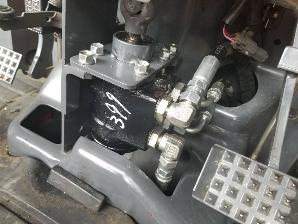

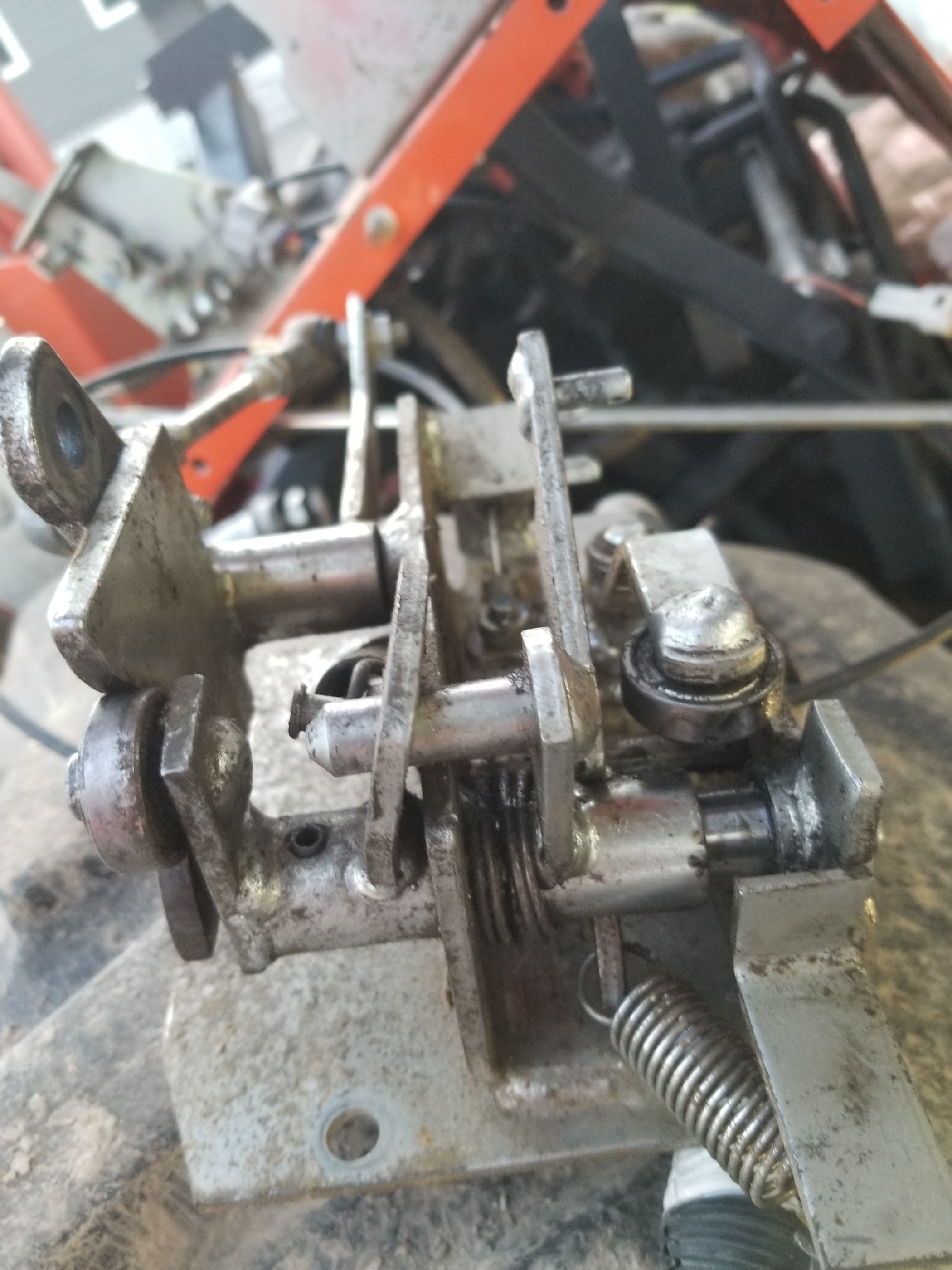

Picked up an L45 a couple weeks ago, two days before our 20th anniversary cruise, just now getting to servicing it and correcting a few issues. The tractor has 850 hours and runs and operates as it should except for the Auto Throttle Advance. There are no leaks but the fenders, hood and grill have seen better days. I got a great deal on the tractor so I don't mind dealing with correcting cosmetic issues.
Serviced the tractor; Kubota Filters (oil, hydrostatic, hydraulic, air inner & outer), Rotella T6 oil, and SUDT

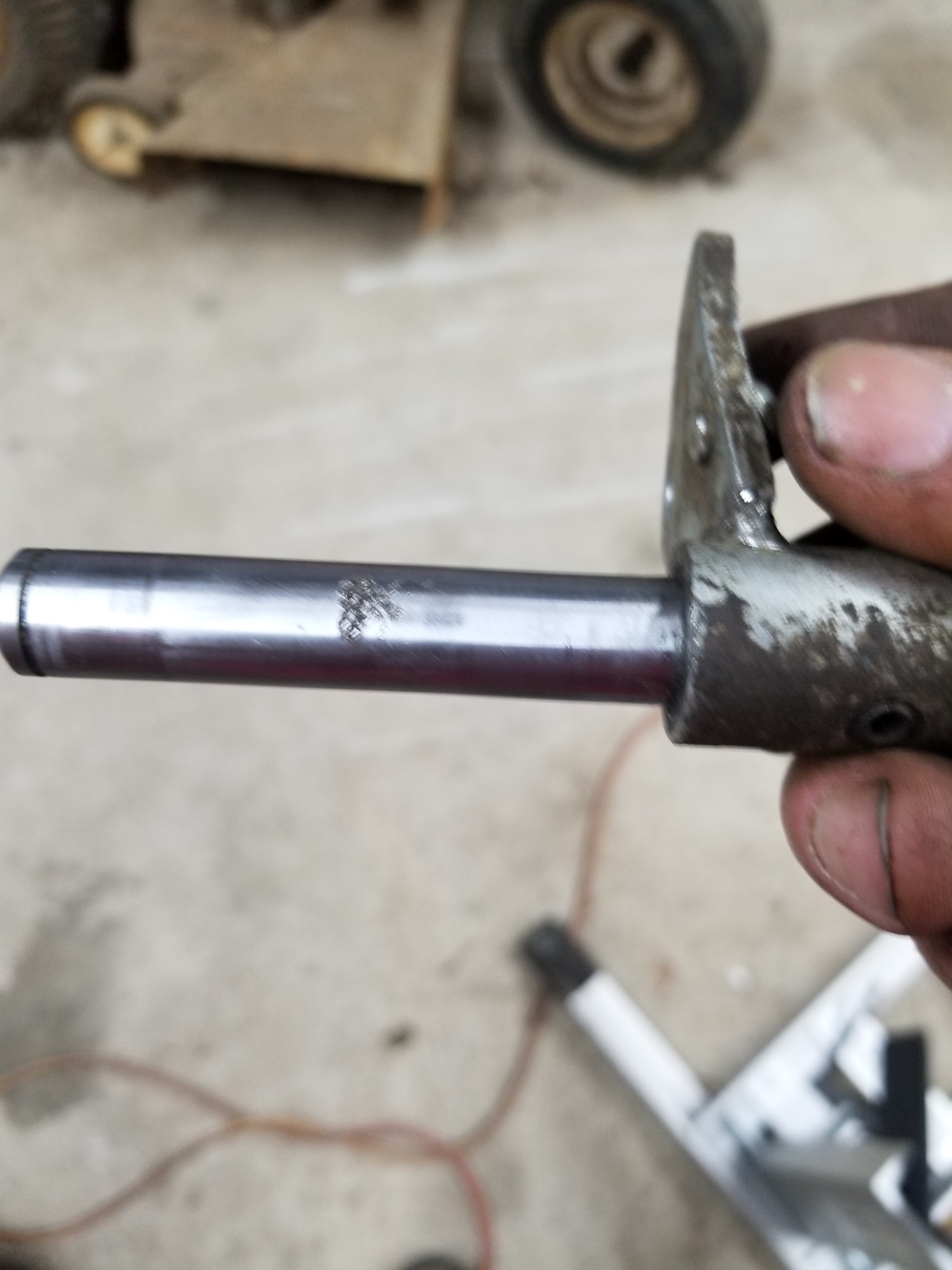

Now working on the Auto Throttle Advance. The tractor is a 1 owner tractor and the owner stated the linked throttle has never worked. He returned it to the dealer on a couple of occasions but he stated they could never get it working correctly. Pulled the controller out from under the floor board and found the cable that runs to the injector pump disconnected and the arm in the mechanism would not disengage. The accelerator lever would not slide on the pin so disassembled. You can see there is some gouges on the pin and the ear on the arm holder is bent. Looks like the ear has been hit with a punch at some point in time.
Got everything straightened out and now the linked throttle works

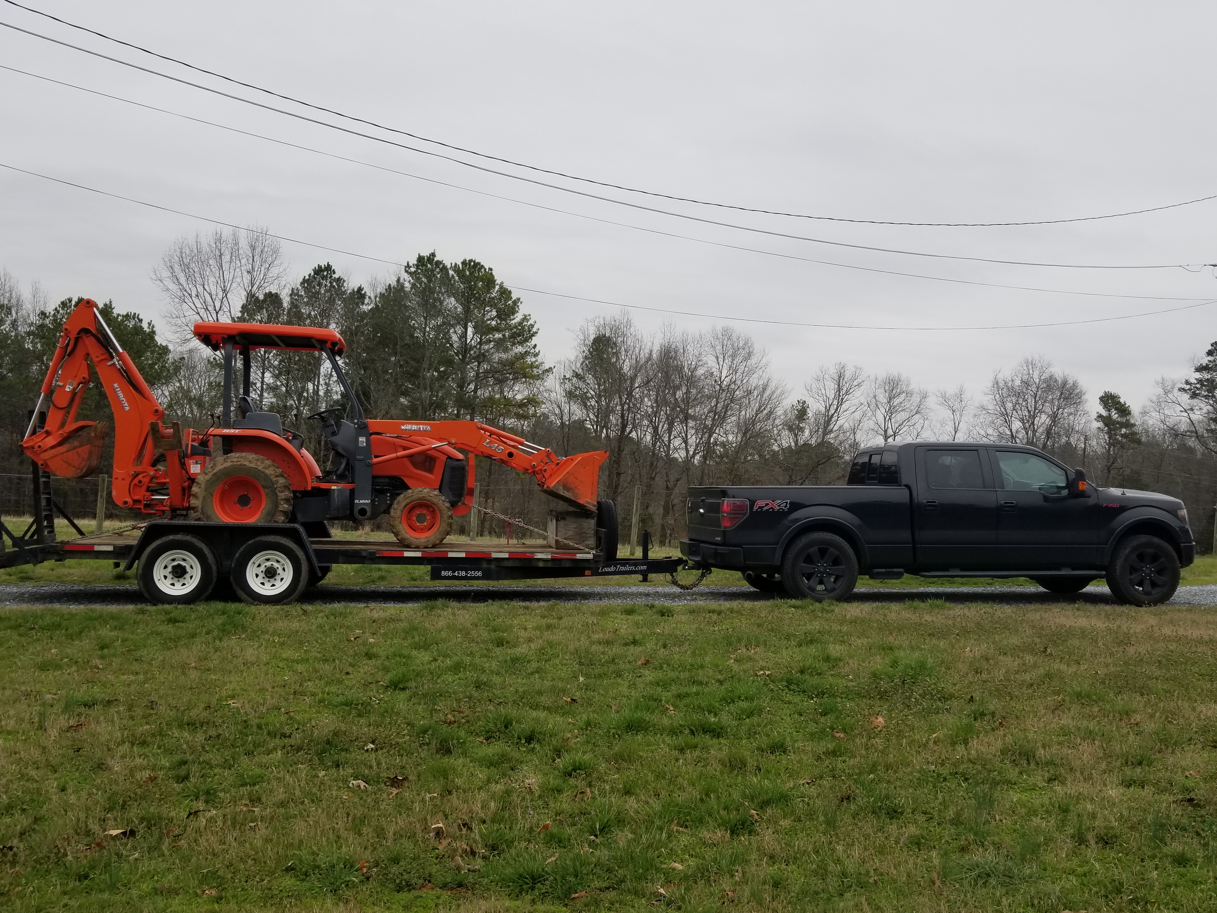

I towed the L45 home from northern TN, about a 3.5 hour trip which included the interstate and Mount Eagle. The Ecoboost could actually pick up speed going up the mountain and handled the weight just fine going down.
