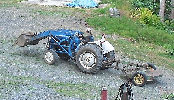

Here is a shot of my new project. It came with an old JD 127 mower deck, a 3ph road grader blade, and a 3ph log boom, all serviceable. I paid $2500 for the lot, which is about as good as I have found in this area. I didn't have to pay for trucking something else from farther away.
I will be going over this tractor in the winter months, ready to make use of it next year. I am not sure how many hours it has, as the tach is not working. But the engine seems strong, good oil pressure, not overheating, no smoke in the exhaust, instant start. There seemed to be some level of care taken to keep it running, but only the minimum. Today I used it to move some gravel around on the driveway, and the loader seems to be strong enough. Mainly it just needs some small repairs, TLC, cleaning and painting. I prefer a clean machine.

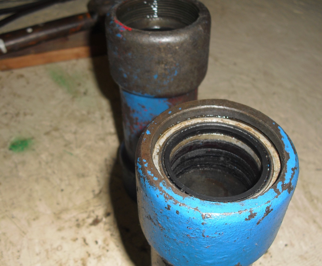

Here is a photo of the seals from the Superior lift cylinder ends, mentioned in the above posts. I have taken the snap ring out. There is one rubber type oil seal, and a stack of 4 fiber (?) washers below it. Does anyone have a good technique to remove that oil seal? No access from the other side to force them out. It looks like some sort of destructive process is needed, but I don't want to ding things up if possible.
/ Refurbishing a Ford 850 #6
You will need to destroy the old seal, but with care, it should be readily removable.

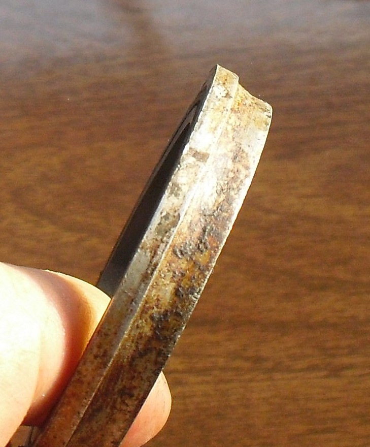

Have not found the oil wiper part yet, as it is unusual with a beveled edge and a lip.
yup.. hooked seal snatcher usually does it.

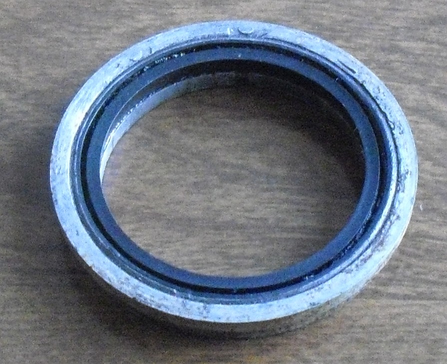

Not being familiar with oil seals, I am not coming across anything in my searches that has this particular shape. Maybe someone more experienced has some cross reference ideas. No numbers or any marks on the seal. Shaft is 1.75", Lip O.D. is 2.375", tapers to 2.25", height is just shy of .375" (no calipers).
/ Refurbishing a Ford 850 #11
might have to visit a mom n pop hyds shop for a matchup.

As for the last remaining part, the oil seal/rod wiper on the lifter cylinders is 1.75 X 2.125 X .0187 inches. Such as
Sealsourceinc
These cylinders use aluminum holders that this part fits into (which I showed in my previous post), but one side was fractured and the other a bit rough, so I had the shop make two new ones, and all is good to go.

These are SA for the loader arms, and DA for the bucket curl. No place for a strainer that I can see on this one. Now just left with converting to 12V, and I can test things out a bit.
Thanks for all the help!
As can be seen, I did not stick to tradition with the paint job, just wanted to use up left overs.
