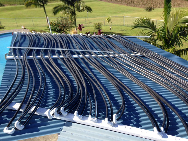

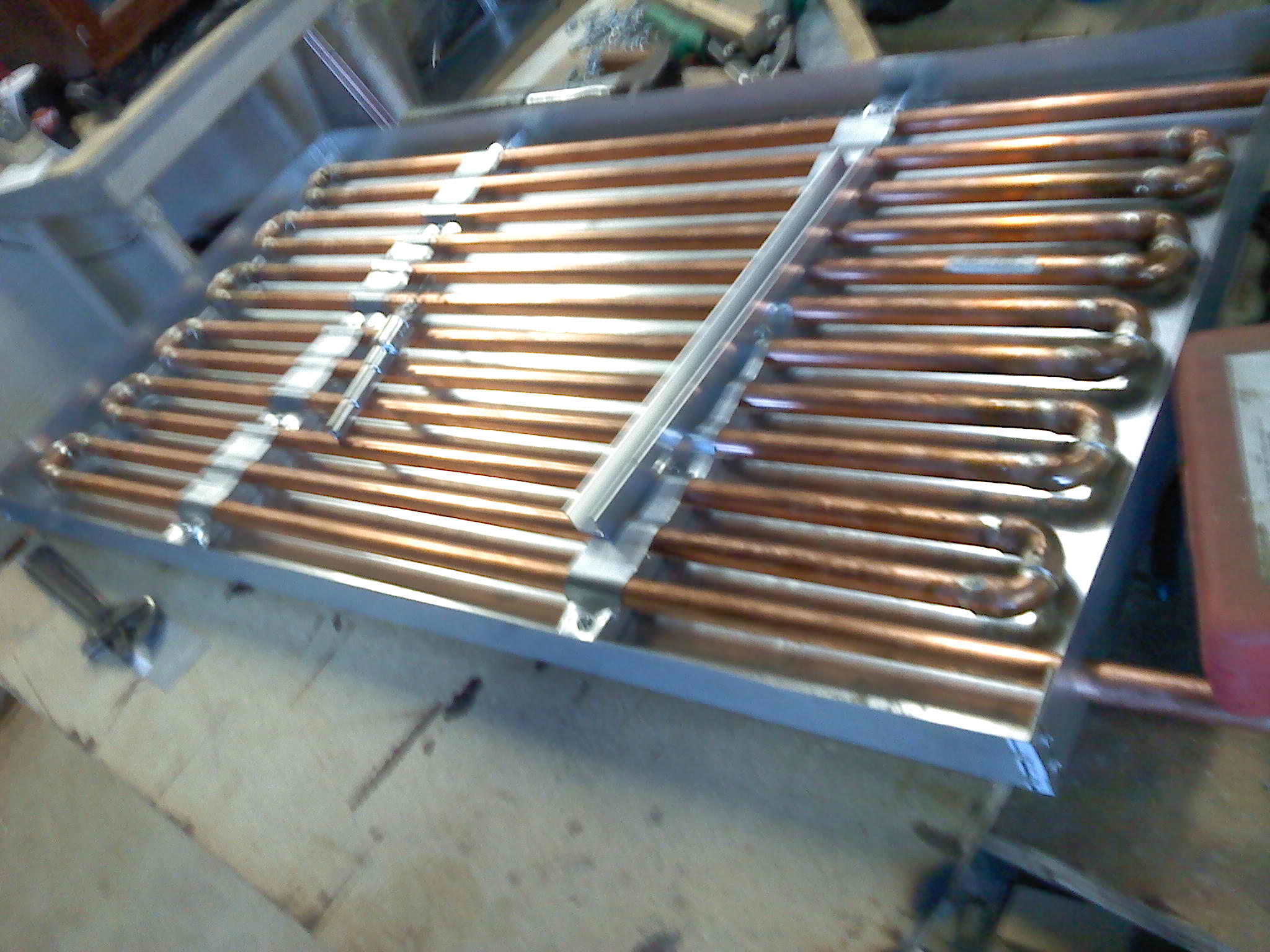

Not pretty, but got a start on mine. This will be a solar loop. Also started a new thread.

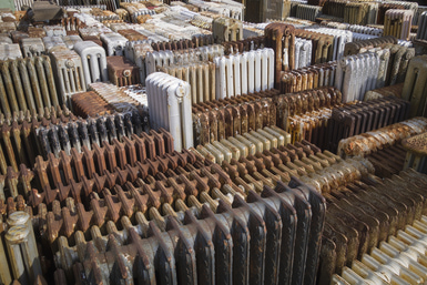

I did a similar pool heater for a similar pool. Instead of coiled copper pipe (for the exchanger) I used a cast iron steam radiator that I bought at a local recycled building materials store for $25.
I chose one that fits within the size of a 55gal drum, but haven't built that part of the project. I set it over a campfire for a first test and it worked great. Had to stoke the fire all day, packing the wood UNDER the radiator which was laid across the fire like a cooking grille. It was a lot of work, but it proved the concept. I'm certain it will work better in a drum but doubt its as efficient as copper pipe. I filled the pool with gravity-fed creek water, running all the fill water thru the heater.
Haven't yet acquired a 55gal drum to continue the project. Kids may outgrow the pool if I don't hurry up… but the plan is to use it for an in-ground hot tub someday.
My plan for the drum burner was to have 3 vertical stacks, where two are capped, and full of firewood that self-feeds.
