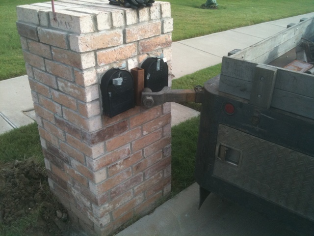

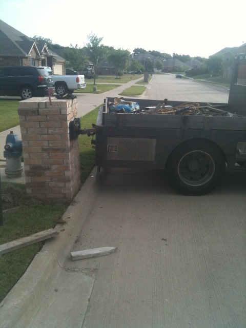

The other day young son called and asked if I knew someone who could straighten up their brick mail box because the HOA was having fits about it leaning. He had a couple of quotes, three to four hundred dollars.
I told him I would look at it.
As most of you know I have hitch receivers built into the corners of my truck bed for vises and benders. The brick column was leaning over and out. So I put a two and five sixteenths hitch insert caddywampus into the passenger side tool holder/hitch receiver thingy doo. And then I backed up, first to straighten it out in line, and then I blocked the road and pushed it back the other way.
We put some sacrete in the cavity we had made with the move. It was plumb all ways when we got done.
I'm in the wrong business.

neat! If it works, then don't knock it!! :thumbsup:
/ Redneck mailbox repair #3
It's always good to find the easy way, and it works!! :)

Nice job!

Good job on the fix!!! Is that a fire hydrant that close to the mailbox??? I don't think I could ever live where there a HOA... I guess I got this silly notion that it's actually my land. :confused2:

Yea, its funny that the HOA was concerned that the mailbox had settled and was leaning, but are OK with it impeding access and visibility to the fire hydrant.

thats a fire chief call not an HOA call.... and would likely result in having to move the mail box.

The masons around here take advantage if you could call it that of the assumption by everyone that the brick mailbox has to be completely redone for a straightening. They don't most of the time. The way they're made is the mason levels the dirt and then lays down a mortar bed or a concrete cookie and then builds the mailbox. They just stand on top of the dirt.
Dirt is a misnomer around here. What we have is clay, seven kinds of it. We're in our dry season now but it isn't as bad as it usually is because we've had some rain in early July from the tropical storms. Usually by now you can stick a tape into the cracks in the ground a three to four feet. Now we're at two to three feet. I've seen them seven to eight feet deep. If one side of the mailbox is drier normally than the other then the ground will shrink in that area this time of year and the lean will start. When it gets wet the expansion will start and the wetter part will expand faster increasing the lean.
A friend of mine lives on a little elevation, we don't have hills, just elevation changes. His elevation where his home is located will change elevation six inches season to season based solely upon the expansion and contraction of the clays.
Most of the cities have some pretty serious standards for foundation or pier construction for columns. Mailboxes are exempt, mostly because they're on the street and there's always a lot of subsoil congestion with all the buried utilities. But also because of the safety concerns about vehicles and anything along the right of way not being a hazard. They look substantial but since they're made with mortar basically they crumble very easily, a bump will destroy them.
The fire hydrant has plenty of clearance. It's an optical illusion to think it doesn't have it. We have one of the top fire departments in the state and they on top of everything. We like it that way as homeowners, helps with the fire insurance premiums.

Good job. How much practice did it take to get perfectly between the mail boxes
