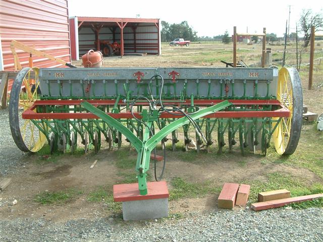

Here's an example. I restored an old Minneapolis Moline P3-6 grain drill last year.

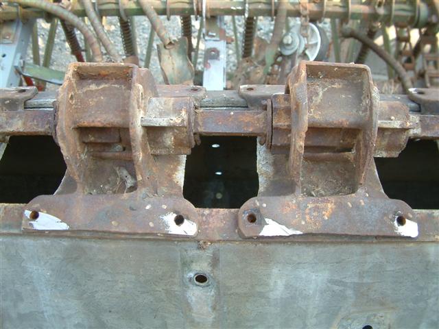

The feed cups were rusted pretty badly.

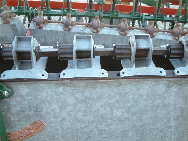

I used Gempler's RC on the cup housings and the fluted feed cylinders. The black coating on the flutes is Gempler's. I sprayed the housings with cold galvanize spray paint to prevent more rusting.
I used that restored grain drill last month to plant 5 acres of Kanota oats. The drill worked fine.
