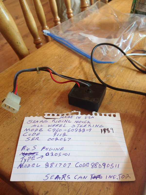

Rectifier for a 1989 Sears riding mower.

OK, so if I hook up the two yellow wires and read the red one, it should show 12 volts or so of DC current? And it doesn't matter which yellow wire goes to which of the two wires coming out of the flywheel? If so, then the red wire on the new part hooks up to a wire somehow connected to both the red "discharge" warning light on the dash and of course the battery (in order to charge it). (Or maybe the red discharge warning light is on an independent circuit?)

Yup, hook up the yellows [ either way ] then you should read a positive voltage on the red when she is running. The voltage could be anywhere between 12-16 volts or so not hooked up to the battery. Plus, it's not really solid DC, it is pulsed, but should be pulsing fast enough that most meters will read fairly correctly. Once you hook it up to the battery, the battery acts like a big capacitor and you probably would have to use an oscilloscope to see any fluctuation [ the actuall DC pulses ]. The new red wire should hook up to the same place the old rectifier output hooked to. You will have to trace it out.

OK, thanks a bunch. Will be going up to the cottage this Friday, and can check it out over the weekend.
Thanks again, everybody. This has been very helpful. Long live TBN!
Quick update - it works! Thanks so much again, guys. My friend is so happy, as he could not find the relevant part anywhere up North, and he doesn't use a computer, nor the internet. So now he says I can borrow the mower any time I want, and even store it over at my place - nice! (Another reason why I won't be getting a mmm for my Kubota BX25.):cool2::thumbsup:

As previously stated just about any old rectumfire and regulator can be used.
The voltage regulation does matter as some are just a zener diode and short over production to chassis, that style is not not recommended . A regulator that uses a solid state regulated supply and over current protection is recommended. Some systems combine the rectumfire and regulator into one unit.
