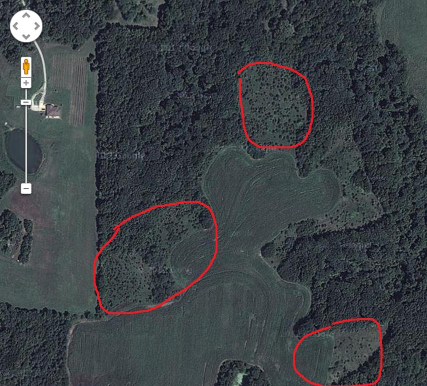

My wife and I are going to be closing on a 114 acre farm adjacent to our existing property soon that will continue to be cash rented for 3-5 years before we expand our vineyard and orcharding operation.
In the meantime, the renter has asked that we reclaim some of the land that used to be farmed from the 10-15 foot tall cedar trees and brush that has grown up in the past 10 years or so. Additionally, there are a couple places where the terraces have broken down somewhat and water is pooling and could use a little work.
I have always worked with tractors, and don't know much about dozing, but am a huge DIYer whenever possible. I am thinking of buying an old dozer, using it for the year, and reselling it.
1. What size dozer would be sufficient to accomplish this job?
2. Any makes/models you recommend?
3. What are the keys areas to look for when shopping for a used dozer?
Clearly an experienced operator would do a great job, but everybody's got to start somewhere, right? Circled are the areas that need a bit of work.

But a better idea might be to hire it done by someone with big hunk of iron to go through, piling up the trees and brush, and roughing in the terraces. Then use a wheeled tractor for the finish work. Would probably get you there cheaper and quicker (and be just about as much fun).

My 2 cents worth is fiqure out just what you want done and get bids on the "big" stuff [trees and dirt work,roughing in roads ,etc. Then you'll be able to handle the smaller stuff yourself with a smaller machine.

You might want to consider a track loader rather than a dozer. A track loader with a 4 in 1 bucket is a lot more versatile than just a dozer with a 6 way blade. A John Deere 655G would be an excellent machine to have. They are big enough to do a lot of work, yet not so big that they cost an arm and a leg to work on or move.

I am a huge fan of the 953 series loaders; however, due to their hydrostatic operation and larger undercarriage, they are not as cost effective to operate as a 450-650 size deere machine. I think for farm use, the smaller deere machines would work better. In a production construction environment, the 953 would win hands down. Either way regardless a track loader would work better than a dozer on a farm, especially with a 4 in 1.
