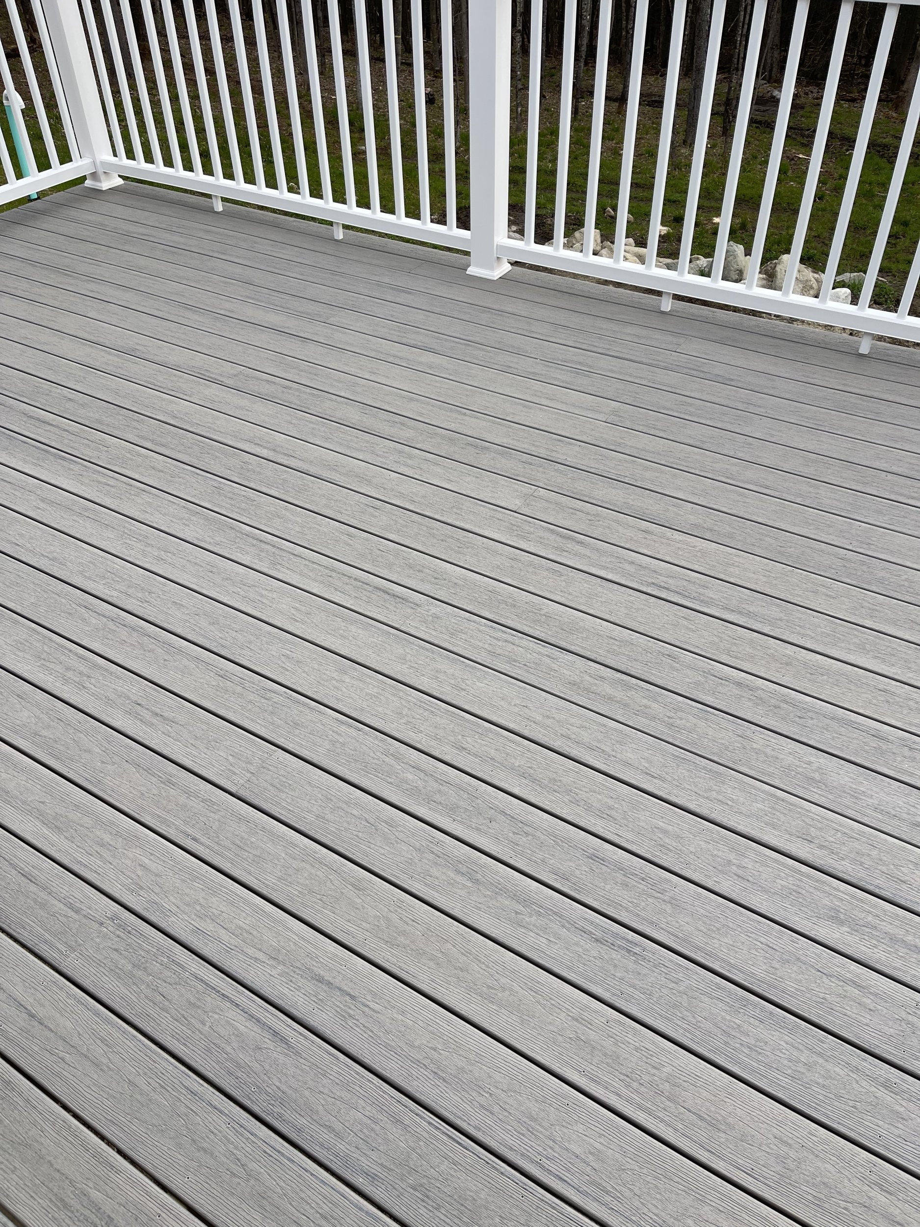

Ever thought of biting the bullet and going with composite decking?
I'm using Timbertech on mine.

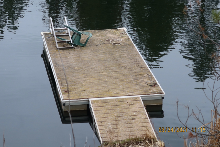

/ Recommendations for deck paint for porch #5
My small dock ( 10 x 16 ) has composite decking. It's 17 years old and I've never done anything to the decking. It's been on the lake for all 17 years and still looks as good as the day I bought it.
The only downside to composite - it gets HOT in the summer sun. Not a surface you will want to walk on bare footed. When we go down to the dock - we take a 5 gallon plastic bucket. Bucket water out of the lake and splash across the dock. This will cool it down and allow foot traffic for a while.
This is what it looks like after the winter. A normal spring project - scrub down the deck. All the local wildlife enjoy the little dock also.
The beavers, the geese & ducks and the magpies.

We used the same Behr deck and porch paint, and it was very tough. That said, if the deck hadn't already been painted, I would have preferred to use an oil stain, as it is easy to update, and does, I think, a better job of protecting the wood. I find that water can get under paint on a deck and then it accelerates rot. I prefer the breathability of oil stains. I dilute the first coat pretty heavily to improve penetration.
We replaced the rotting redwood deck with a composite deck. As @oosik mentioned, it gets quite hot under bare feet. I'm also not very impressed with the hidden fastener system which has cracked some of the tongue and groove edges loose/off underneath, allowing the decking to move, and to lift, in a few places. Timbertek.
That system looked over complicated to me, so I just went with their color matched screws.
/ Recommendations for deck paint for porch #18
(y)(y)
I have a feeling that I will be at that point soon on a few places on the deck. If I were doing it again, I would go that route, based on what I learned. Not the end of the world for me, as we have some stairs that are screwed down, and those seem to be holding up ok, other than a few screws that were a little bit proud, and now the a little bit of the screw coating has been abraded off.
All the best, Peter
/ Recommendations for deck paint for porch #19
(y)(y)
All the best, Peter
I used snap off screws when I put my Treks deck on. They were a little more work than regular screws, but I loved the result. I've had no issues with them and the deck is about 15years old now.
