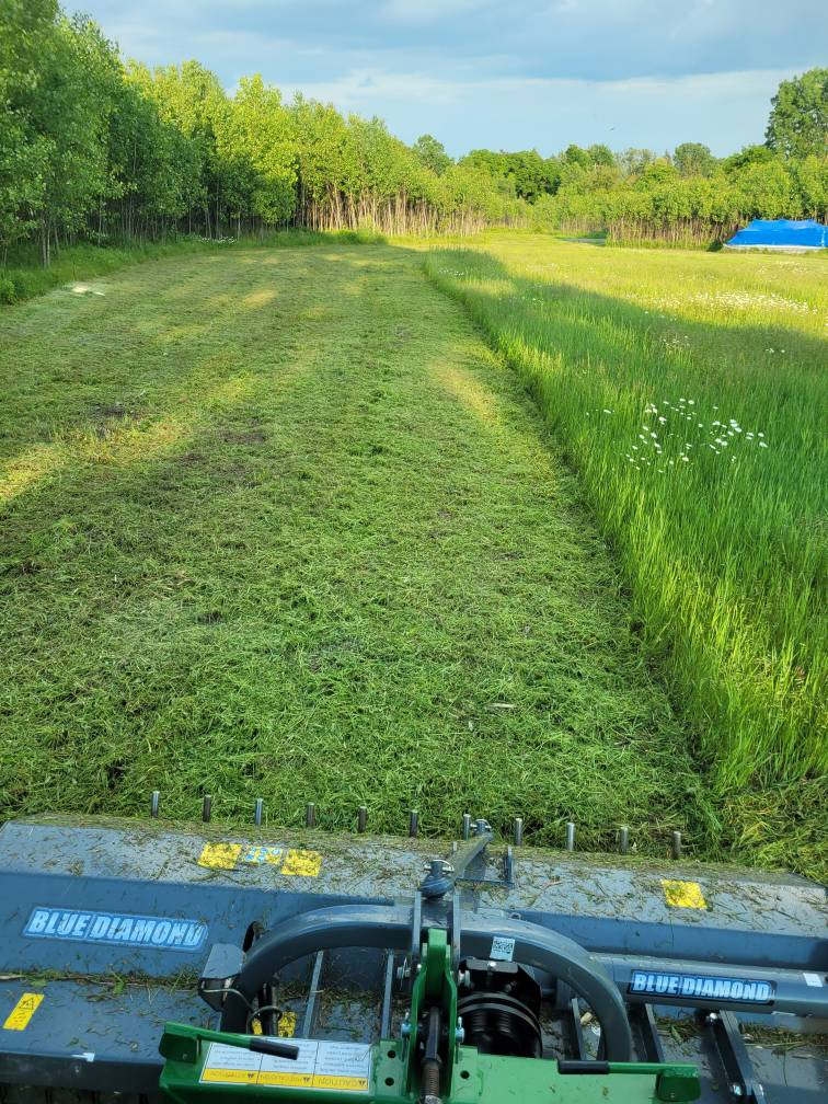

Apr 2, 2023 / Recommendation flail mower #5 XSKIER Platinum Member Joined Apr 28, 2011 Messages 558 Location Fenton, MI Tractor '11 Deere 1026R I have an 80" blue diamond hyd offset with forged hammers. 1" saplings are the practical limit for taking down and shredding. I would think that an HD rotary cutter would work better on 3" trunks.
