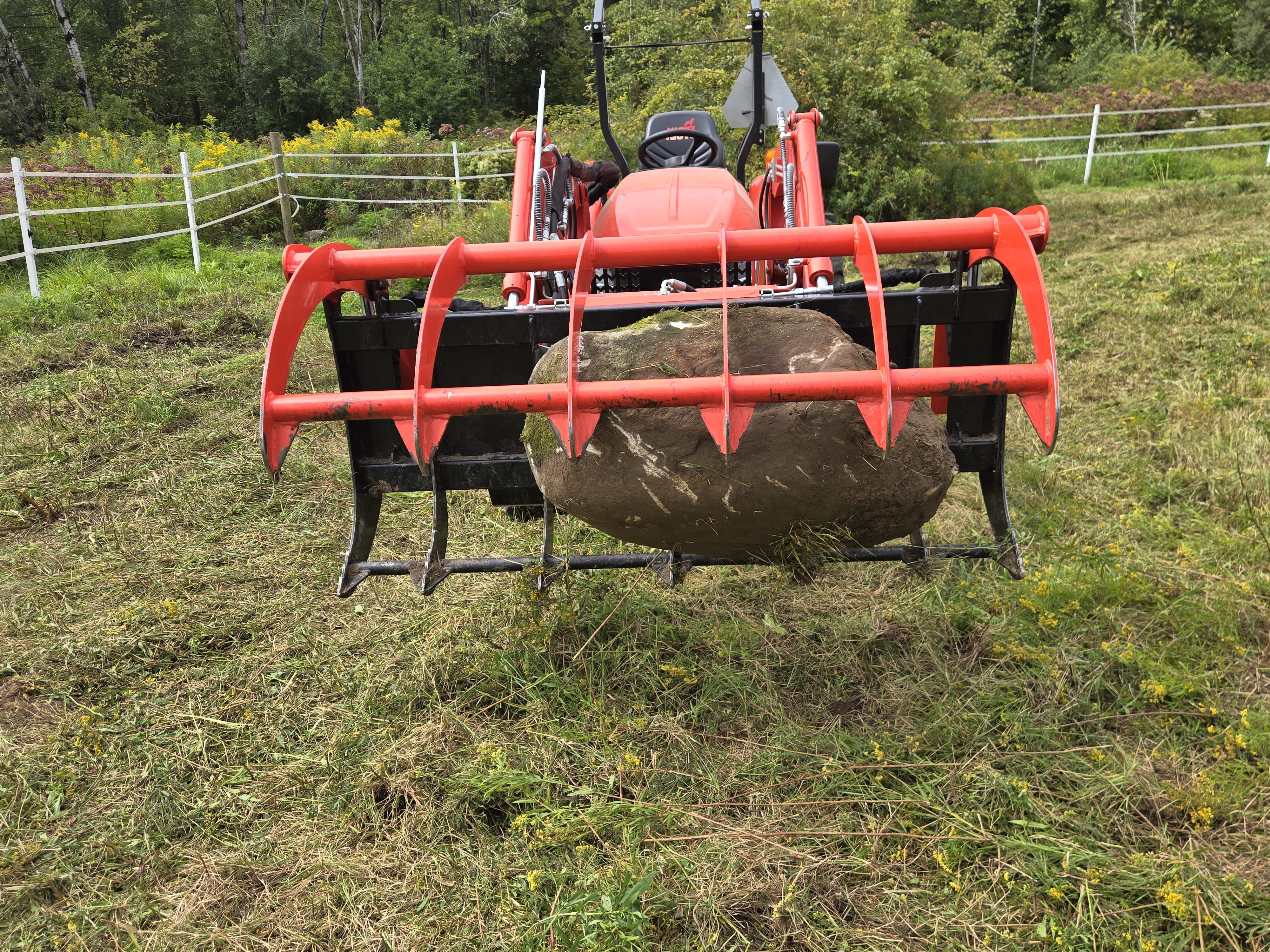

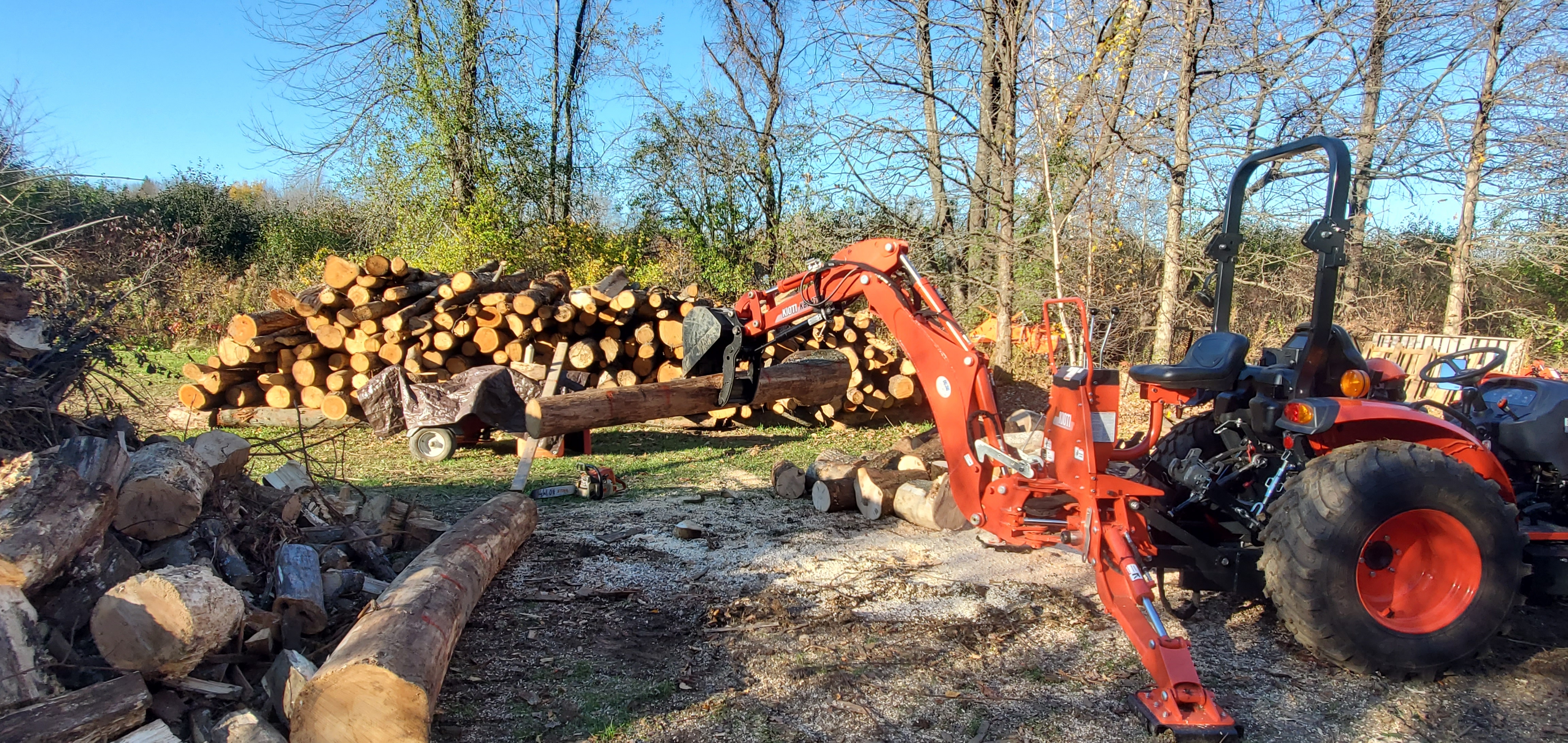

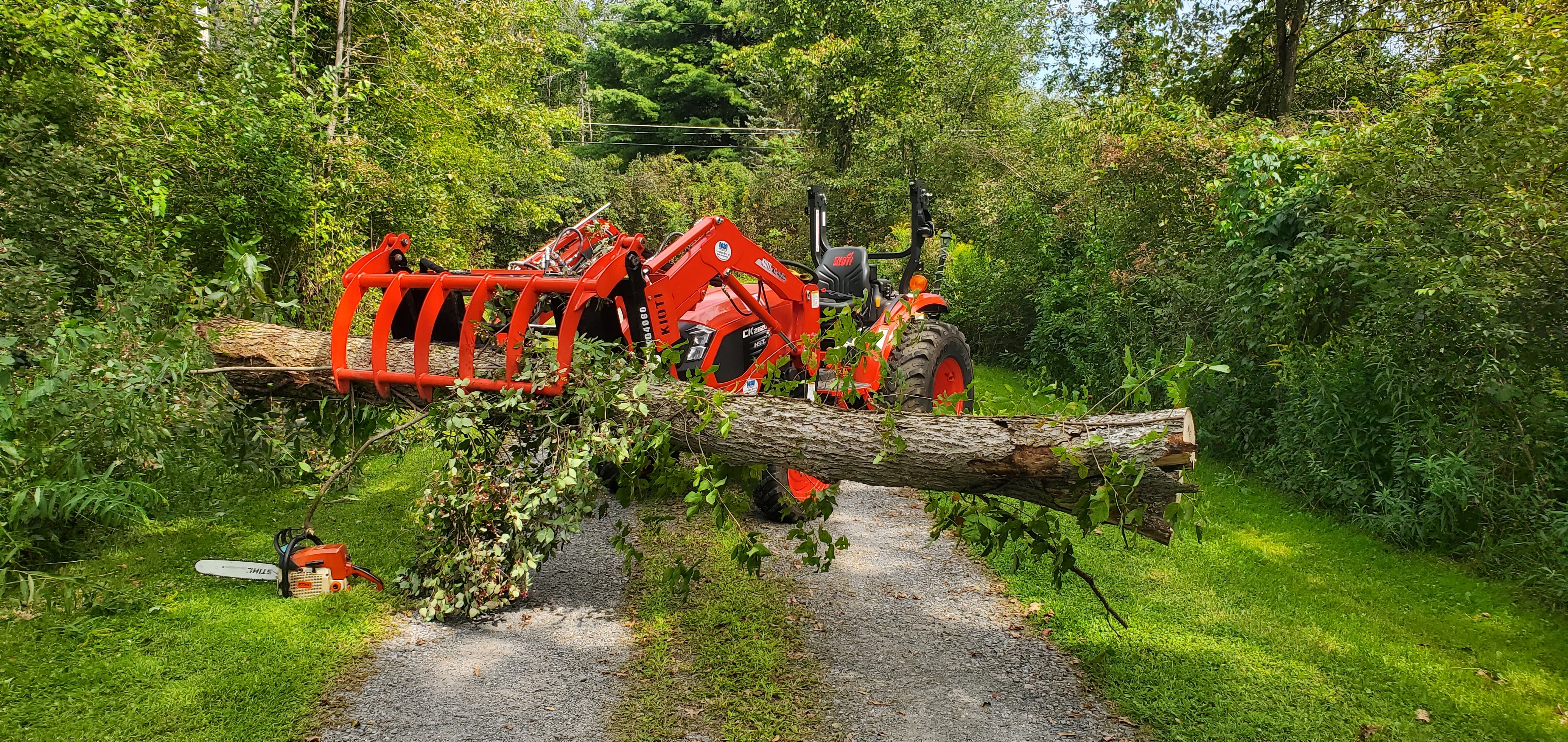

I hear you about spending a lot of money. I bought mine 2 years ago. Got the Grapple , rotary cutter , back hoe, land plane , wood chipper and a Woodland Mills trailer. Plus added the cruise control and linked pedal. Buying this I will sell the woods rotary cutter to recoup some cash toward it. I will get much more use out of a flail mower then I do the woods cutter. The cutter has very low hours on it.
The grapple is the most used attachment I have. I use it for everything, the tractor is a little tank when using it. I heat with wood so I use it moving logs around etc. The CK2620 is a little work horse forsure.
