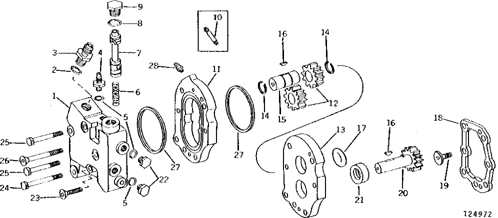

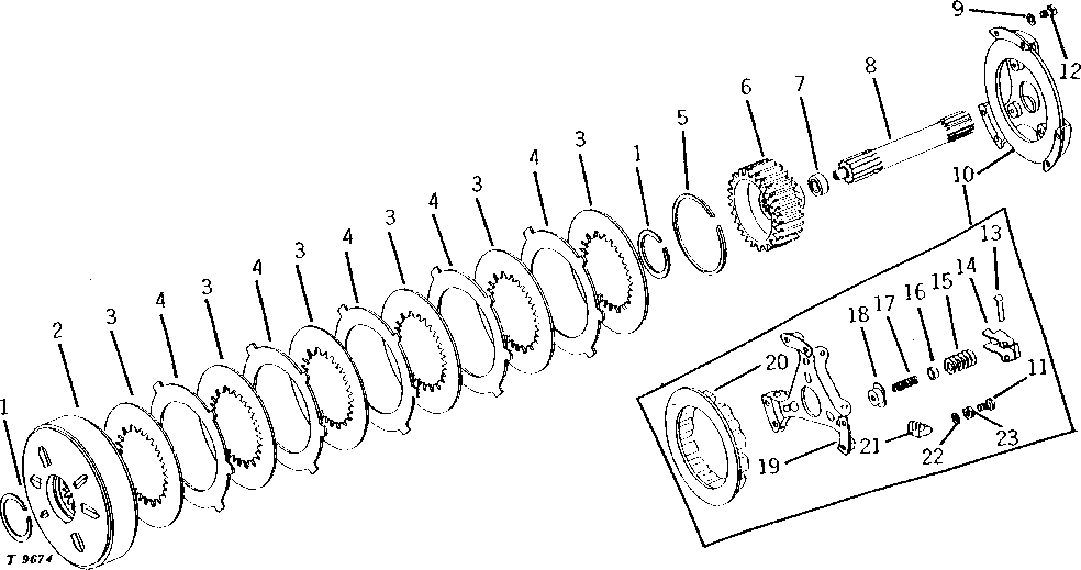

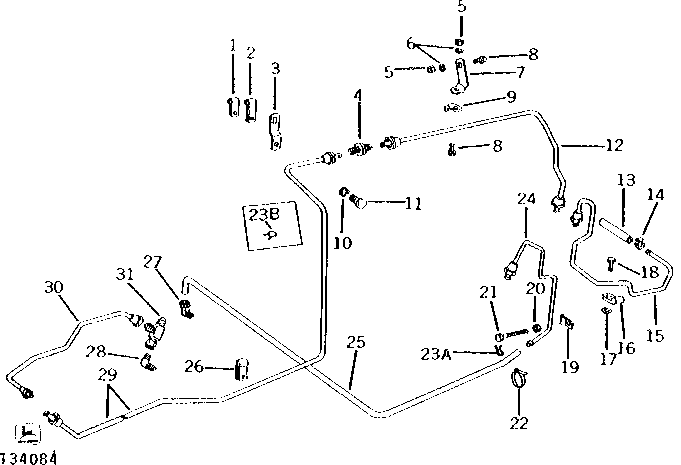

303 is outdated and replaced with Hy-Gard oil. If 350 crawler has dry steering clutches then why does it have a power steering pump & lines? Also that would be first time for me to see a multi-disk dry clutch but as I stated my ind experience is very limited.

their is hydraulic cylinders on the steering levers for power assist

The photo of the clutches I posted was for steering.
   / Recommeded hydraulic fluid for my 350 John deere dozer #10
This photo shows a stack of dry clutches with a common pressure plate. This is what is used in my JD350B. Wet clutches would have a piston against the clutch plates for pressure
