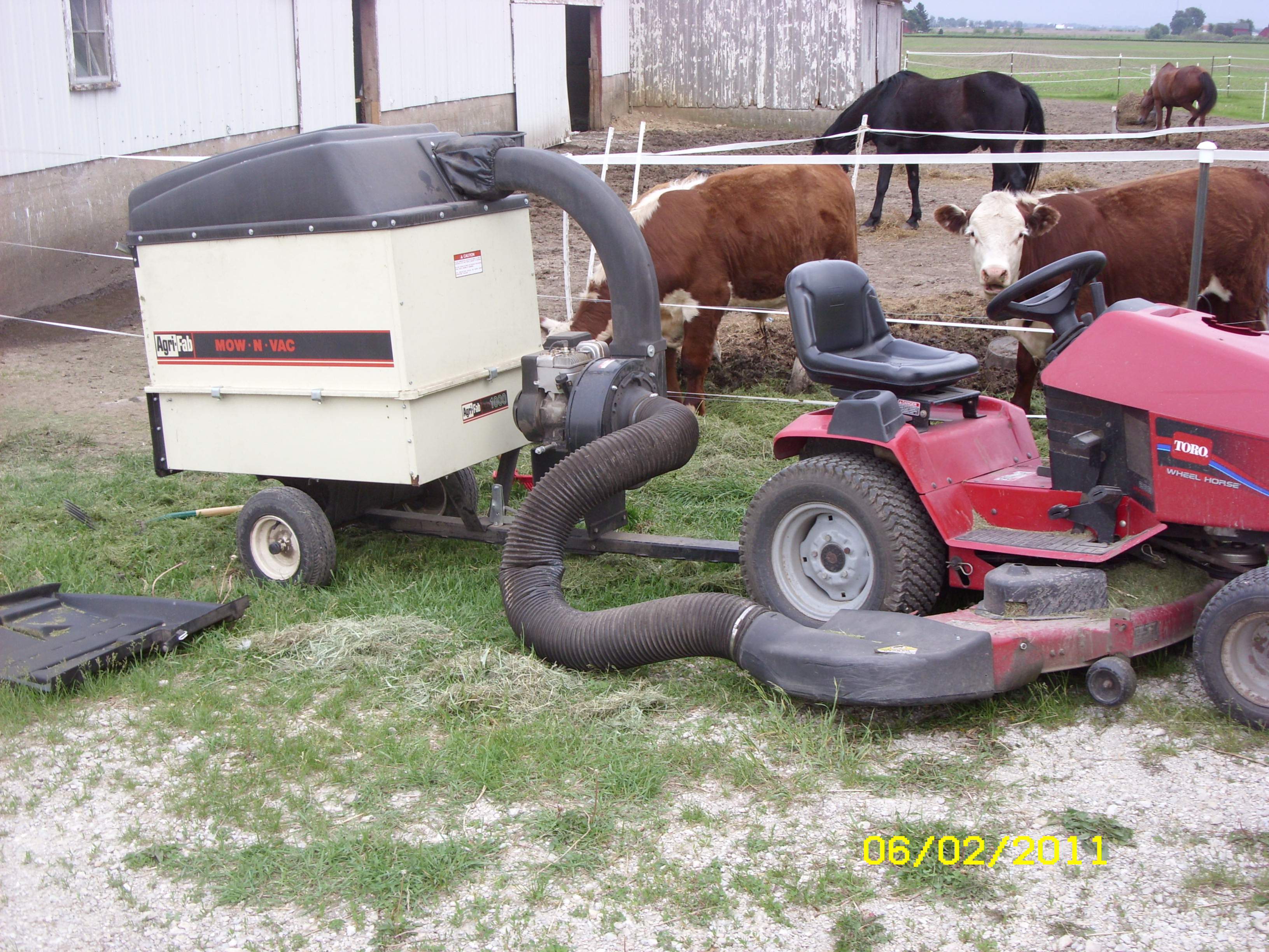

What about a bagging trailer for the big deere. I'm thinking a leaf vac. Would that work?
/ Recomendations for the best / solid garden tractor that will last ?
Thank you for you suggestion.
Thats what Im running, a leaf vac dumping trailer. I included a pic. My 790 JD has a 6' finish mower, with full rear discharge, which will not work with what I have now, Im trying not to "re-invent the wheel" Just need a better built garden tractor I also need some maneuverability, and the size garden tractor Im using now works perfect, its just does not hold up to the amount and kind of use Im giving it.
Also, when I get past 48" deck I have problems in the swails, ditches, and elevation changes, I know that because of the 6' decks I have, bigger is not better in my case. Im not mowing a ball field, if I was, Id buy a 3 section batwing and pull it with my 380B.
So Im not looking for "bigger is better" Im looking for "made better".
