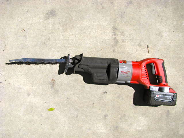

I also suggest a battery powered reciprocating saw for limbs and saplings under 2". Much safer than a chainsaw for small stuff. Reciprocating saw blades are much cheaper and easier to change relative to saw chains. I have found Milwaukee's THE AXE blades superior to pruning blades.

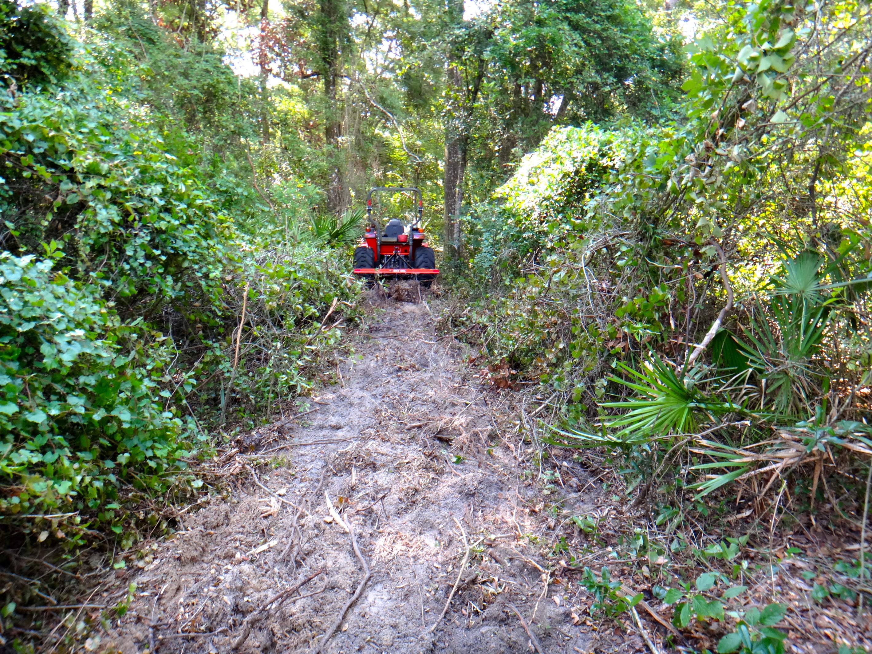

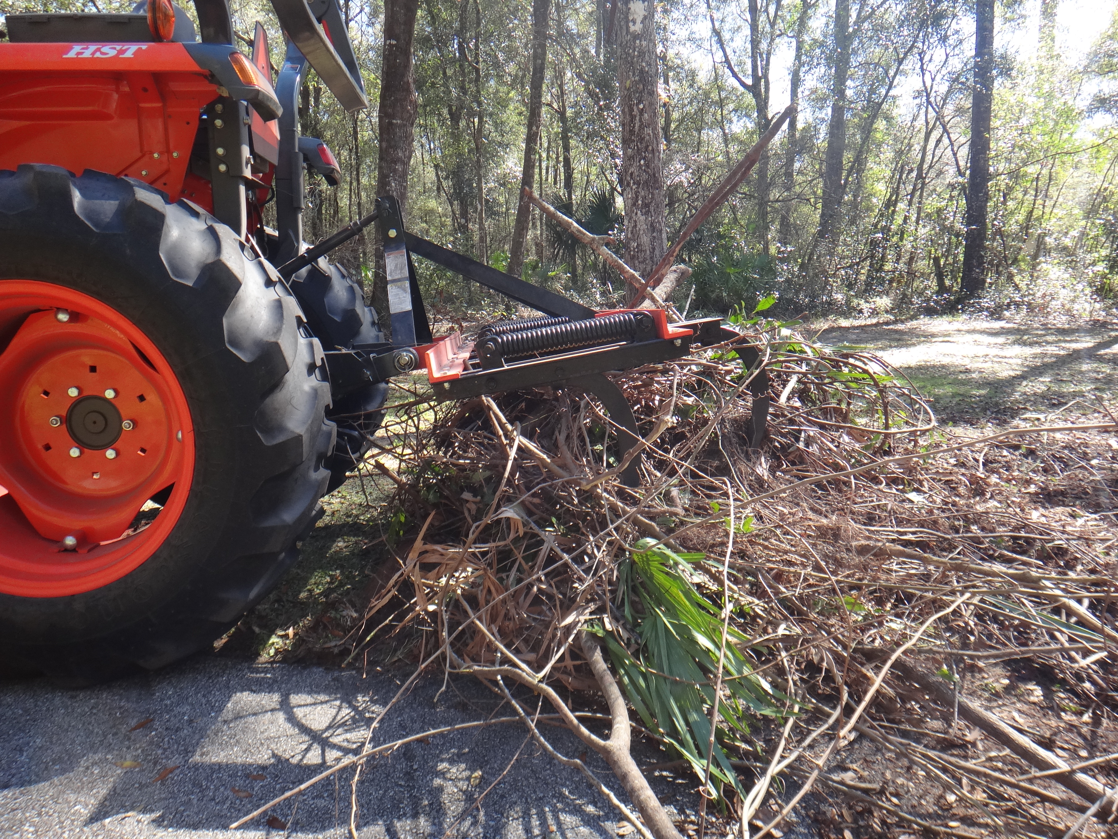

For removing softwood roots, vine roots and corms from below ground level I have had success using a spring protected Dirt Dog (brand) Field Cultivator in my Florida sandy-loam. I had it on my Three Point Hitch yesterday, pulling out subsurface Palmetto calves and wild grape vine roots up to 2-1/4" in diameter.

For overgrown pasture, previously packed by hoofed animals, you may need a moldboard plow to cut through the packed soil and roots. The Dirt Dog Field Cultivator is a secondary tillage implement which has worked 100% for me in woodlands soil but has not been up to primary tillage in hard packed pasture. In really difficult soil you may want a Disc Plow, which is NOT a Disc Harrow, rather than a moldboard plow, however they have a slight tendency to roll over some roots you might wish to sever.
A Chisel Plow would be another alternative. However, a turning plow will probably do more to improve the tilth and fertility of your pasture expansion.
Moldboard plows, Disc Plows and Chisel Plows are all primary tillage implements.

You never want to mix subsoil and top soil. As long as your clay is consistently 24" below grade you can still use any of my subsoil trash removal suggestions in Post #2. The Field Cultivator would probably disrupt soil levels least. The tines are only 1/2" thick.
