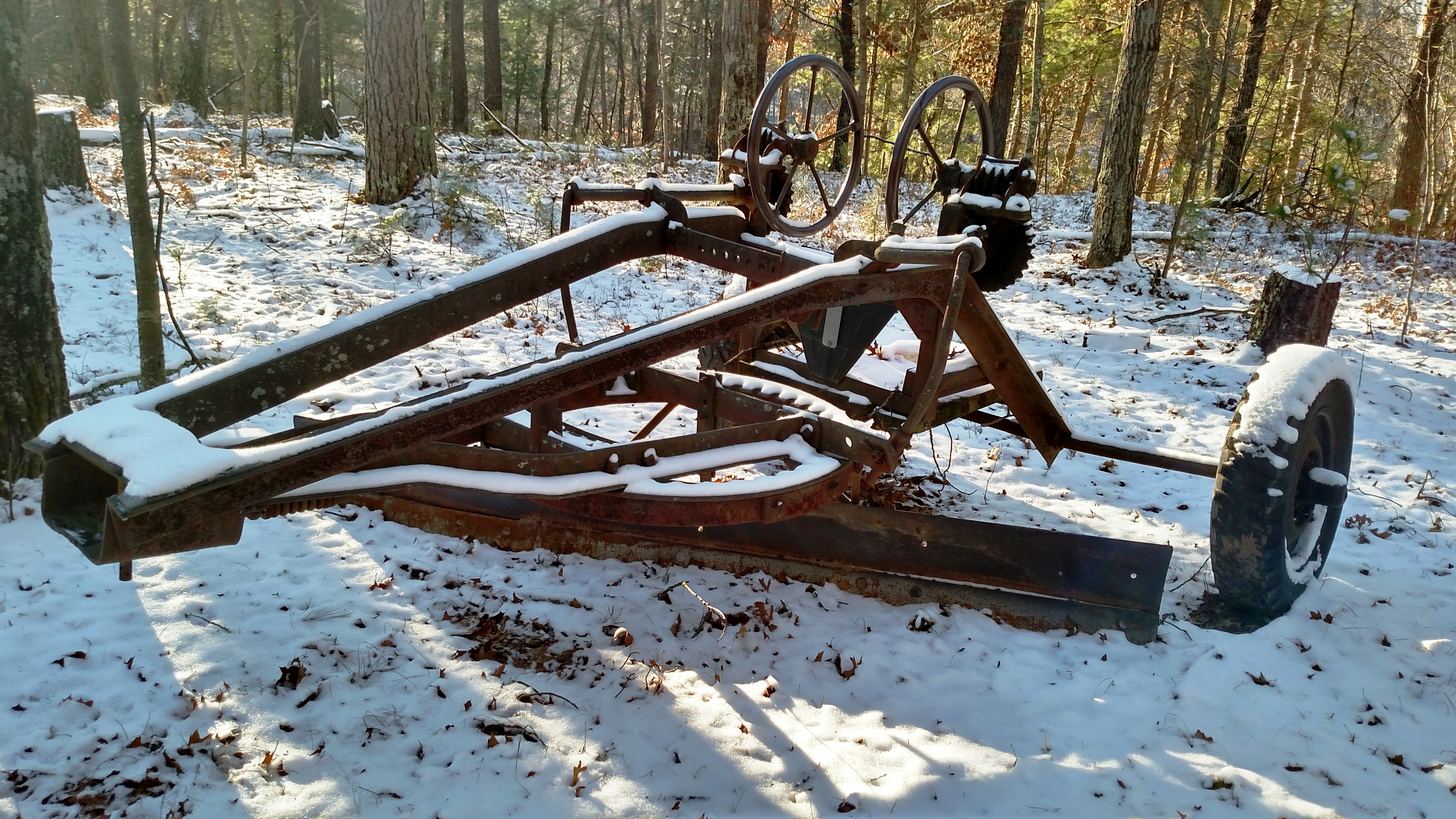

It's not so much the box blade as it is the scarifiers needed to rip up the grass and loosen the gravel. After that a landscape rake, rear blade or land plane would do the trick.
Better yet, buy an old pony grader
   / Reclaim, regrading existing gravel driveway #8
I have been looking for one for years.....

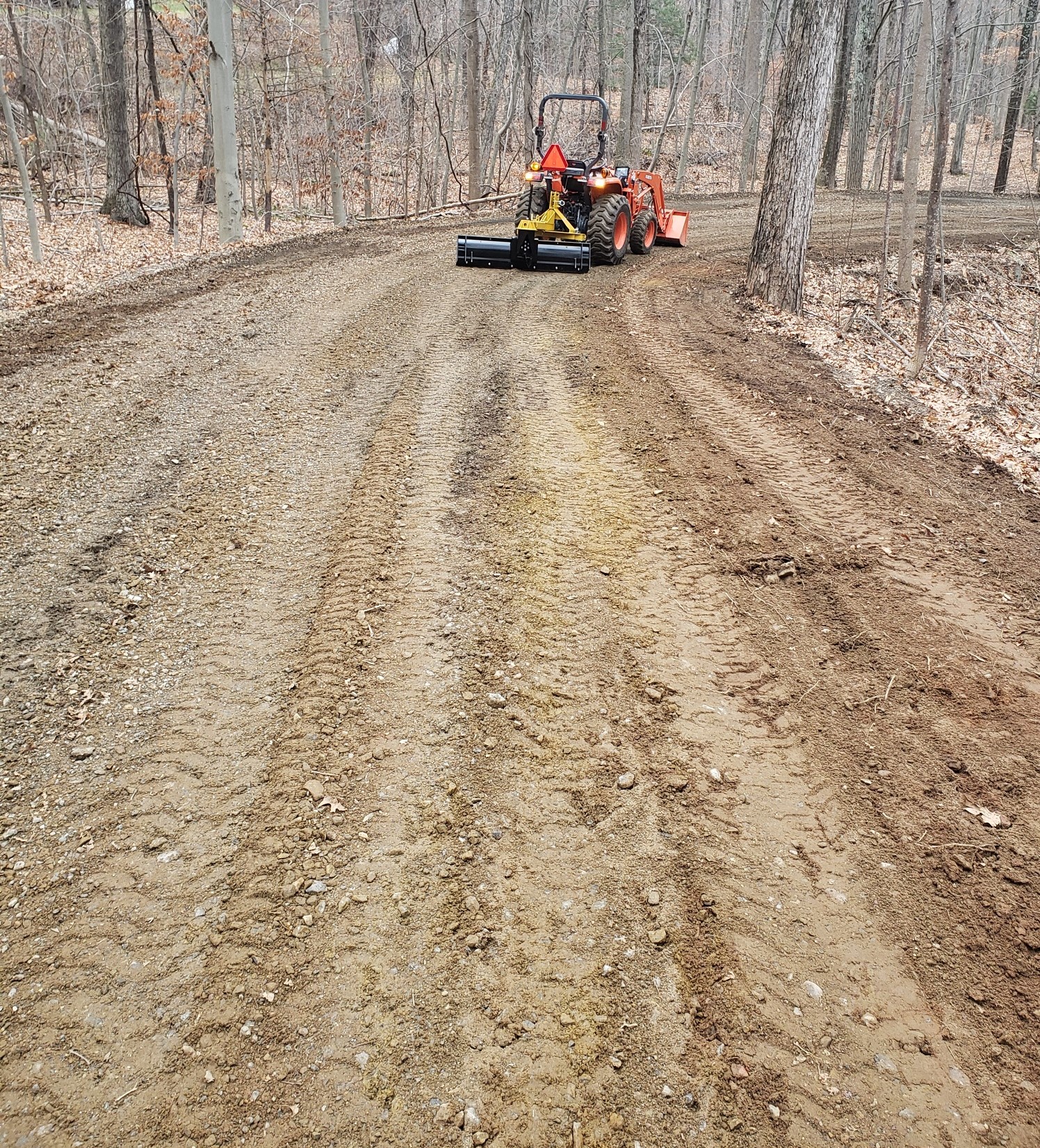

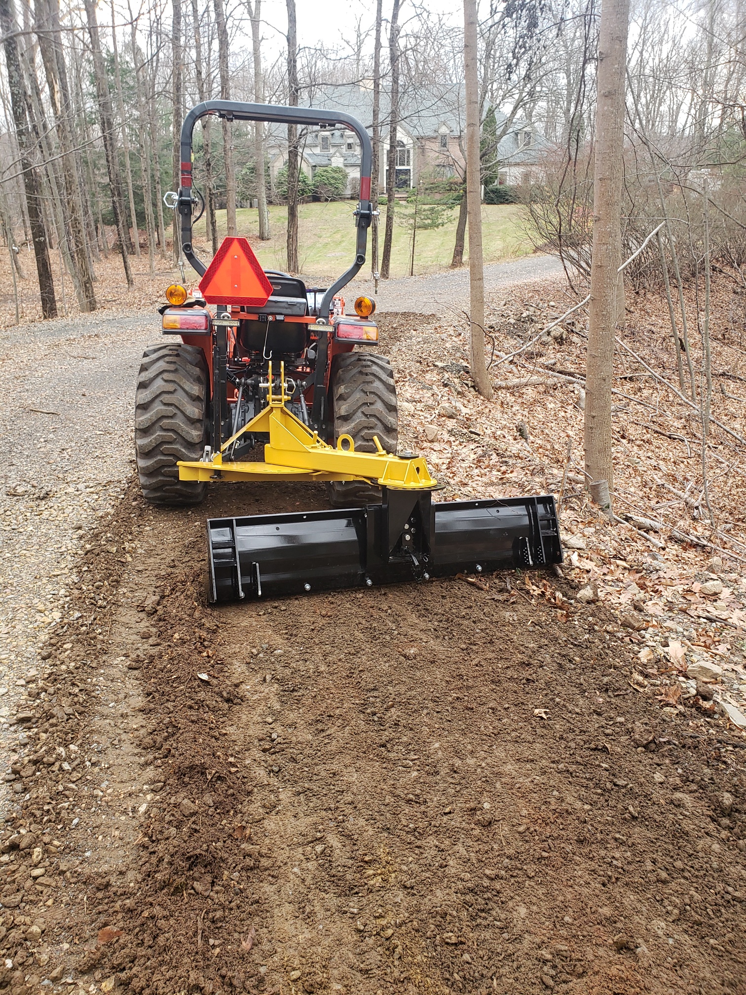

I used the tools I had on our gravel driveway (box blade and back blade). I needed to rip it first because I wanted to regrade it. The the box blade was used to spread the material and finally the back blade was used to finish it.
