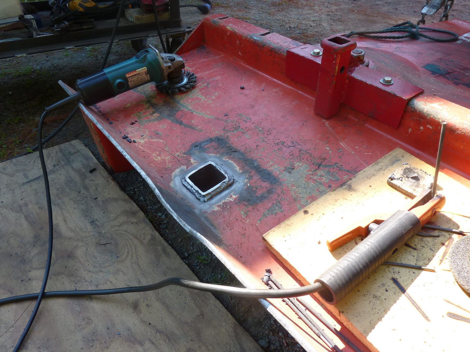

I am putting a 2"receiver hitch in the 3/8" thick butt plate of my winch. I run it on a 30 hp L3010 tractor that weighs about 5000 lbs. My little dump trailer is 4' X 6' and is rated for a 3000 lb payload. Can I just weld the receiver tube into the plate with a circumference bead on both the front and back sides, which was my plan, But not knowing about these things I wonder if I need some additional bracing ?? The tube is 2-1/2" X .220" that I got at a friendly welding shop. I cut it 5" long and it will barely protrude on the front side. Thanks.

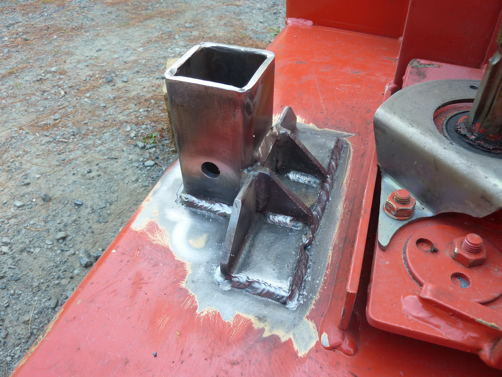

Thanks for the suggestions. I have no feel for the kind of forces that occur in a trailer hitch. I wanted to keep the bottom clear if I could to make it a little easier to put the pin in since it is up behind the plate. So this is what I ended up with.

Looks good should pull anything you hook to.

Does look good. The only thing I would or do add on these is a 3/8" band around the outer part of the receiver. Adds strength to the outer edges so you don't damage during a jack knife or tight turn. Most receivers have the band around the outer. I have a piece of the next size larger tubing that I cut the 3/8" band off of and weld it on. You may be ok without it. Good Job !

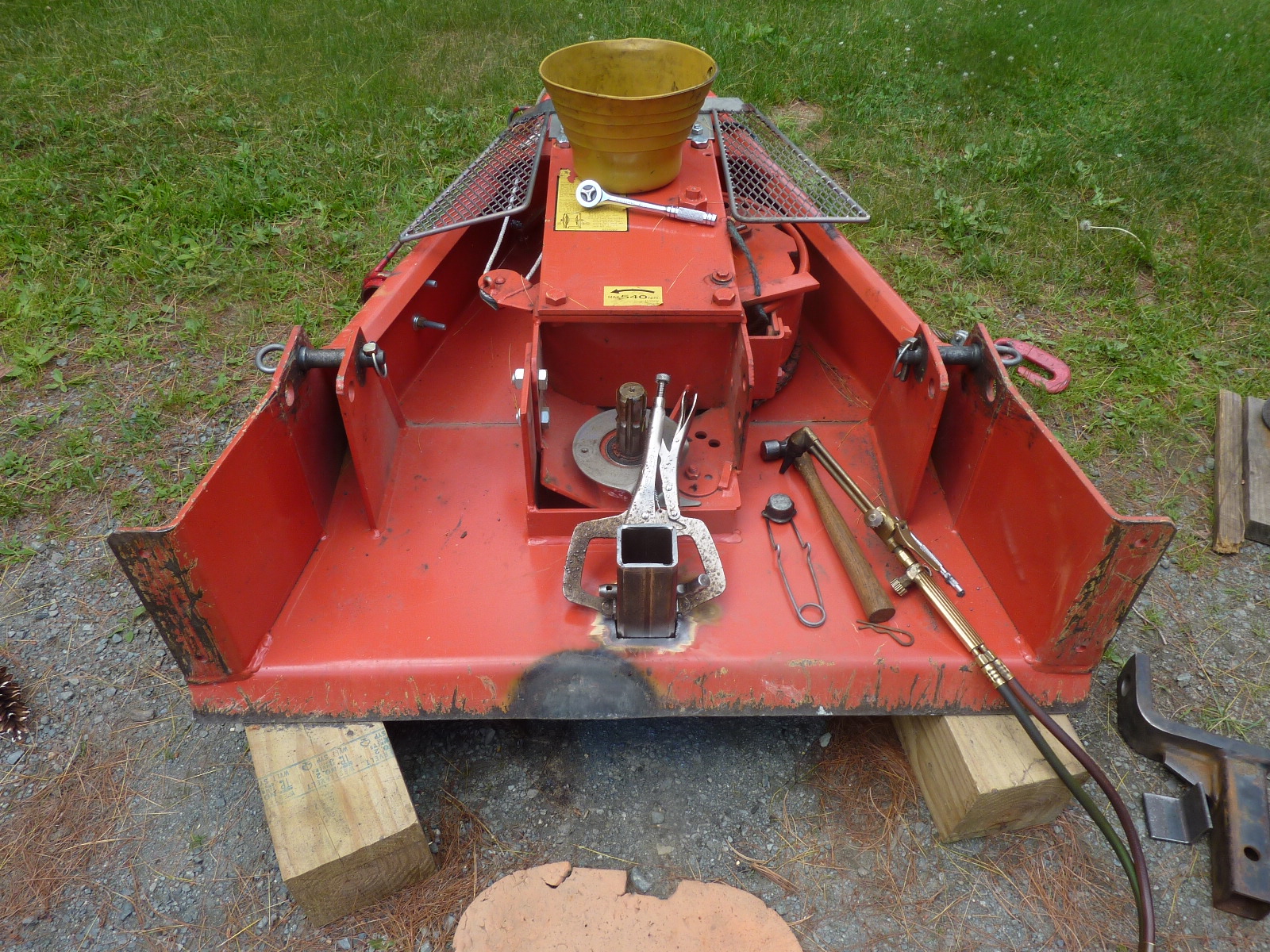

OK, I understand what you are saying. Thanks for the comment. I always wondered if those bands had a purpose or were just for dress - now I know. Always learn stuff here. The picture is actually the back end of the hitch tube. The trailer side is recessed pretty much into the butt plate so the logs won't catch on it as they swing and rotate around. Here is the working side. Would you suggest I need to change anything ??
The little 1-1/4" hitch on top I bolt on when I want to pull the wood splitter. When I am skidding logs it is not there. Same for any 2" ball.

Good to go in my book. Nice job !!
