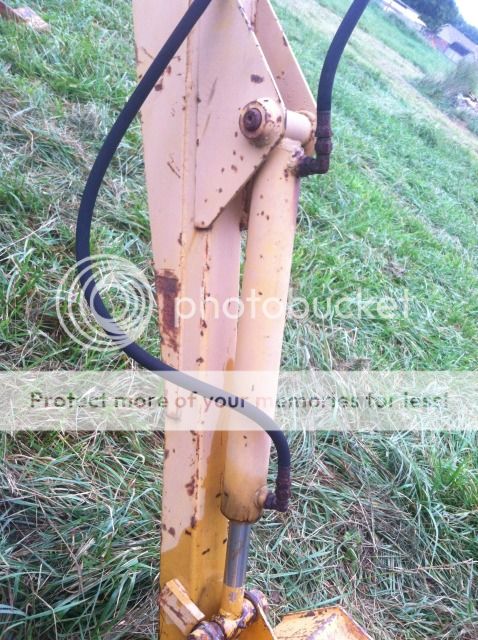

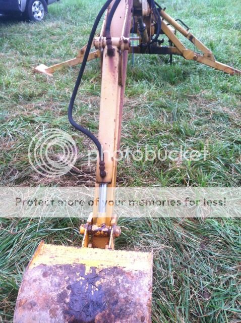

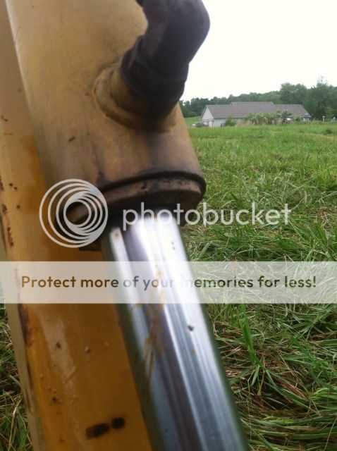

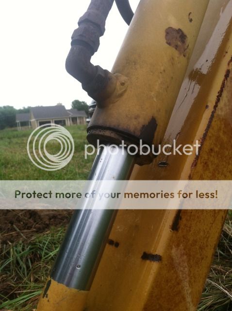

This cylinder is probably over 30 years old. Who knows if it has ever been serviced or not. Its the only cylinder that's leaking, but it leaks ALOT. I could probably fill a shot glass in less than 8 minutes w/ how much it leaks. whats my cheapest and or best option here? rebuild repack or replace?
/ Rebuild or Replace? #2
Depends on your use. The pits & nicks on the rod will work on the seals. If low usage, it might last years. Work it 8 hours a day, expect a couple of months. 3 Point backhoe not likely to get a lot of use... Polish the shaft & Repack it.

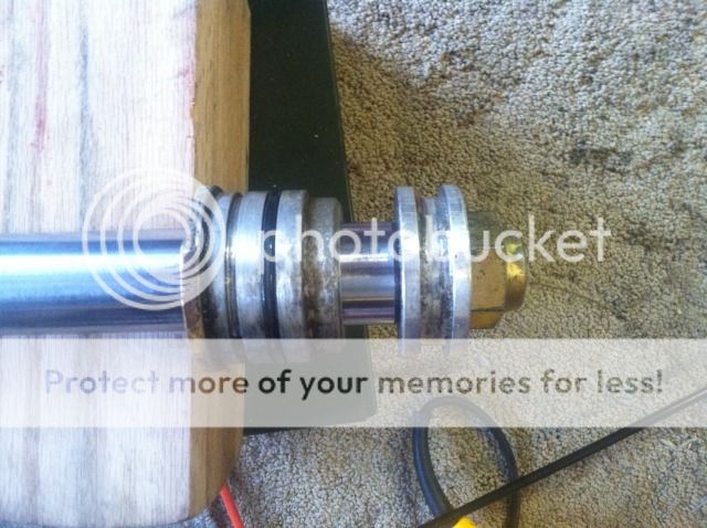

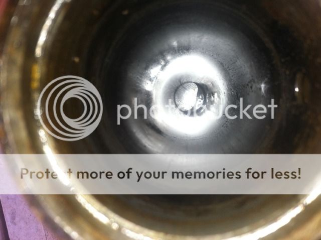

Well I decided to at least try to tackle rebuilding... so far so good. Any idea what I need to measure to order new seals? what type of seals? I am using travelers universal hydraulic fluid if it matters. Here are a few photos... the bore is 2.5 and the rod is 1.5 I have no idea how to piece together a rebuild kit for this cylinder. Any advice you can give as to how to measure, what type of seal ect ect would be greatly helpful.
and the bore looked pretty good also

The nut you have the pipe wrench on is an important once to always remove if the cylinder is creeping but not leaking externally The seal, accessed inside the piston once you remove the nut, although just a simple O ring, was always the one to fail on my equipment. There was no external leak. The oil was just bypassing the piston going between the piston and the main push rod. In the beginning, when the problem would first appear, I was changing the seals on the outside of the piston which were a bit expensive and did not realize there was an inexpensive seal inside the piston. Once I removed the piston I would find the O ring broken. I would take care in torquing the nut and even staking it but the O ring would still manage to fail.

I have been greasing the **** out of that little O ring, and reinstalling the piston w/ a twisting motion being sure not to put that little O ring in bind. None of the O rings pulled off the end of the piston shaft have been damaged yet though. the rod seals and outer bladder seals have been mostly pieces though... I am surprised she was even holding pressure at all given the condition of these seals.... Its fun to rebuild, and sure as **** beats the 500 per cylinder I was being quoted.
Some of the shafts have some minor pitting from rust, and a fine gouges that I stoned the high spots down, so I doubt I will ever eliminate 100 percent of the leaks, but I bet I see one **** of an improvement from the 12 inch pressurized streams that were coming out of some of the cylinders. I will probably get rid of the "drifting" I have been noticing as well.
