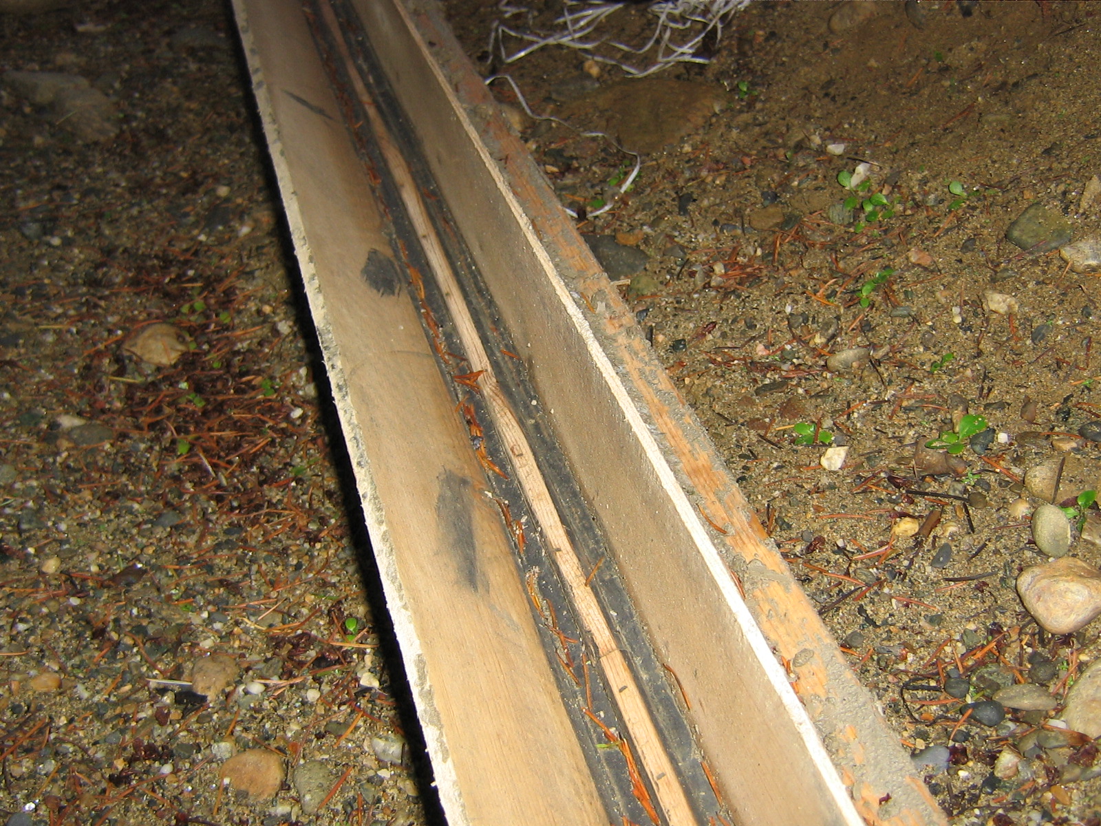

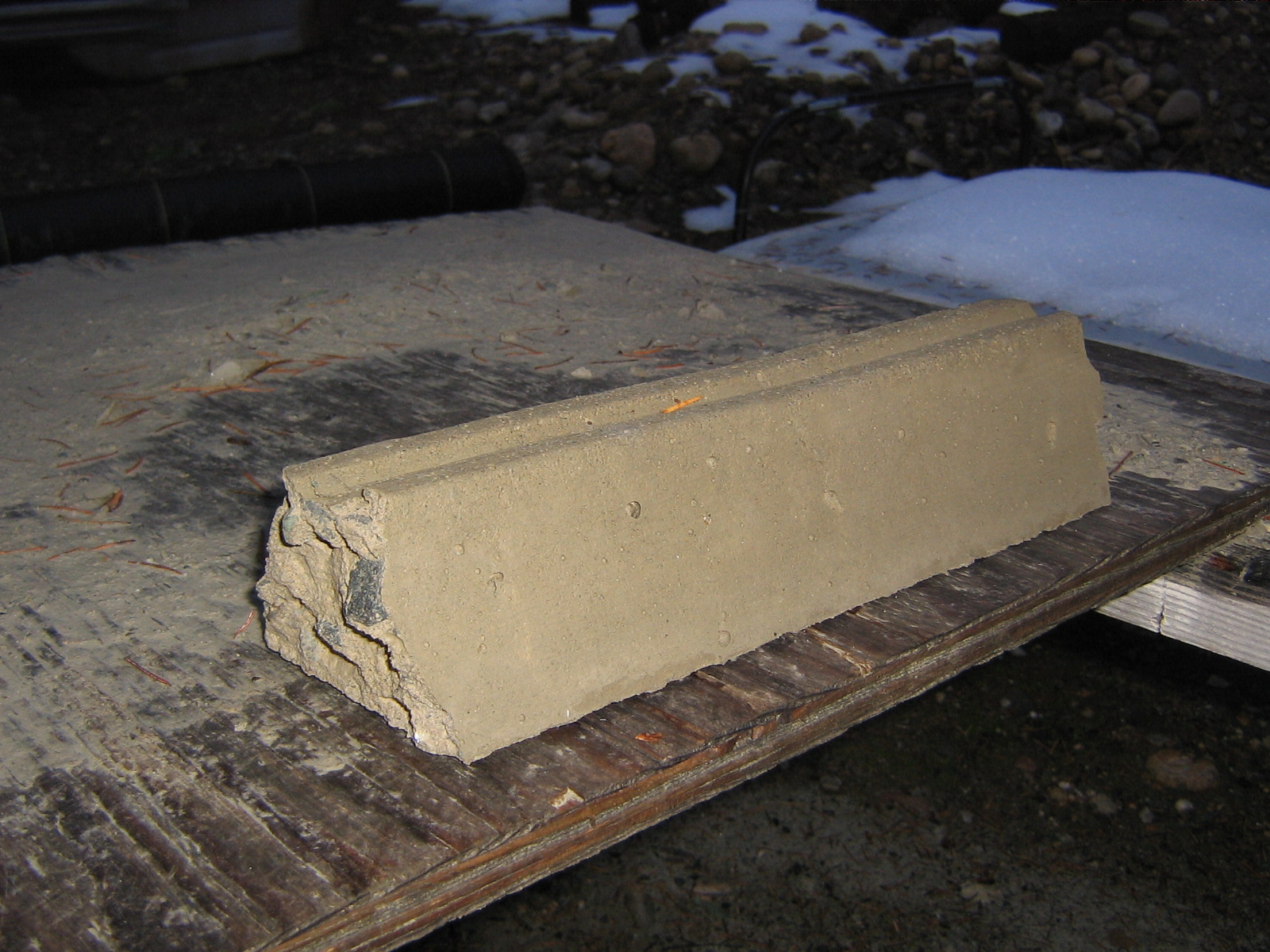

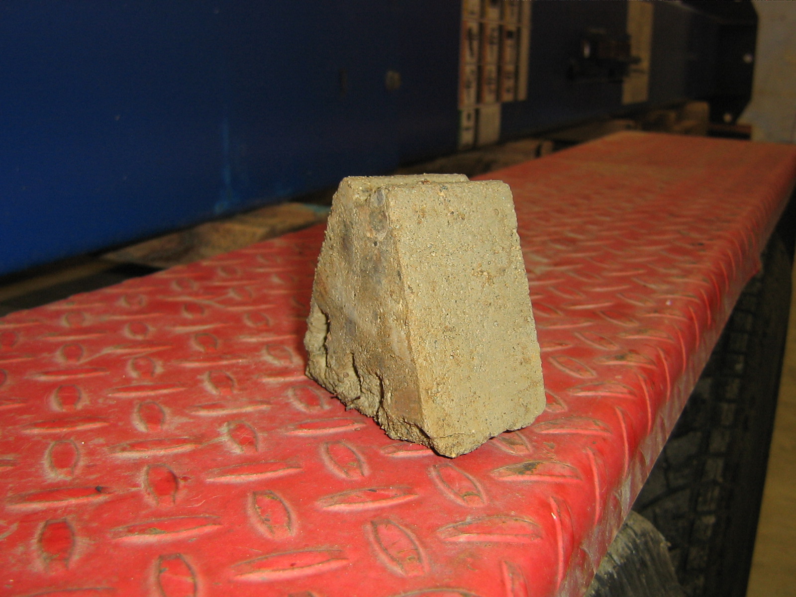

No inspection on a garage floor here so I was on my own. I installed foam over the compacted base, then plastic before installing the rebar. Rather than 12"x12" squares, I used 10"x14" because it would be easier for my big feet. My concrete contractor warned me that plastic rebar chairs would sink into the foam, destroying all my hard work so I made my own out of concrete. They were a pyramid with a 2"x3" base,1 1/2" high, spaced evenly, using about 400 of them in an area of 1360 square feet. I installed the pex above the bar because it was too difficult to put it below. It was easy to walk around before the concrete was poured because of the size of the squares and then when the workers couldn't see the bar anymore, they would occasionally stumble but it didn't damage anything while they walked on top of the bar. This did require using a pump.
What did you use for forms to make your own rebar chairs? Did you mix your own concrete or buy pre mixed?
I used a 2x6 and added angled sides to it to make a V shape form with a flat bottom and then stapled a crude piece of 1/2 round to the centre of the flat bottom. I mixed the concrete in a bucket with a home-made paddle mixer and then cut the pieces to length with a diamond blade in my skill saw. Yes it was a lot of work but my floor cost me about $10,000.00 and I couldn't afford to take any chances. 001.JPG002.JPG003.JPG

That's a good way to save some dollars. I'm no expert but I always wondered if some designs/brands of the plastic chairs made a void or weak spot in the concrete.
