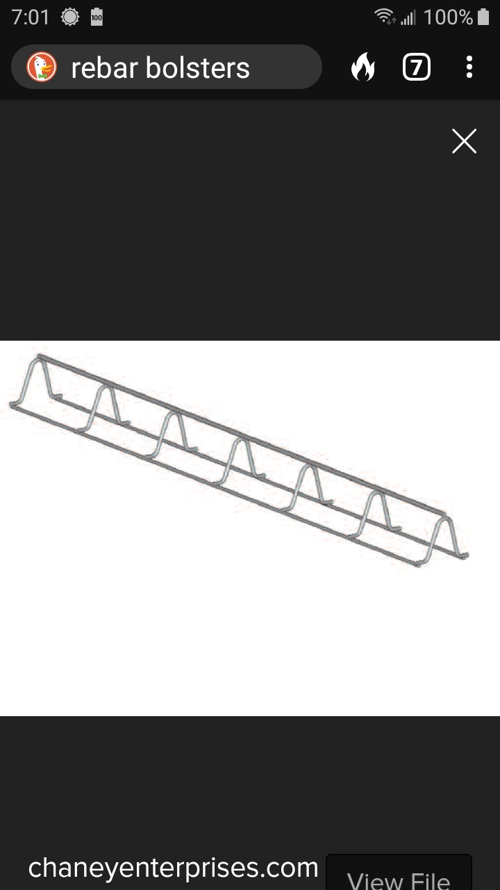

I like this style reber support. Available in multiple heights at "real" contractor supply houses that specializes in the needs of concrete contractors. (I am not)
