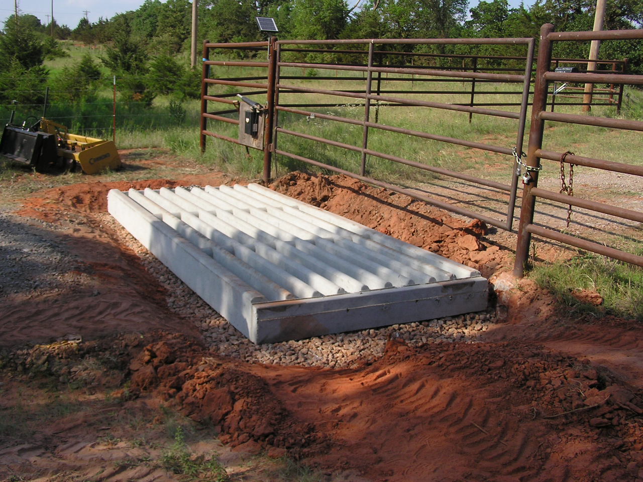

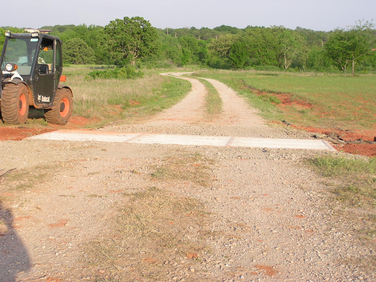

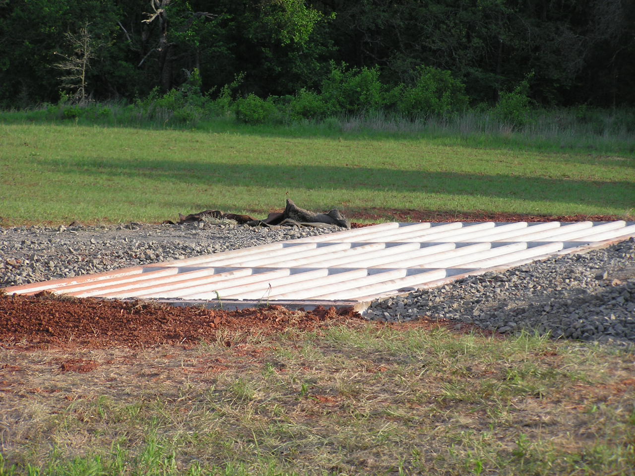

   / Rebar cattleguard #48
My 16x7 Precast concrete was cheaper than steel pipe.

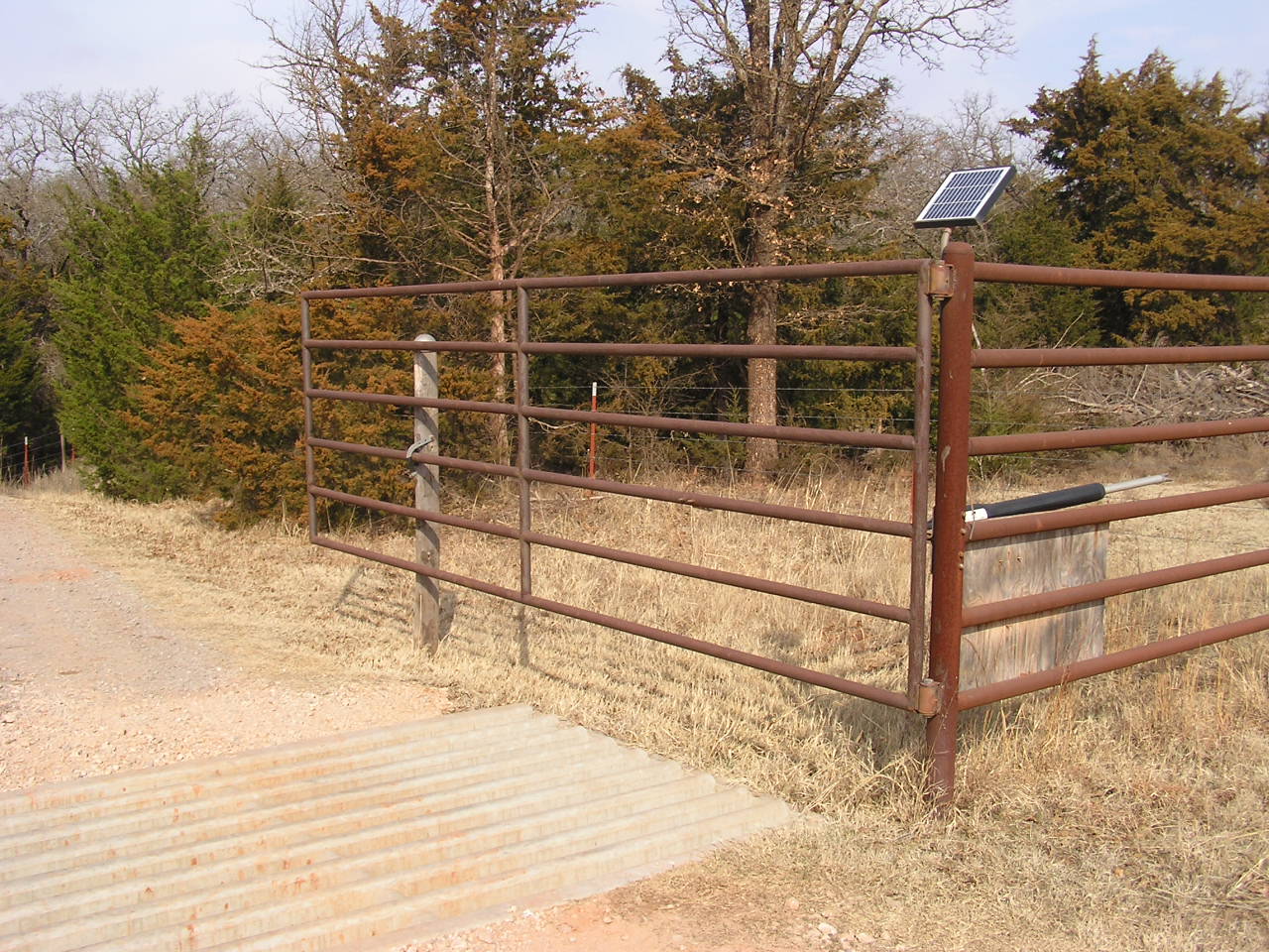

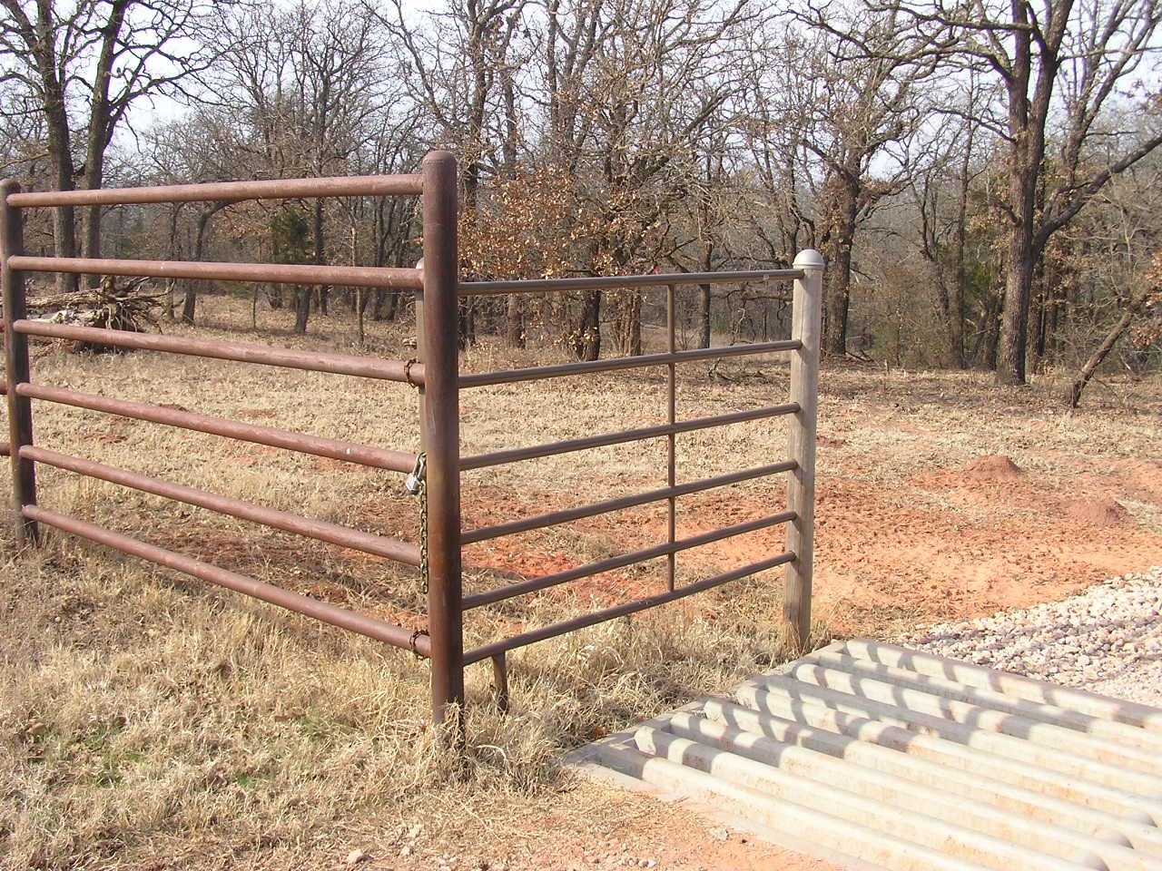

Found this one on craigslist.
   / Rebar cattleguard #49
I always put my CG so the fence line hits the middle and they have a side or diminishing side like the crags list CG. Are you going to put a barrier at the corner so the curious calves don't escape?
   / Rebar cattleguard #50
Could not put it in the middle, too long for the gate opening.
The gate blocks escape on one side.
Cut off a damaged panel for the other side.

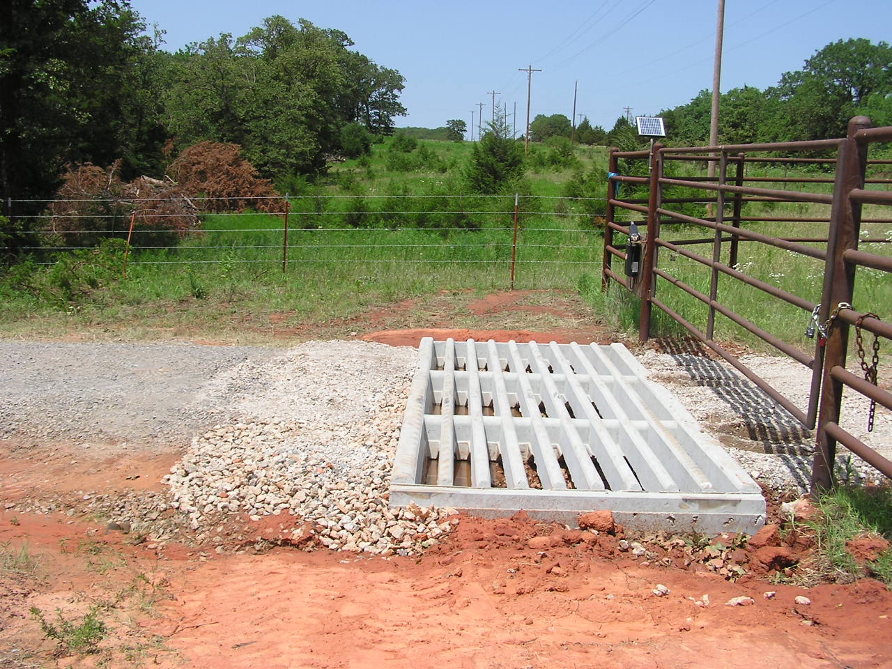

Thank you XFAXMAN....I was hoping somebody would mention the concrete guards. To the OP....if you want a CG that you can make out of easily obtainable materials from a home depot, this is the way to go. Form it up and use rebar to strengthen it. I’d used the higher PSI crete for it.
   / Rebar cattleguard #57
View attachment 365293 View attachment 365294
Thank you XFAXMAN....I was hoping somebody would mention the concrete guards. To the OP....if you want a CG that you can make out of easily obtainable materials from a home depot, this is the way to go. Form it up and use rebar to strengthen it. I壇 used the higher PSI crete for it.
We have two of them that have been installed for over two years now. Have had several loads of gravel and concrete delivery trucks use them, no problem.
Got them for $975 each from SI Precast Concrete - Agricultural Products
