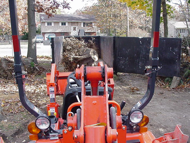

A picture of the lights. I picked them up at Harbor Frieght on sale for $20 a set, they are small in size but they put out a lot of light.

   / Rear work lights on a BX23 #12
One last picture of the lights from the back.

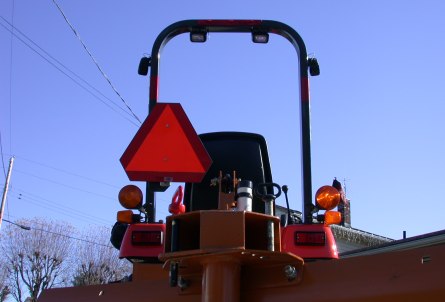

Well I got started by first looking around for a decent set of lights. I wanted something that had a glass lense so that it wouldn't yellow over time and I wanted something that was going to stand up to the occasional whack from a tree branch. The lights I ended up using were Hella worklight which I got online from AWDirect - Hella work lamp . I had actually bought a pair of the Hella double lamp worklights to mount up high on the ROPS and decided that what I really wanted for now was something up high. One of the biggest things that was driving me was just getting something on the tractor and working because I needed lights to be able to continue working as the days got shorter. The first thing I did to try and figure out where I wanted to put them was temporarily hook one of the lights up to a battery from my 18volt Dewalt cordless so I could use it like a spotlight and move it around on the tractor to decide where a good placement was. I decided on down below the fold point on the ROPS because I wanted to avoid having to get all fancy running the wiring to compensate for the fold point. I also wanted them to be protected from getting whacked by tree branches and not be in my way when I was using the backhoe. The place where I ended up putting them turned out to be just right - they are just inside the plane of the ROPS and they don't project into the inside area of the ROPS where they might be in my way when using the backhoe. They are also high enough not to block the warning lamps. I originally intended to run new wiring to the back of the tractor and install a switch on the dash somewhere to control the lights. To save time and get the things working ASAP I ended up using the wiring pigtails that are located under the seat - I used some black wiring loom I got in a kit from JCWhitney and some automotive wiring I had on hand and just ran the wiring down to the pigtail location and spliced it in. The problem with doing this is that the pigtail is hot whenever the ignition is on - so the lights stay on all the time. The pigtail is routed thru the little fuseblock that is under the dash and has a 20amp fuse on it though so that is good. When I get the chance I think I may splice into the wiring under the dash coming from that fusebox out the pigtail and insert a switch on the dash. I got a BX headlight switch from the Kubota dealer all ready to go for when I finally get the chance to do it. I have had these on the tractor now for about a month and they work great either with a rear implement or with the backhoe. When the backhoe is on it lights the whole thing up just right and I can see far enough out and to either side to use the full range of the hoe. The only problem is with digging a deep trench close to the tractor - they dont shine down far enough for that. I have a set of the double bulb Hella worklighs that I want to mount up high on the ROPS for that when I get a chance.
The biggest problem that I see with the tractor now as far as lighting is the front headlights are a real pain to use when you are using the FEL. I plan on mounting some lights down low on the front to shine under the FEL when traveling and then another light up higher to shine over which I think will give me pretty good lighting coverage. I will post more when I have this done - I have to pick up the steel this week so I should have it done in week or two.

   / Rear work lights on a BX23 #15
Hey Jim,
Nice clean professional job.
I did something similar but without welding.On the lower part of the ropes(BX-22) there is a web that I was just able to drill a 5/16 hole to mount the lights see attached photo.
