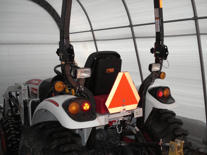

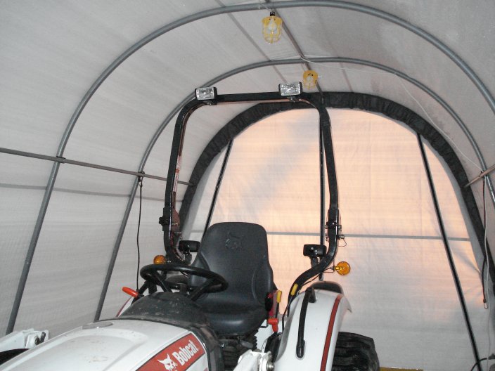

now how about someone that has some mounted up on the ROPS?
how about like this. two forward (flood) and two back (trapazoid).
hooked up my own switch to run all four lights.
worked good all winter for plowing after dark.
nothin' beats being able to turn night into day, 360 degrees around the tractor:D
   / Rear work light #12
Tubo660, what method of wiring did you use? Did you use the pigtails rear lights or do a home run to the battery? I like the setup.
   / Rear work light #13
I purchased a switch kit that came complete with switch, relay, and wiring. relay comes off +terminal on the starter, switch ties into the high beems. When you turn on the high beams you flip the switch for top, and rear lights. Leave switch on and they turn on and off with the headlights.
The pigtails I used for a L.E.D. beacon on top of the rops.:)
