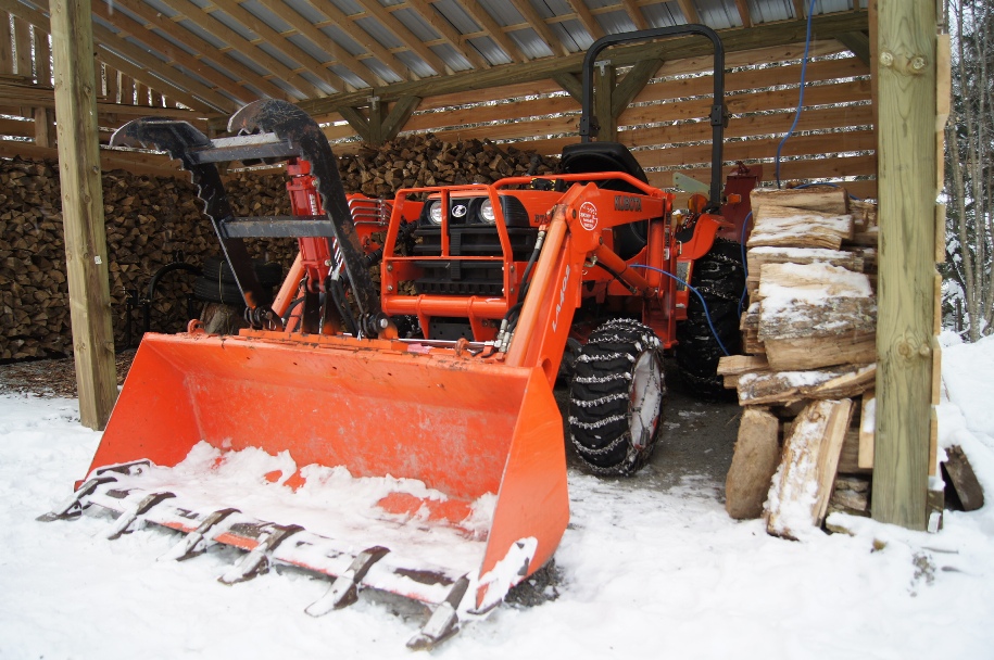

Here are the chains I have. They have DOUBLE the cross bars, because the cross bars want to fall in between the lugs on the R4 tires. Mine have V-bars on them, and EAT the driveway! lol
They are insane in the woods, I use them for skidding logs out! :thumbsup:
The tensioners keep them from flopping at all, and they have NEVER touched my fenders yet.
That's what I have as well but I made the mistake of getting 4 link chains instead of the 2 link chains like yours. When I bought chains for the front tires I bought 2 link v-bars. Both sets are fantastic for traction.

450 pounds is likely NOT enough weight to make a 3520 a good snow removal machine.
I think I'll wait and see just what the R4's and the tractor itself will do before I go with chains. I'm going to get a set of the 2 link standard chains just to have if things don't work out. I'm a firm believer in having a back-up plan. Thanks to all who replied and I'll keep you all up to date on all my 3520 adventures. Don't stop with the info I'll take all I can get.
   / Rear wheel traction in snow #28
Wise choice.:thumbsup::thumbsup:

Also be careful of too much weight in the back as it will kill your steering abilities.
