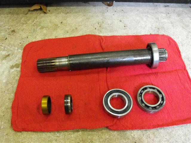

I think the 2000 and the 1900 are pretty close in the way the bearings come out. Here's some pics of mine when I changed the bearings and seal.
The piece of pipe was used to push the new bearing back in.

Would seem to me the best way to change that sleeve is to remove the axle housing as Gary did. I'm not sure you would have to have a press to do the job. I'm sure it might make it easier. My experience would lead me to believe the bearings will not be that tight fitting. The sleeve probably is. Looks to me like the shaft with bearing would tap out of the axle housing once removed. Then you could use your puller to remove the outer bearing and sleeve.
Normally, a sleeve like that without an o-ring seal would be a shrink fit. Reason being it would leak if not. The parts drawing does not show an o-ring. If you determine to remove it take a chisel and hammer and whack it good. It would most likely help to loosen it for easier removal.
