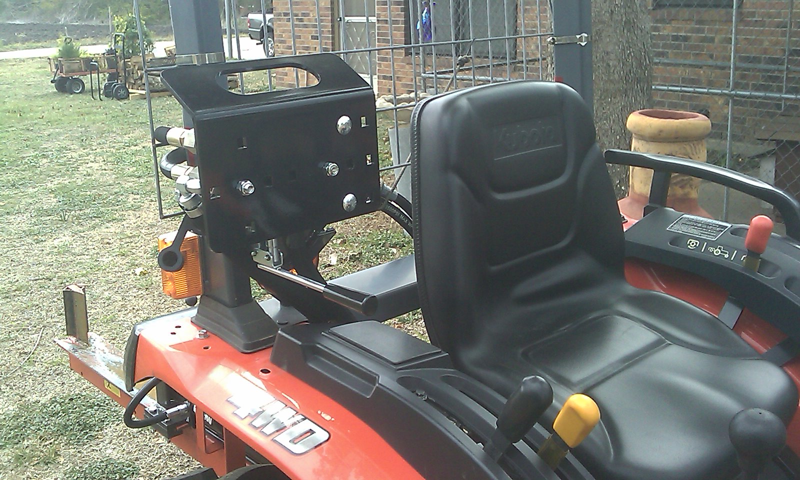

   / Rear Remotes #4
I'm happy with the factory install. I think you want the type where the control valve lever returns to the neutral position automatically. Basically you want the ram to go in or out (translates to up or down) and when you turn loose of the lever the ram stops moving and the control lever returns to the center.
Attached is a photo of a single remote installed on a B3200.

   / Rear Remotes #5
Just to confuse the issue, some people have 3 remotes for a rear blade. Top link, Side link. and a 3rd for some of those more expensive rear blades that have a power angle cylinder to adjust the angle of the blade on the fly instead of getting off and selecting one of 5 holes. So with 3 you can adjust your angle of attack (top link) side angle for ditching (side link) and scrape angle (hydraulic angle adjust on the blade itself).. Good luck
