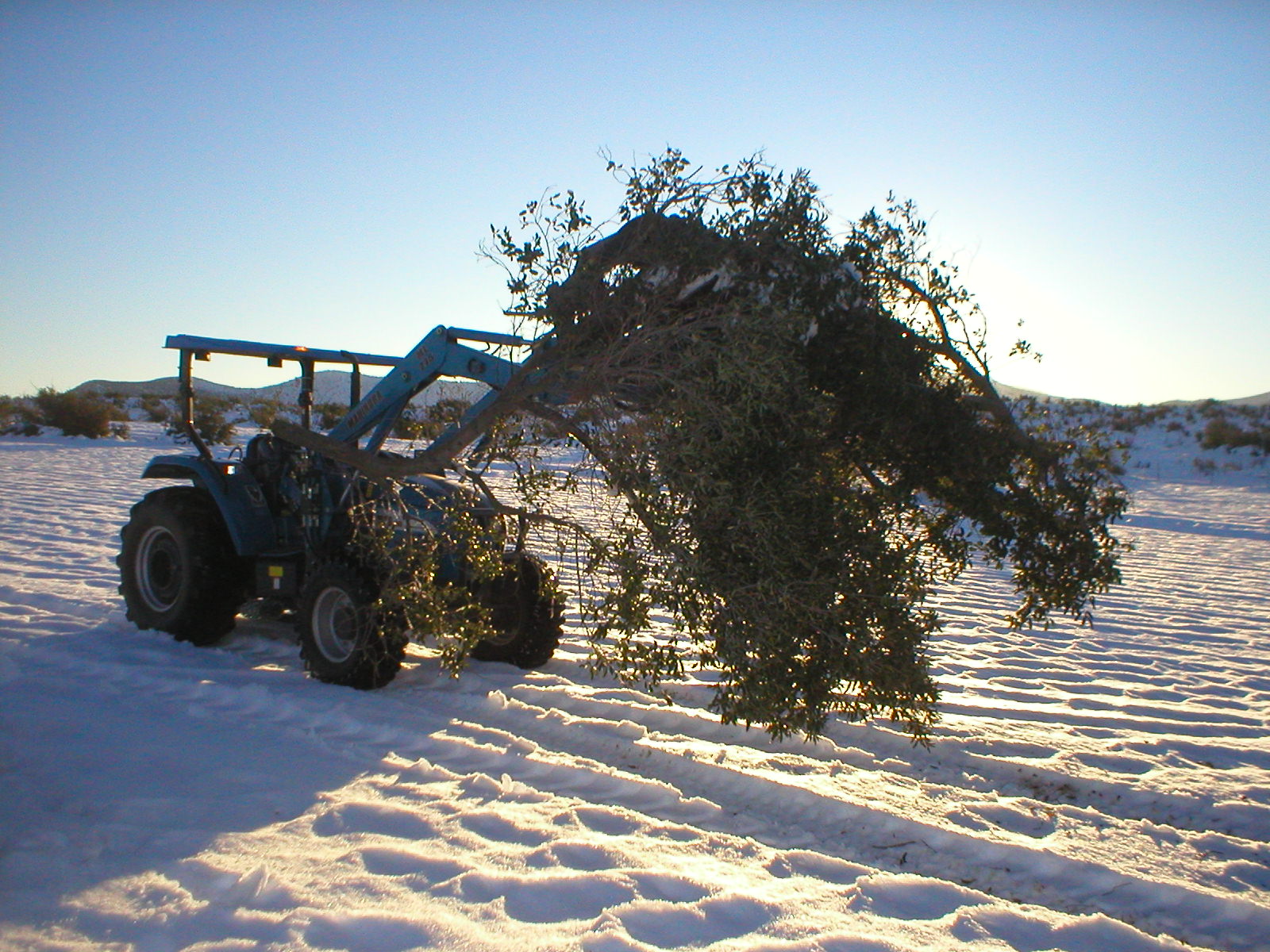

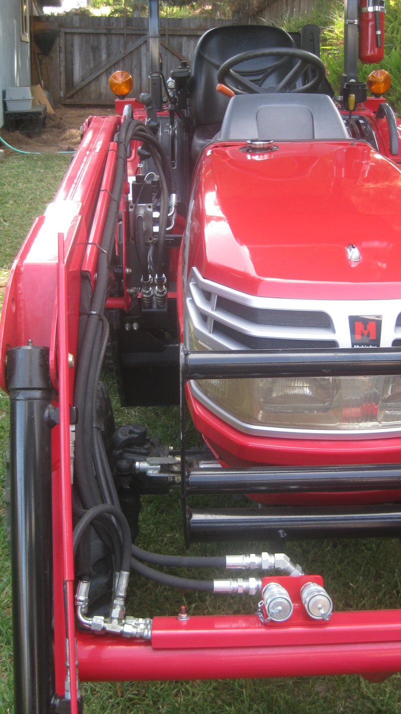

If you get tired of researching this stuff, I can walk you through the process so that you have a complete custom system for your tractor.
True 3rd function shipped to your door. $684
Diverter type 3rd function shipped to your door. $649
I have the diverter systems on both my CUT and UT machines. ;)
