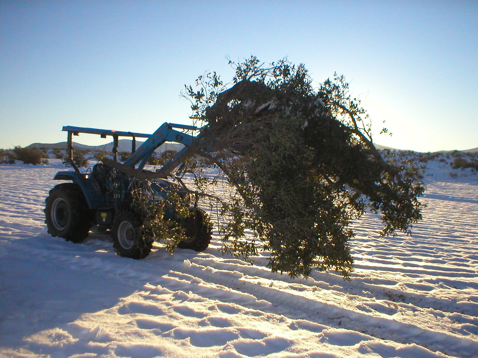

I spent $150 total two 90 degree fittings and two 6 foot hoses and two 10 foot hoses to go from the location under the tractor where all of the OEM hoses attach to the loader valve. And of course all of the male and female quick connects. I made a simple L bracket for the torque tube. I can easily remove the loader by unplugging the two QCs in the middle. It all works well.
