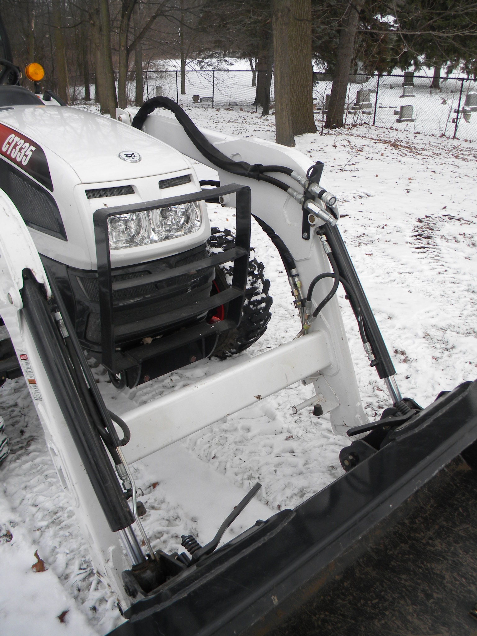

I use a set of hoses routed from my rear remote to operate a loader mounted angle blade for snow removal. For a grapple I think that I would prefer the third function valve on the joystick though.

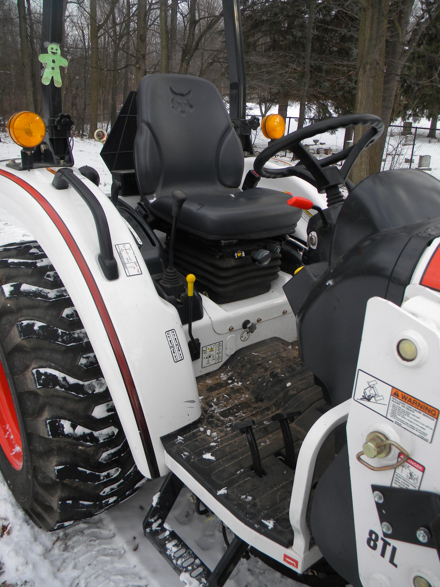

Here is a photo. I only have one remote. The other knockout is between the sticker and the speed adjustment knob. The other two photos show my hose routing to the front for the loader mounted plow.

Then the second one must stack right beside my first one on the outboard side? I haven't seen the second valve installed myself. I thought that might be a little far inboard after I posted the pic.
The first valve is no problem to reach from the seat. The handle sits just about where you would reach to scratch the side of your knee.

There should be two knockouts right next to each other. I have two sets of rear remotes...one with a detent for future backhoe.
