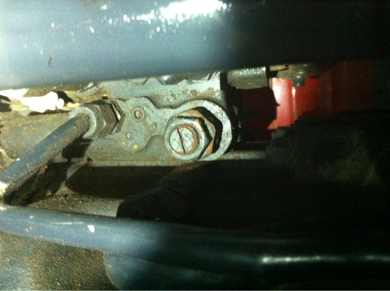

Is it possible to add a set of remotes to this tractor without going the dealer route (nearly $2000)? Would like to add two remotes to the rear and (wishlist) one to the FEL for future use.

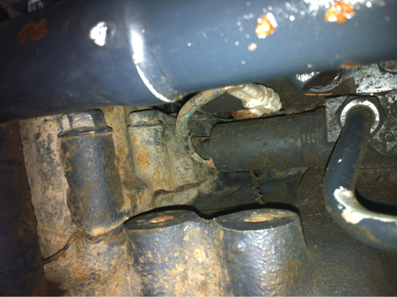

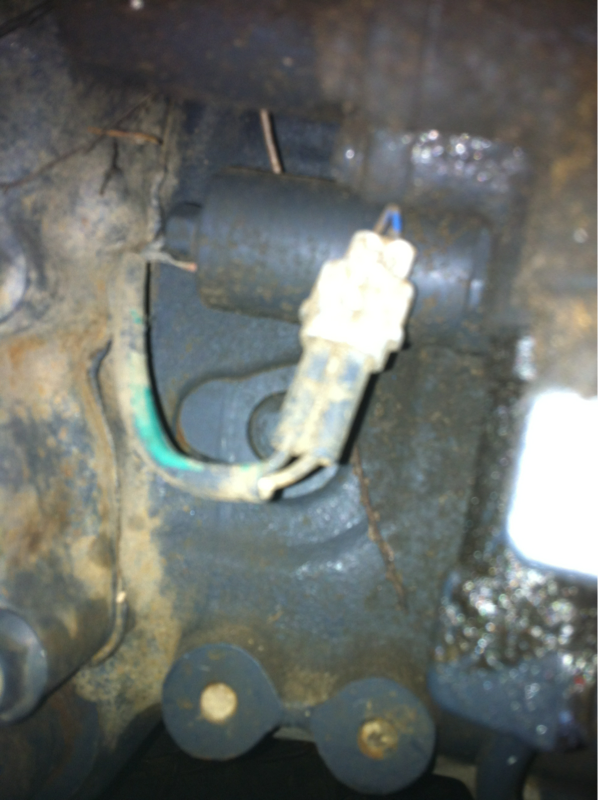

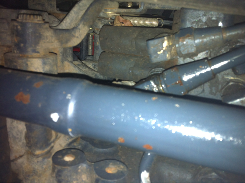

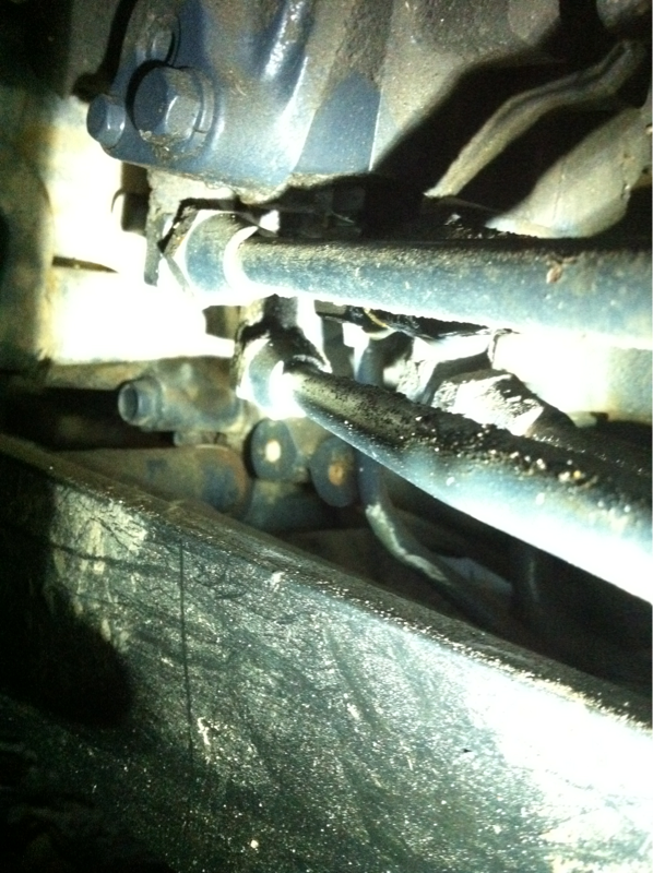

I'm not even sure what to look for. I don't think there are any other ports on the valve but it's in a tight spot. The dealer said something to the effect of the rear valve being a "sandwich" valve or something like that. Hooks right up to the trans case. There do appear to be a couple of ports on the case below the FEL valve that could be the hookup points. No markings I can see. Took some pics.
Looking back from under the right step.
Underneath.
The two ports I mentioned earlier. There also appear to be a couple extra plugged ports or mounting points.
Other shots showing more of the same from other angles.

So, if I understand you, you only have hyd for the 3pt. Can you follow the pump pressure line to the back?
Do you have a manual for your tractor, it should show all the connections.
You mention FEL valve but I don't see it in the pictures.

The valve in the pic is the joystick control for the FEL. That and the 3pt lift arms (everything internal except the control lever) are the only hydraulics on the tractor. The owners manual discusses the rear remotes and FEL joystick operation but no technical details.
Pic 2 and 3 could be spliced together.

Thanks for that link! I went out and had another look at the tractor. I see now where the hardline is for the 3pt hydraulics. With a wheel and cover in the way, it's really hard to see. Knowing where to look helped. :thumbsup:
Okay, so I'd remove that line, install a hose on the fitting on the FEL valve and run that to a new valve for my remotes. PB from the new valve back to the 3pt connection I previously disconnected. The only part I'm missing now, is where the return goes... where's that plug located?
