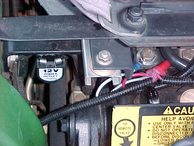

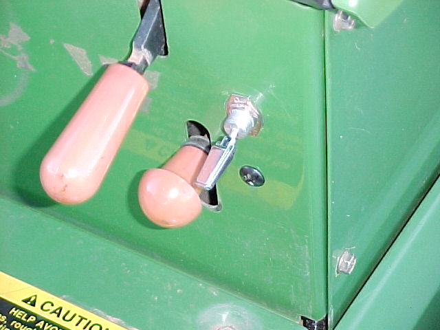

I have struggled with this decision for a long time, and I don't know why.
I just went out to Discount Auto Parts, picked up a 55 watt tractor light, a rocker switch, and in-line fuse.
In a matter of minutes I am ready for the night. I drilled a new hole to mount the light and used an existing Kubota hole to mount the rocker switch.
Can't get any easier than this. Why I didn't do it sooner I will never know.

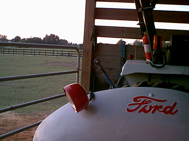

Ok.. this post is more for comic relief than anything.. but um.. check out the 'rear' lighting on this NAA I just aquired.
