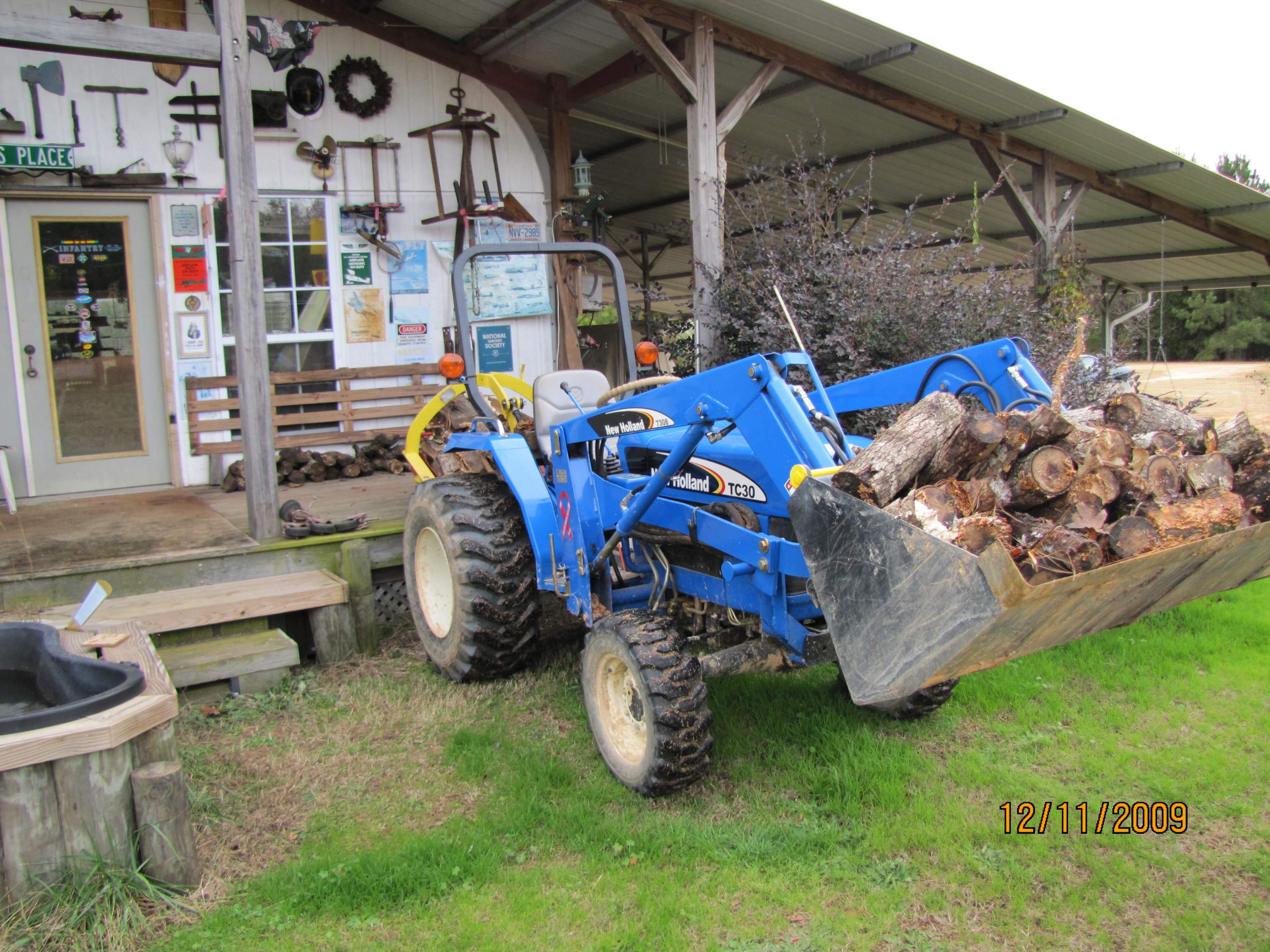

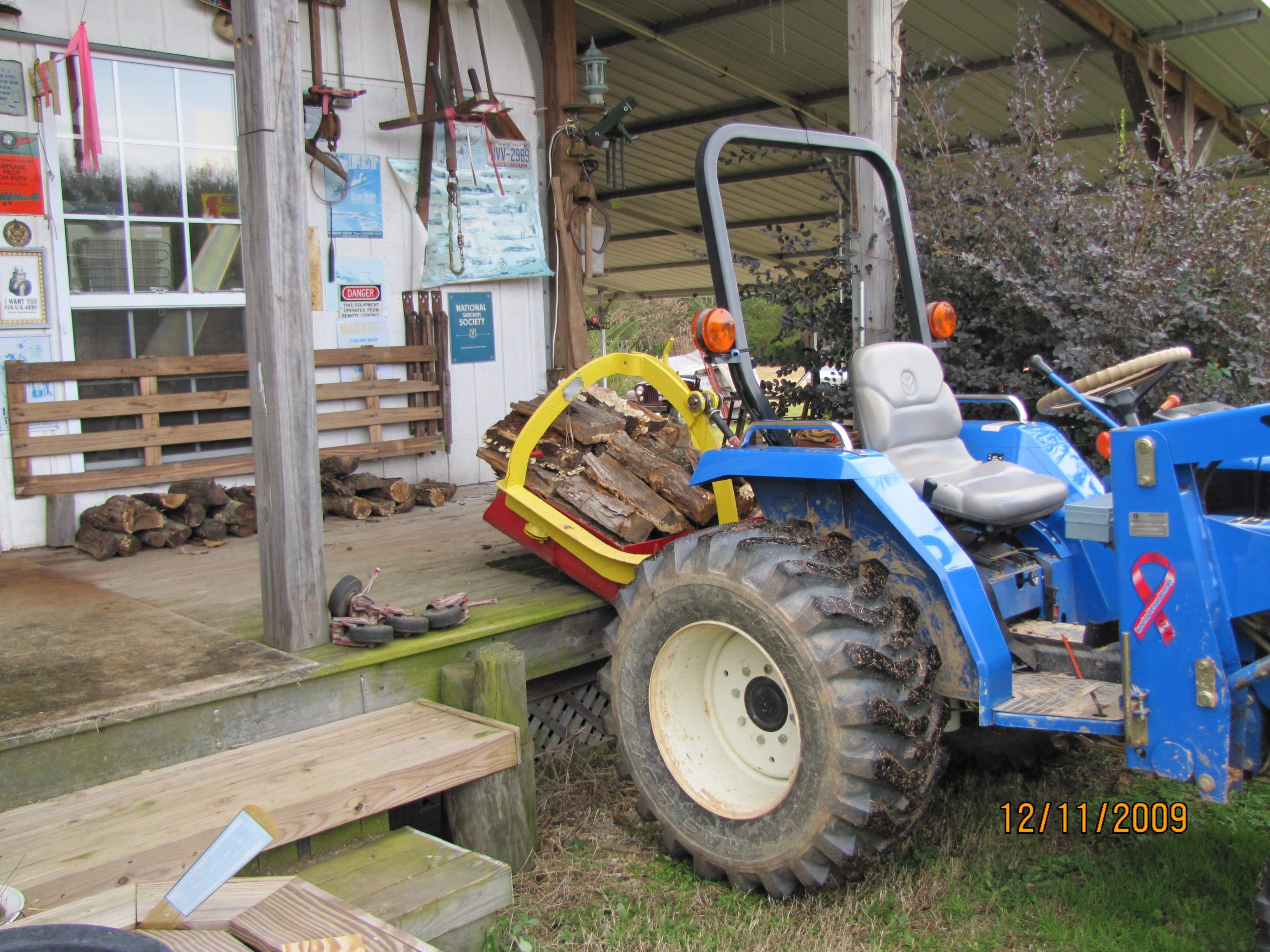

You'll know when the front of tr. comes off the ground. Build a platform off front soas to off set the back. Load it , an you'll be all set.Iload my frunt bucket an load the stone bucket on the 3 pt hitch. works great!
Army Grunt
