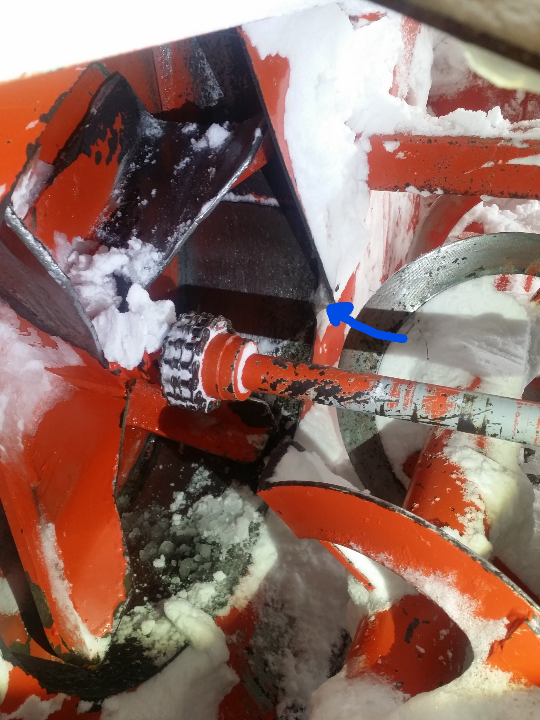

The Meteor fan design looks like a bit more robust than the Farm King. The steel looks thicker and the reinforcement for the blade runs the entire depth of the blade. You can see the bend in the plate that restricts the drum opening on my blower in the third photo.
The blue arrow in this photo points to the gap which is filled with ice:

The edge of that plate should be right against the drum opening.
There are so many things about my old Meteor that are better than the FK. The Meteor uses an oil bath gear where this is open gears. The Meteor uses a #60 chain for the auger drive, the FK uses a #50. The steel for the fan is way thicker on the Meteor and the bracing is MUCH more robust. The auger bearings on the Meteor are grease-able and the FK are not. The auger flights on the Meteor have right angle bracing stiffeners and the FK does not. On the FK there are 3 bearings for the fan drive shaft and 2 of them are not grease-able either. The FK website states this blower is suitable for tractors with 60 - 90 hp. My tractor only has 53 PTO hp. I think a 90 hp tractor would tear this thing up.
The restrictor plate shown in photos 5 and 7 was flush with the fan housing before I used the blower. The fan blades hit that plate and bent it out.

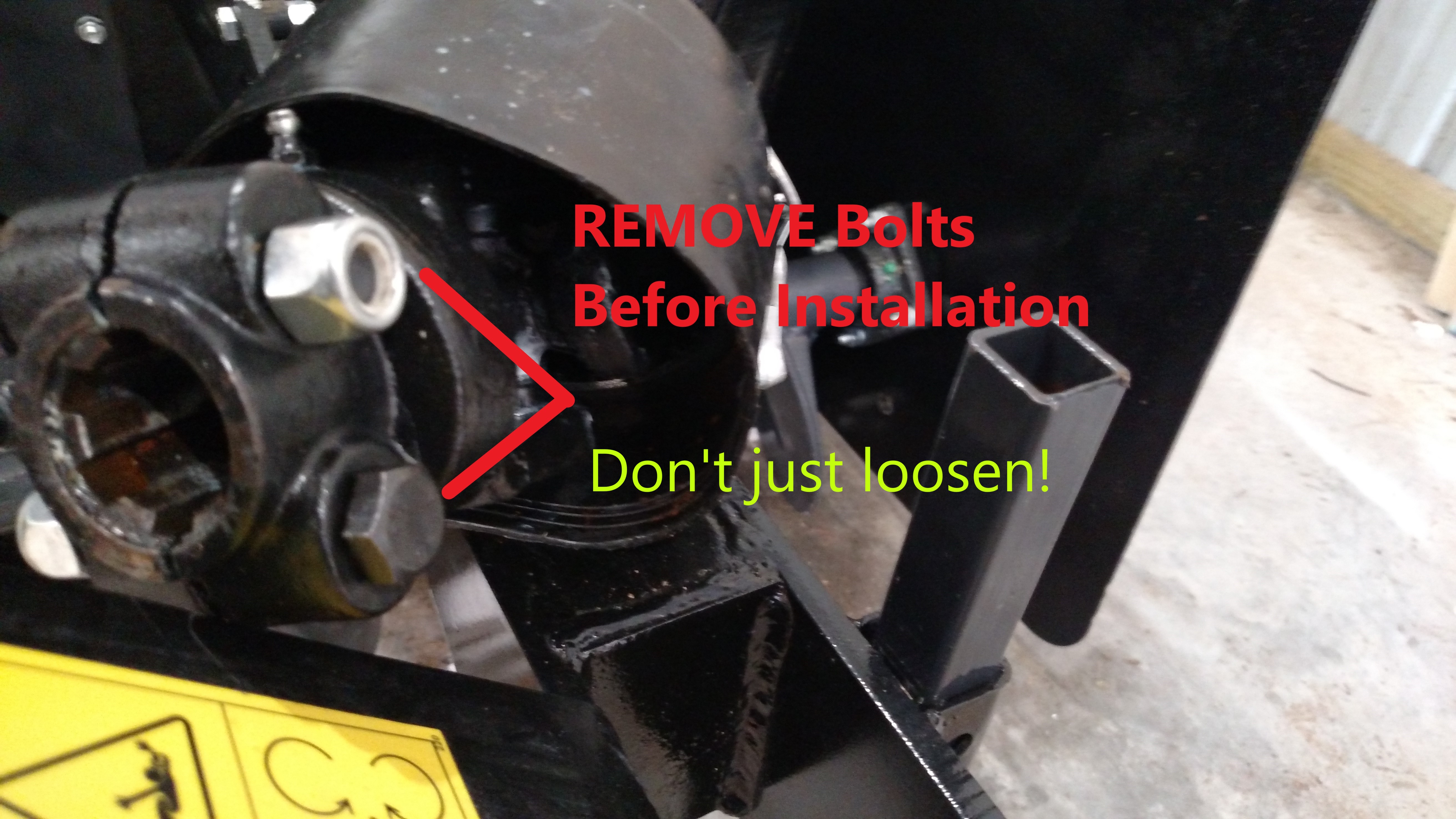

Now I am installing the last, and I thought easiest piece to my snowblower - the PTO. The tractor end goes on just fine. the blower side goes on about an inch and stops. My old one had the push button one on each end. This one has a slotted end and t bolts that cinch it down. I can still wobble it, but it won't go any farther. It is not in a handy place to get at it.
Any suggestions?
   / Rear Inverted Snowblowers 2019 #255
Hard to tell without seeing it. Does the blower end shaft have a slot with a key in it? If so you may not have them lined up properly or the key could have a burr on it that is preventing it from sliding into the slot on the driveshaft.
Got any pics of that shaft and the end of the driveshaft?

I'll get some pics. The shaft coming out of the blower is a standard PTO spline.
   / Rear Inverted Snowblowers 2019 #257
Does the driveshaft have a collar around the end that connects to the blower? If so that needs to be pulled back as you push the driveshaft onto the blower shaft.

Thanks to Hillbilly, and a DUH top me. Thanks, because I took some pics, and then removed the snowblower from the tractor for better pics. Then as a test, I put the tractor end on the blower and it slid on. Tried the blower end again and no-go. Then I took the clamping bolts out, and it slid right in! They protrude slightly so go in the groove of the PTO shaft to keep it from sliding out - DUH.
Here's how one decision can affect a series of events. It has been quite cold, and I was assembling this snowblower and lubing up my old snowblower at the same time. I took both PTO Shafts into my warm basement to grease. I should have attached the PTO to the blower when it was unattached from the tractor, but I had put it on th tractor to get it into my pole building. I thought this thing would just slide on, so that started my cascade of wrong decisions. The other thing is that is the heaviest PTO shaft I have ever dealt with.
