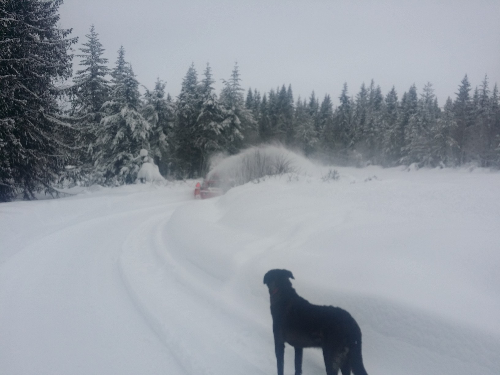

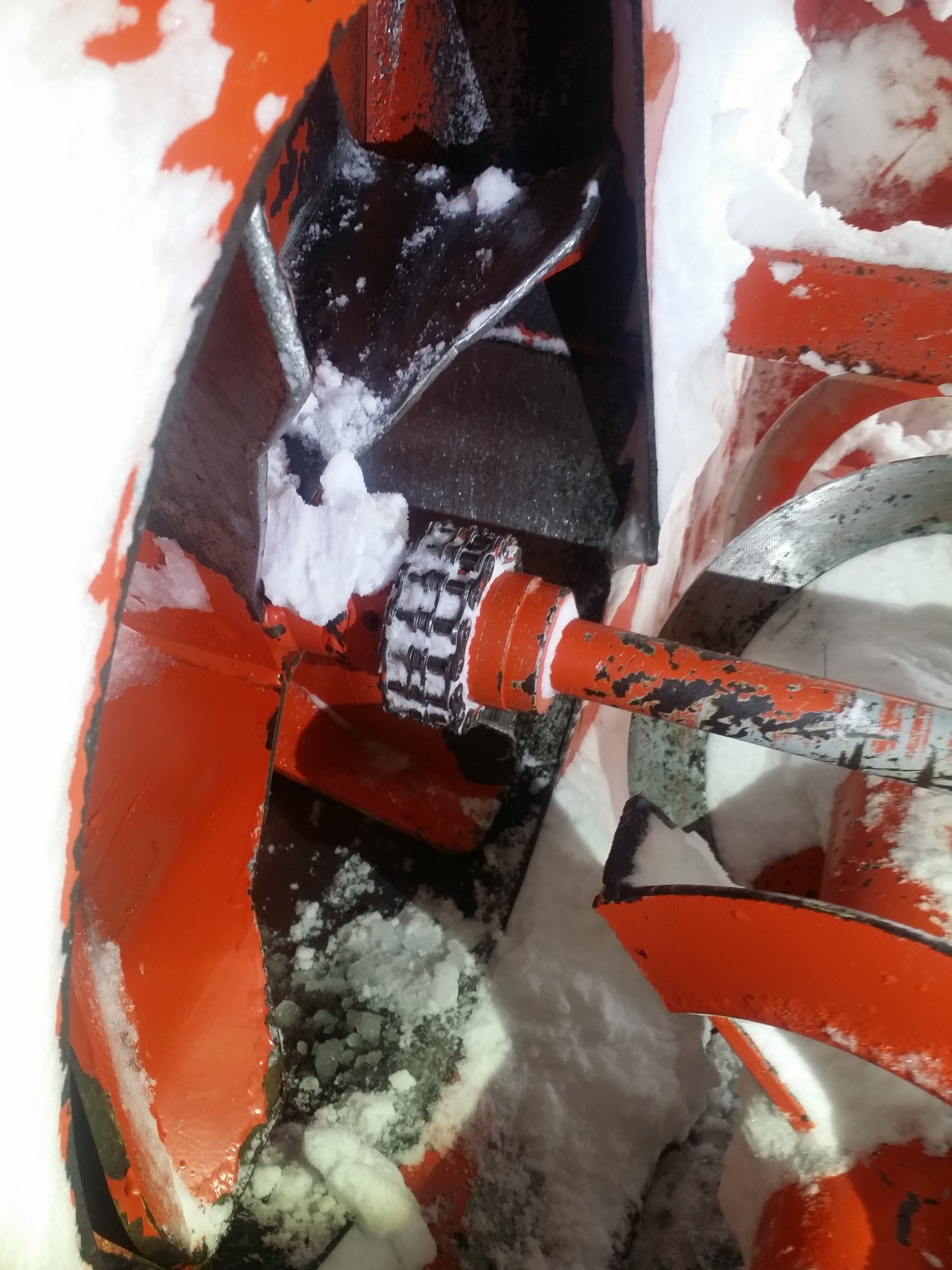

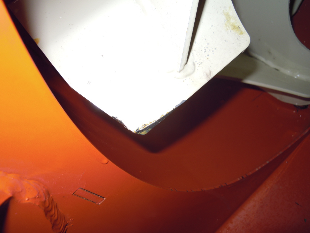

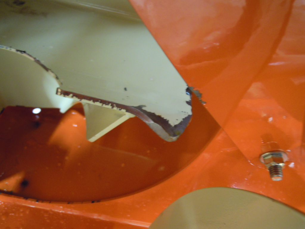

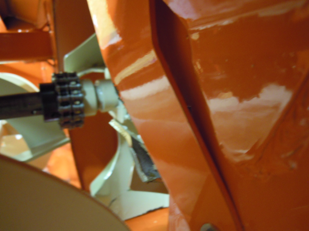

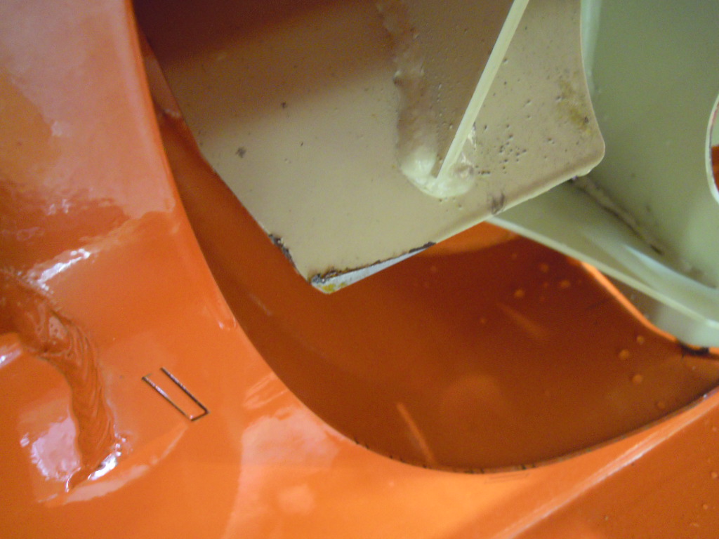

I finally got a video and photos of my blower clearing about 6" of snow this morning.
Also, here are a few of my blower fan showing the shape and bracing for the blades:
The back of the fan blades are quite well braced. The bottom of the plate that restricts the opening is bent on mine too. I need to straighten it. It has happened before but it does not bend the blower blades.

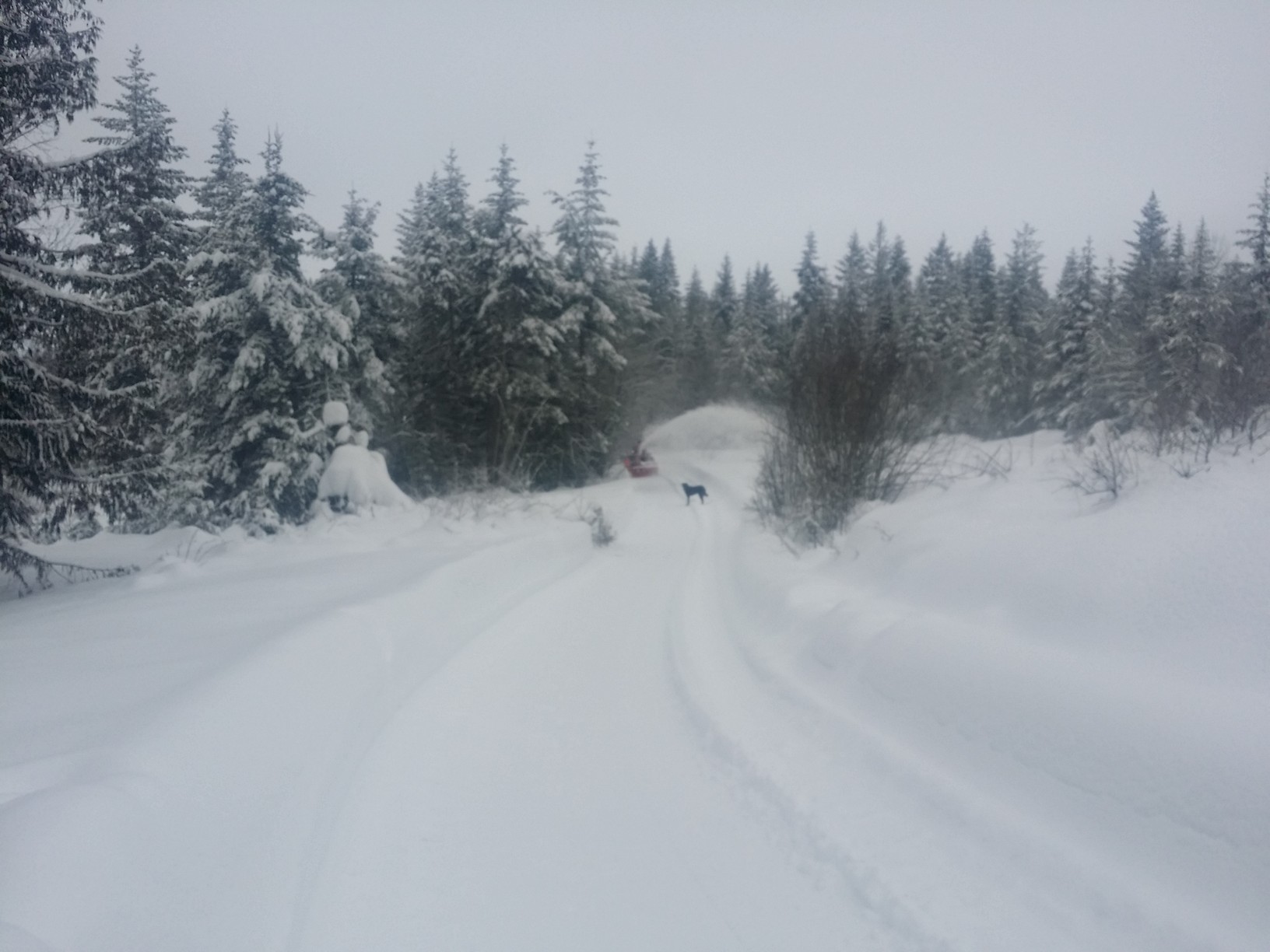

Here are a couple of photos of blowing snow this morning:
And here are links to a couple of videos from this morning:
20200111 Clearing Driveway 1 - YouTube
20200111 Clearing Driveway - YouTube
My dog was barking at his friend who came to see what we were doing.
View attachment 636578 View attachment 636580 View attachment 636579

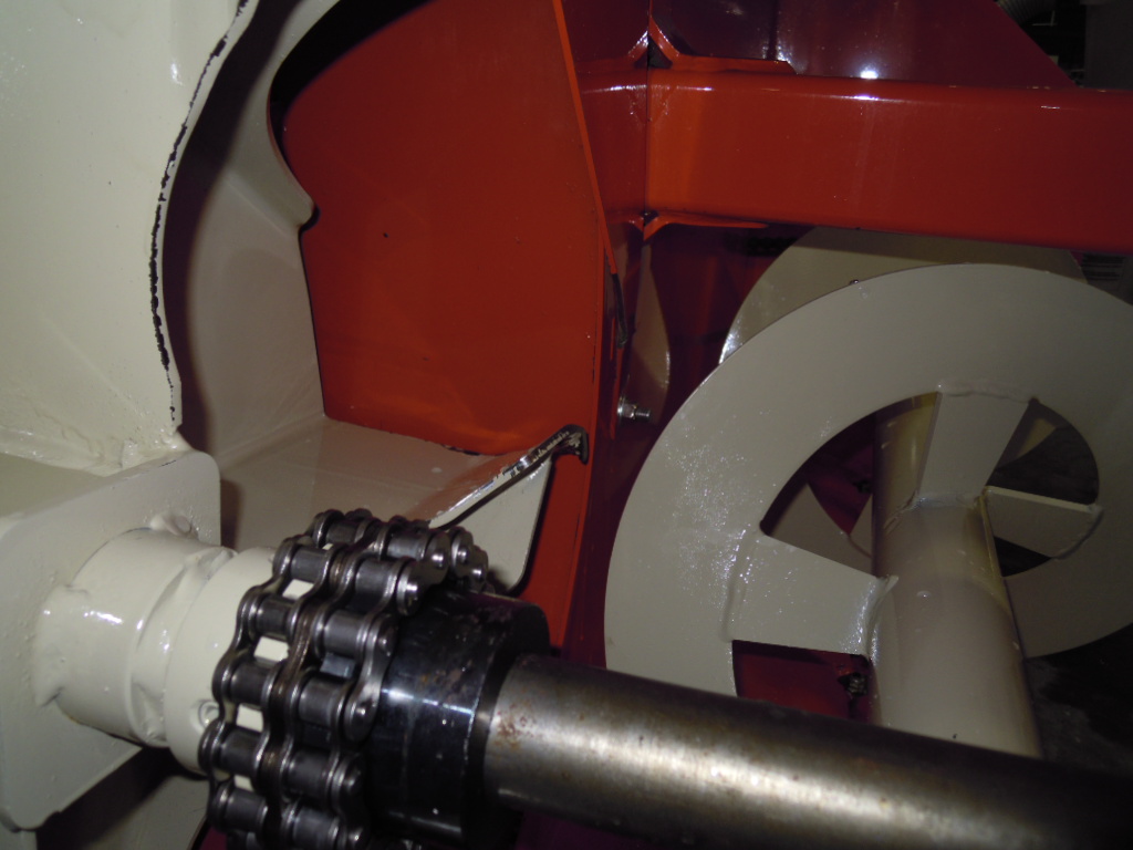

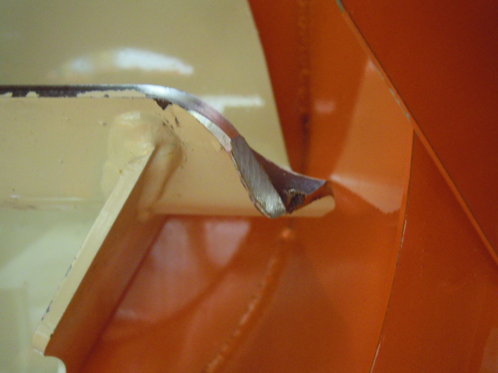

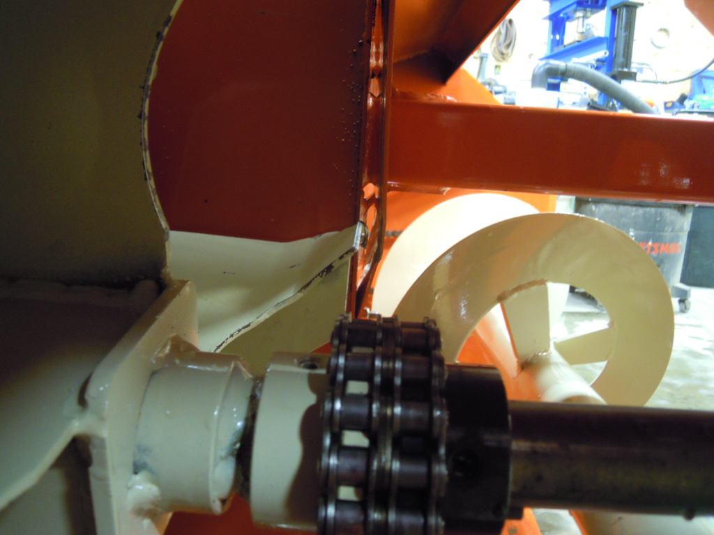

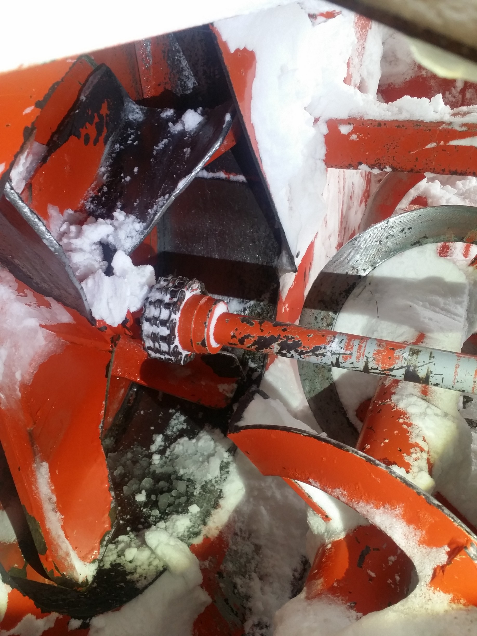

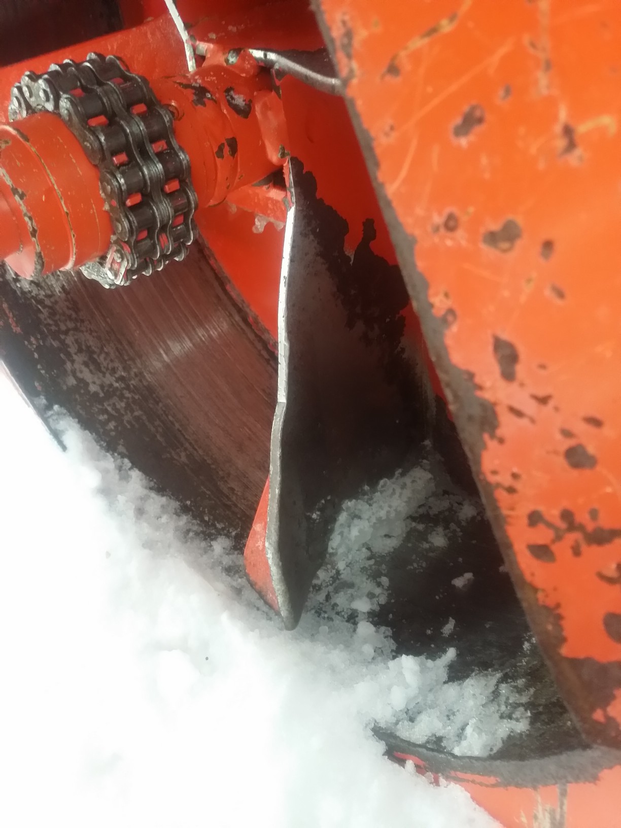

Here are some pics of my blower fan. 2 of the blades are bent back at the tips and the other 2 have been rubbing. It looks like the shaft that the fan rides on worked itself forward and eventually 2 blades hit the restrictor plate and bent it then the other 2 blades were scraping it as they went by. From what I can figure the retaining rings for 3 of the bearings on the fan shaft must not have been tightened enough which allowed the shaft to move. But what caused the shaft to move forward.
I moved the shaft back and tightened the retaining rings so I can use the blower until I find out what Farm King intends to do about this.

What's the deal with the double rollerchain? Is that a coupler of some sort?

So let us know how it works after your repairs. What would you consider appropriate warranty repair?
   / Rear Inverted Snowblowers 2019 #250
I think they should replace the fan and the plate. I could do it but don't want to because there is quite a bit of work involved plus this is a new blower. I shouldn't have to do any work on something that is new. It might have 1 hour on it.
