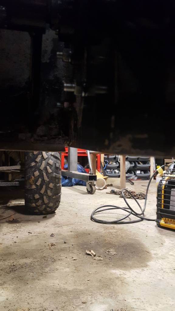

Thank you Leonz for the insight and compliment. The layer of snow left behind on our driveway is like a polished ice rink. The hills are treacherous. A few nights ago I had to spend an hour getting the idiotic UPS driver off my hill at 8 oclock at night. He chewed up all my nice new sides. And the mailman lost it on another hill. UPS guy is a fool for not recognizing that a rear wheel drive vehicle with no weight at the end of his shift would climb a hill that was white. I know because I drove a UPS truck for 22 years.

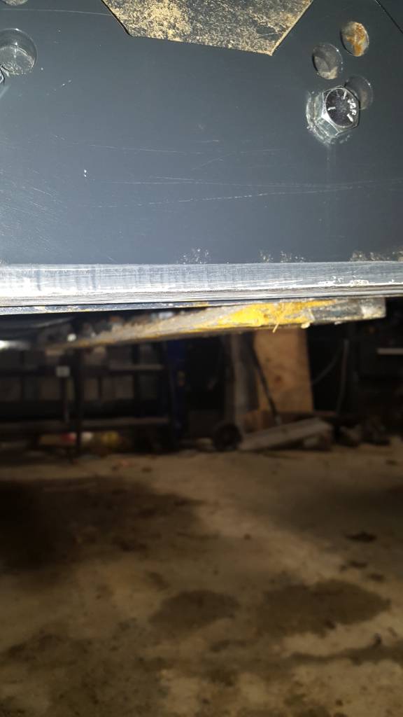

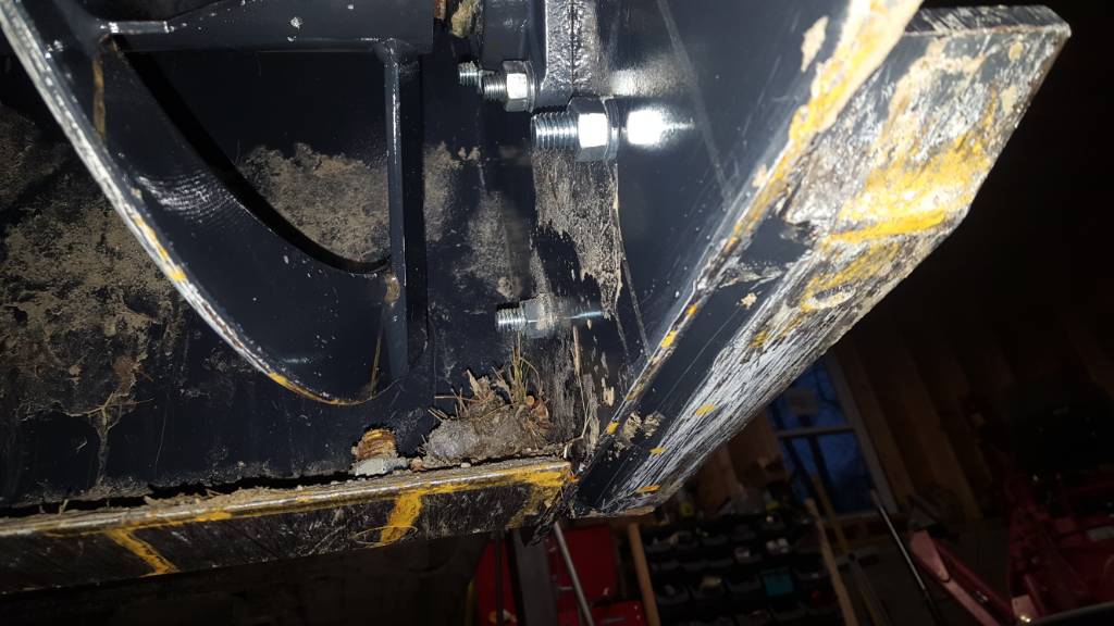

Looking at the last set of pics, I can see that the shoes are adjustable but they are as high as they can go with the current setting. Another thing you could try is to unbolt the Tyvar skids from the shoes or remove the shoes. Then the whole blower weight would be riding on the cross slide. Just have to be careful that the skids don't end up hitting the pavement, when the cross slide wears down.
   / Rear Inverted Snowblowers 2019 #145
As Hillbilly said, the Tyvar skids are so thick they are holding the blower up. You can either take the Tyvar skids off or drill some extra holes in the sides of the shoes so the blower will sit lower in relation to the skids.
If you drill the extra height adjustment holes, follow the same pattern that they have now and go down 2 more holes. That should give you about an inch more adjustment which should be plenty. You probably only need a half inch though.

On the next snowstorm, try removing the skid shoes altogether, so that all the weight of the blower is on the cutting edge. Just me mindful that the steel sides of the blower aren’t digging into the pavement.
This will certainly increase the likelihood of getting the results you want.
If it works, then drill some new, lower, holes in your skid shoe mounting brackets. Or even better, have a machine at cut out a long, vertical section of steel connecting all the holes (so you have infinite adjustability rather than signal adjustment holes) and adjust the skids so they are slightly higher than the cutting edge.
