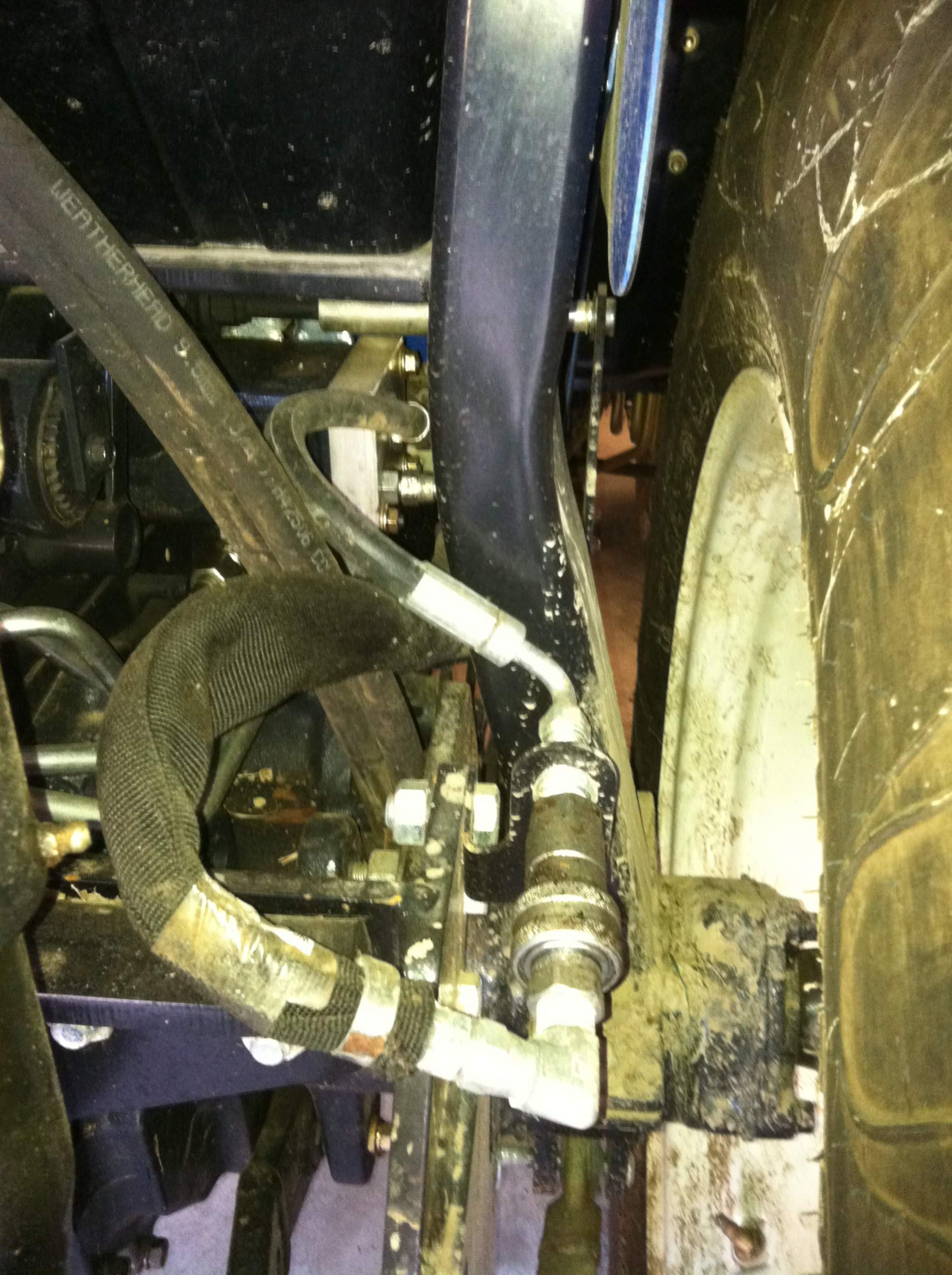

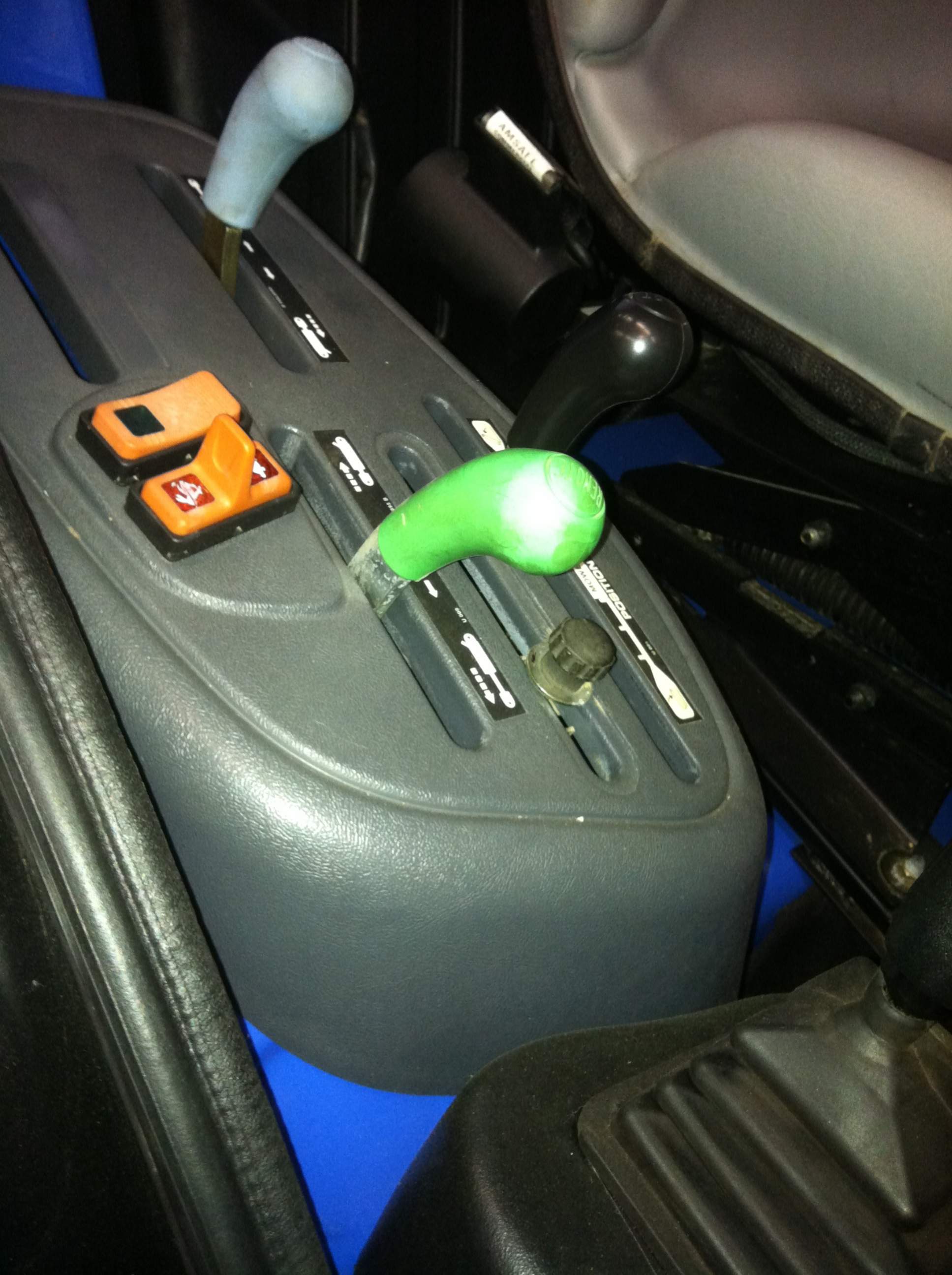

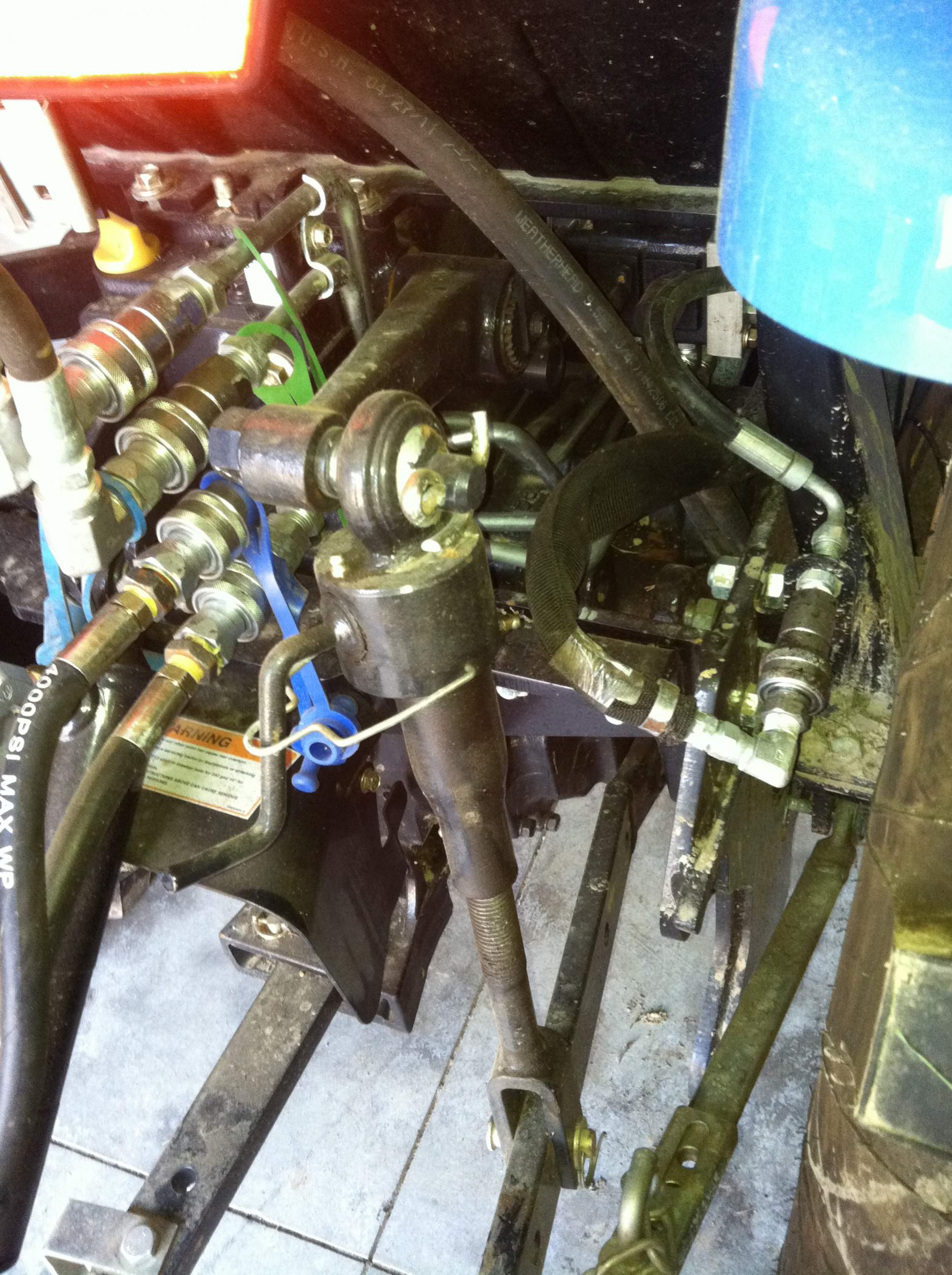

No levers to activate. The photo explains it. When the BH is not connected, the power beyond flows back to Hydro tranny case. The connections are jumpered together when the back hoe is off the tractor like you see in the photo.
The Green lever runs my grapple, the blue lever controls the top link.
I can use those same Back Hoe connections for a log splitter that uses the tractor hydraulics and as long a the valve is set up for power beyond. It will plug right in without effecting the Hydro tranny, grapple or top link operation.

I don't see a photo. I knew you had to do something like use a jumper to reconnect the flow. That is what a lot of people are doing instead of a remote valve to run log splitters, and BH.
/ Rear Hydro Valve Question #7
Sorry, it took a few minutes longer to get it uploaded. Hopefully the photos help. I must say, I really like the entire remote hydraulics arrangement.
The direct connection for the BH helps eliminate additional heat from passing through a valve.
At first I thought the Grapple control might be inconvenient but after having it this way, I really like it. In some ways I believe its better than mounting additional valves on the FEL and buttons on the joy stick.

RFB, The one set in the photo that are jumpered together are power beyond remote access outlets. I like having them on the rear for easy access. I had a Ford that I had to crawl underneath below the FEL control to hook up thevback hoe. Not much fun in the winter.
