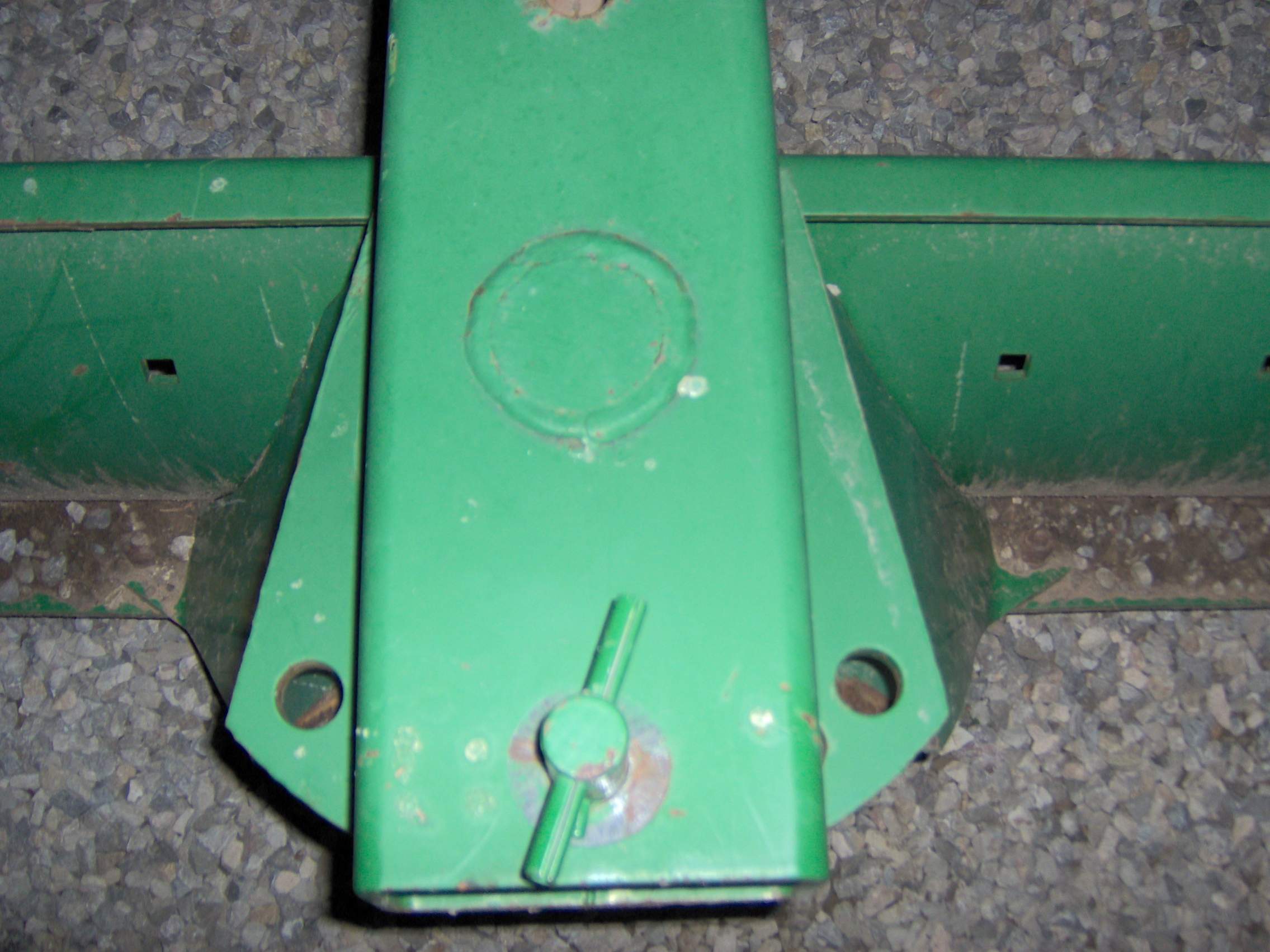

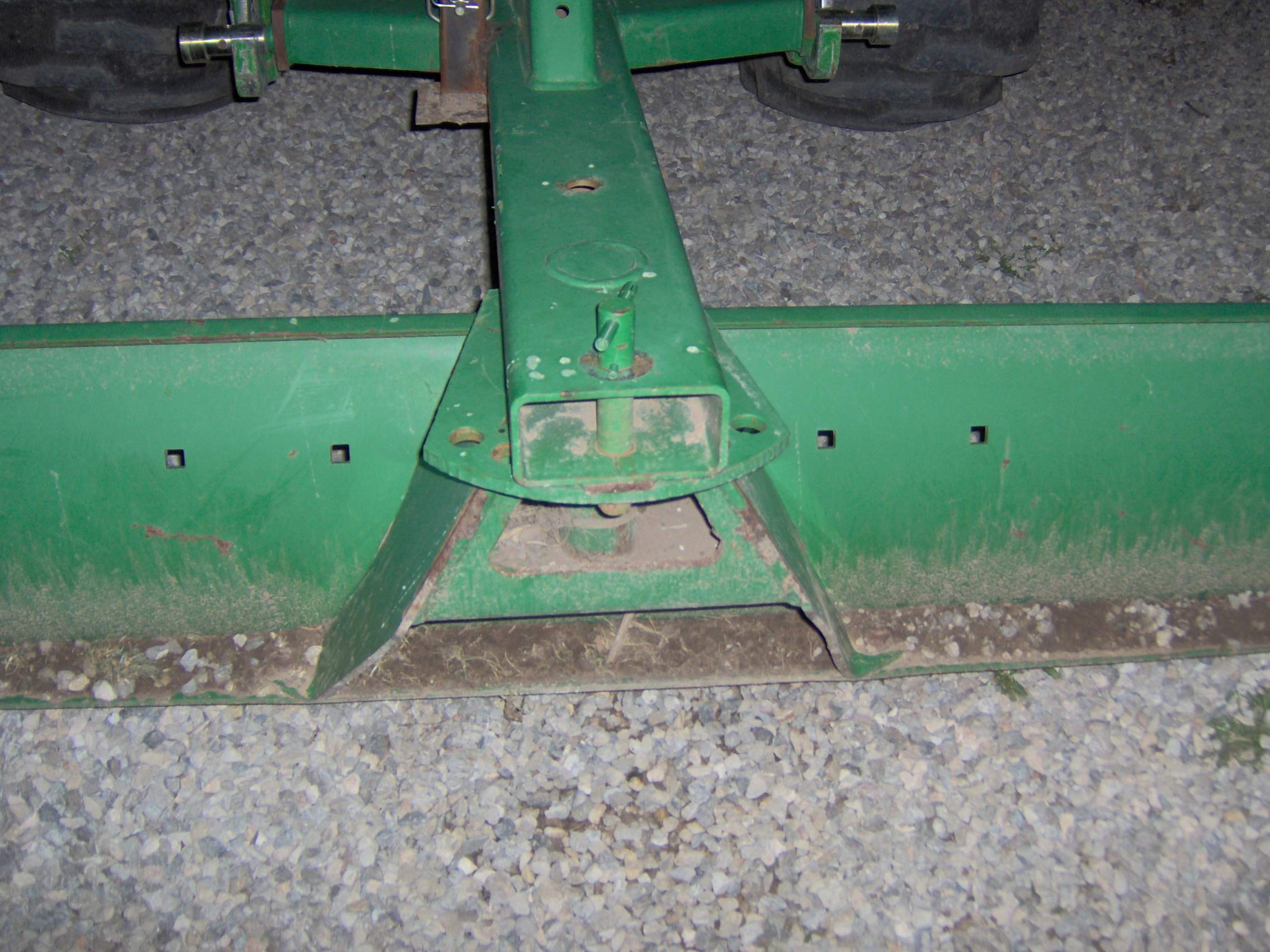

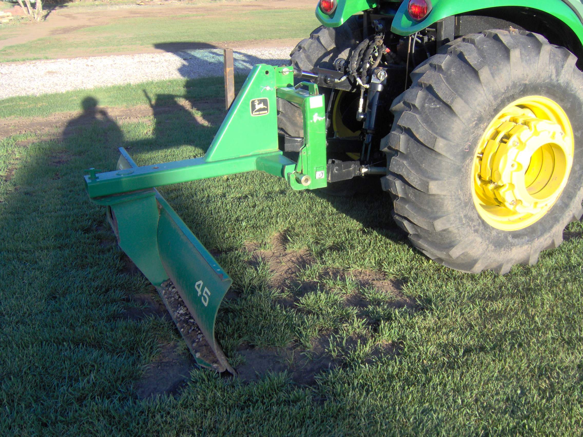

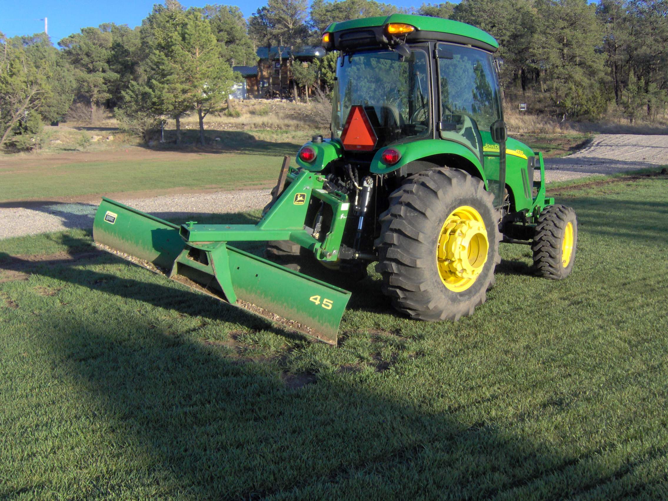

How soon do you need a rear blade? I may sell mine and get a full hydraulic heavy duty model. I am in Ruidoso so not that far away. No bends or warped edges everything is straight.
Does that one provide for offset?
Yes it has extra sets of predrilled holes to move the blade to either side. At 7' wide it should work well for the OP.
I have a borrowed blade currently so there is no hurry. I like your blade, looks heavy duty enough for my needs! I see that it can be offset but I'll need to add the "rotating" feature. Looks like you got the TnT feature, I'm so jealous!! Someday I'll get mine from Brian............
PM me with specifics and let's see what we can work out.
