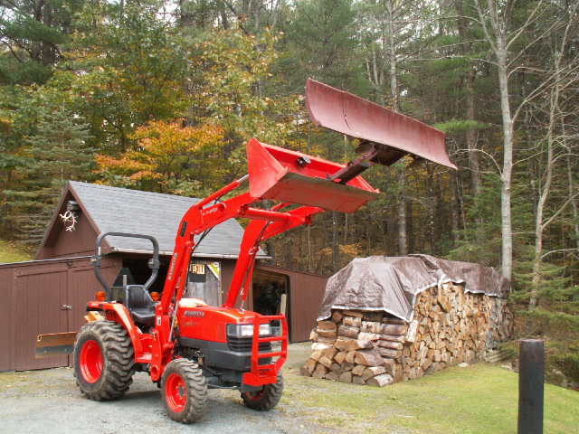

Sixgun.
"Rear blade and FEL has worked fine for me for the last few years, though I'm thinking of adapting a front blade on my B2710 over next summer."
Twice the fun in half the time:)..and you can really pile snow.

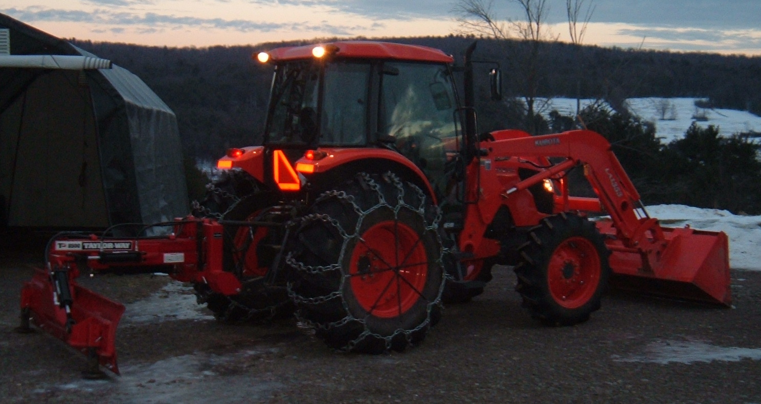

Nice looking rig! That's pretty close to what they use around here on the county roads. Only difference is they replace the loader bucket with a highway truck plow. The rear blade is used to help clean intersections.
i always go forward with my rear blade. the hydrView attachment 148557aulic's help alot though.
