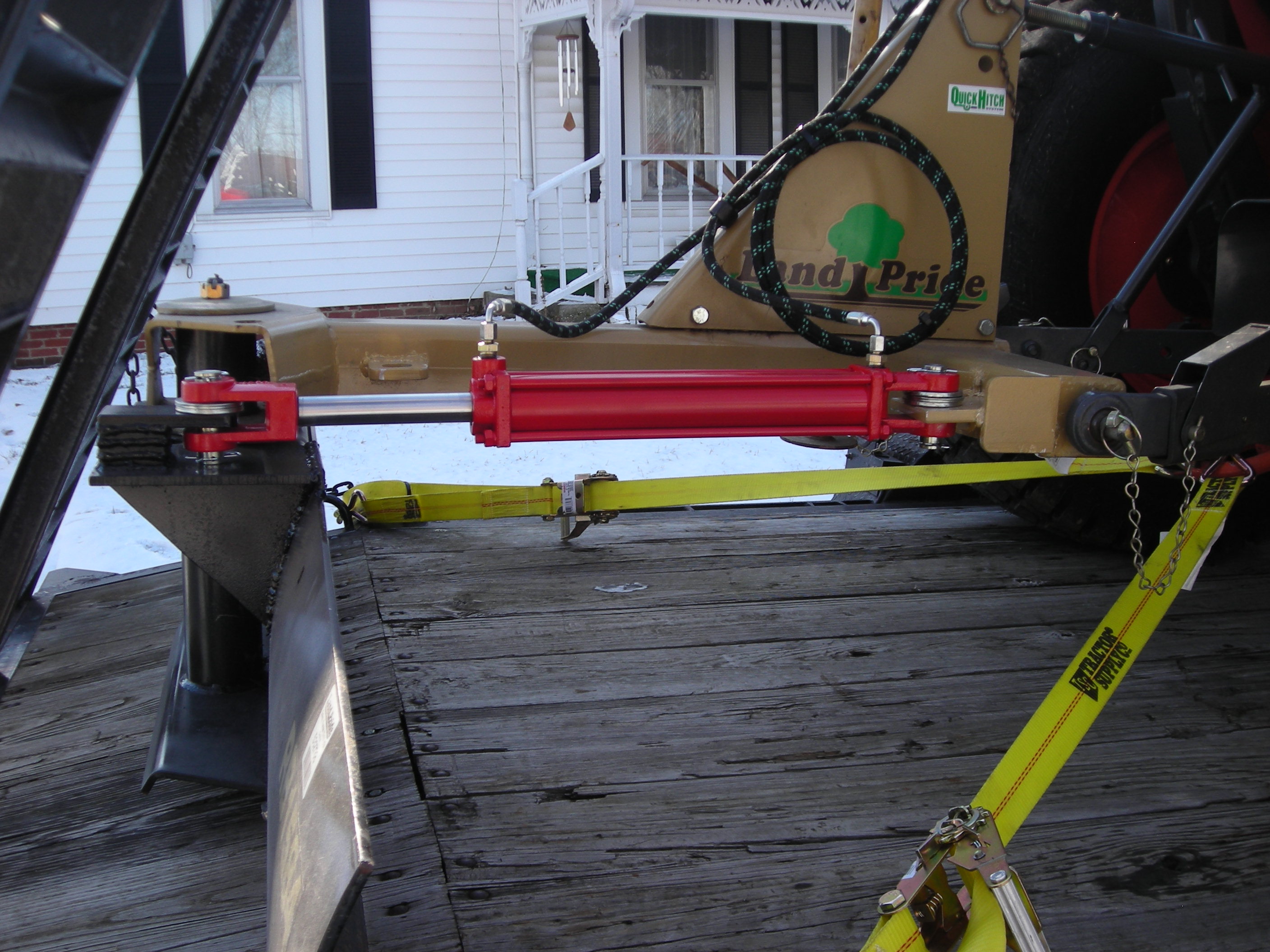

I have a Land Pride RB1584 7' back blade for my L3940. Our tractors are the same width, and when angled, covers the rear tire width nicely. I would not go smaller or larger than a 7' blade for our tractors. I have hydraulic top link, which is nice for hooking up and adjusting dig angle. I also added hydraulic angle to the blade myself with a few pieces of metal, welding, cylinder, and hoses. Now I never have to get off tractor! Philip.
