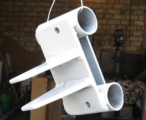

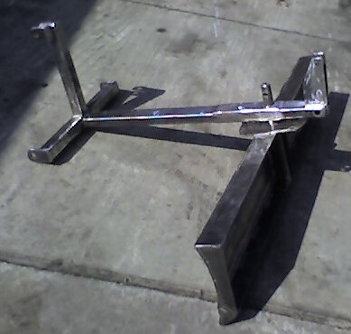

This past fall I decided that my hobby needed to generate some income to pay for itself. With winter coming I thought that I should be able to do that by making a RB to plow snow for businesses and people here. That was my plan. But you know that while I read of all the snow in the States and the difficulties with the severe winter weather--we did not get any snow to speak of.:mad: So much for my income hopes! But this spring I decided to finish my project and to post my most modest efforts for your amusement,:rolleyes: or encouragement.
Those who remember my past threads know that implements for small tractors here are hard to find and generally expensive. So that is what prompted the build.
In order to make it truly economical I checked and found that I had most of what I would need in my scrap collection. I did need to get the main blade piece. I had it rolled to get the curve and I cut off the straight edges from the rolling in order to made the offset for the cutting edge.
I also welded a straight back for the blade and triangular braces down on the cutting edge as my plan is to use this for more than a blade for snow.
I want to use this with a metal cutting edge for dirt and a rubber edge for snow so I made a template which will double as the retainer for the rubber edge. I also want to have gauge wheels on it for super smooth finishes, so that had to be taken into account at the beginning.
These first pics are of the 3pt frame and the blade. More pics will be forthcoming as I finish things.

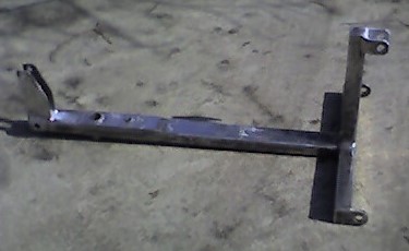

The frame and 3 pt attach I was able to build from scrap that I had collected.:D I had to weld the tubing together to get the necessary lengths, but they worked and I think that they will be strong enough. I could not find material to get as tight a fit on the pivot pin as I would have liked, but I believe that it will be adequate for now.
The "F-18-hornet" double tail fin is for the gauge wheels that are in the works. I know that there is no extra bracing on the square tubing of the 3pt mount, but this tubing is fairly heavy wall and I believe that it will work without bracing. Maybe I will be embarrassed!:eek:

Nice looking blade so far. Some ideas I would consider to "beef up" the blade would be to weld gussets to the 3pt frame and the arm extending to the swivel point. Also, I don't know what the terrain is like where you are planning to clear, but if you catch the corner of the blade on a rock, There is a good chance that you will bend the post at the swivel. I have DESTROYED blades before just because I wasn't careful around that unsuspecting rock sticking up.
/ Rear Blade build #4
Looks great so far, and I like that you wire brush all of your steel too!
I agree with Joe about adding the gussets to strengthen the whole assembly. The tubing may be heavy wall, and you may have good welds; but those are still hinge points that will be the first place the implement will want to fail.
Keep us posted with pictures.

Thanks guys. I know that you are right about the braces--I actually had one for the verticle toplink mast, but did not like it so I took it out. I will add something there--at least a gusset.

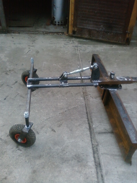

You are doing a great job on your back blade. Here are some pictures of my tractor when new and the back blade when new. I made it for my Dayton (MTD 990) tractor over 25 years ago. It has a Cat. 0 hitch. It will rotate right and left front and back 0,15,and 30 deg. I even added a removable scraper plate. It also has a grease fitting for the turning section. I use it all the time to clear snow in winter. It works great on loose soil and gravel.
/ Rear Blade build
Thanks guys for the encouragement. It helps to finish a project when you think that others might enjoy seeing your work and share in your triumph or failure at least vicariously. I know that is true for me as I see your masterpieces.

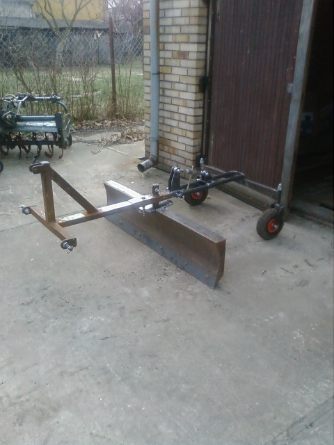

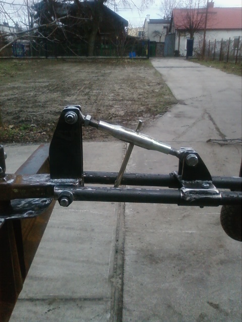

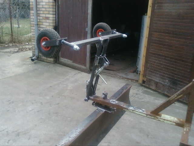

I finished the gauge wheel setup so that I could "test it out" on our parking area. I had smoothed it as best as I could with my BB but it was not where I wanted and I could not get it better so I decided to finish the gauge wheels for the RB.
Since they will not always be needed I made a way to raise them past vertical so that I could get as close to a building as possible. I used a sliding rear bracket that can be pinned in the down position or in the vertical position. Theoretically I could put more holes in the bars the make the frame and pin them in any position, but I could not think of a reason that it would be necessary.
I wanted to be able to spin the blade around so the wheels had to be a distance from the blade. The side benefit of that is the better "grader effect." The draw back is that the thing is so long. You really have to be aware or you will smack something when you turn sharply.
They also needed to be adjustable. I accomplished this in two ways; 1) I put a CAT 0 toplink that I was sent by mistake in the place where others could have placed a hyd cylinder, 2) I used washers for spacers for side to side fine tuning.

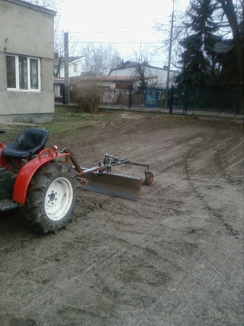

Well with it all together I just HAD to test it out on that rippled parking area.:rolleyes:
Overall I was very pleased with the result. I am working with fairly easy material (sand with some top soil) with NO rocks so the little slop in the pivot was not a problem. Some day I will take the time to make it tighter.:rolleyes:
I was pleased and gratified that the wheels help make it so much easier and faster to get things looking very smooth. :cool:
Now I have to clean things up, make some proper pins and retainers, and paint it.

I am determined to figure out how you all post those tiny linked pics. I noted that you are using photobucket so I opened an account there and we will see how it works.
I was frustrated because it would be clearer if you could make comments and attach pictures to illustrate the explanation. So I am going to try to do just that.I finally figured out that a search on "thumbnails" got me the necessary info. Thanks to Jake (Grrrr) and Rob (3RRL).
What I think is unique about my build is not the blade itself--well I want to make a rake that will fit here too and therefore get double use of the frame and gauge wheels, but rather the gauge wheels and the control for them. There are times when getting them up and out of the way is beneficial--loading on a trailer, storage in your garage, working next to an obstacle, or simply knocking down a pile of material.
The method that I used to gain this versatility is a rear bracket for the adjusting link which is pinned in place on the structure bars. The wheels can be pinned up in two positions, but I prefer the "over center" position as it allows almost the same clearance as it has without wheels.
In this way you can change from the stored position back to the working position without loosing your position setting. Establishing the setting that will give you a smooth finish takes a bit of on/off the tractor.:(

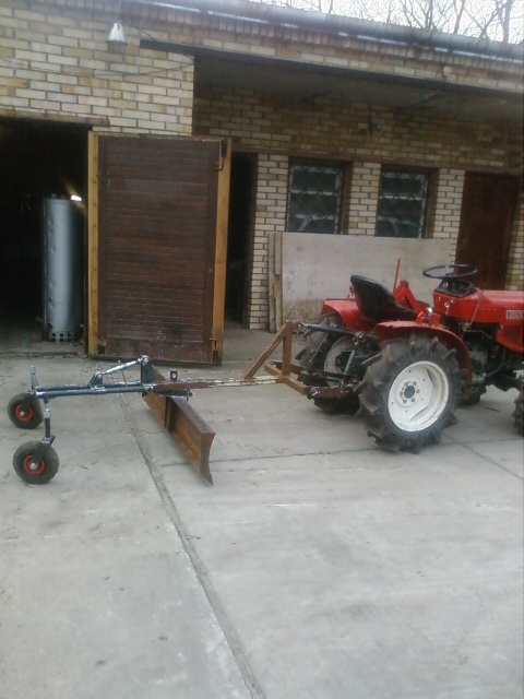

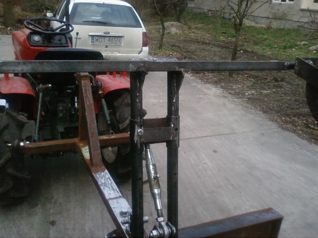

We had a couple of beautiful spring days here this past week and I had an afternoon free so I decided to make a couple of small mods and paint the blade.
I did not have enough of the Yanmar Red that I had mixed last summer left to do the whole job, so I opted to paint the blade the paint that I got to match the Yanmar chassis color--it was a bit darker than I expected and is not a perfect match. It seems to be in the same family, but is too dark. Oh well it still is paint and it covered the steel.:(
My modifications were to put in a diagonal brace for the top link post and to move the blade indexing plate closer to the main boom. I had bent this pin before and I wanted to shorten the length necessary for the pin to reference the blade. I will make a harder pin with a handle, maybe this week.

Since the RB was not made to be a lawn ornament, I decided that I needed to get it dirty. I am building up the area in front of what will be my work shop and had thrown some broken up pieces of concrete into the area that I wanted to build up. I then took my scoop and hauled in a few loads of sand. Then I planned on using the blade to level it all out.
It was not a complicated or highly involved sort of thing, but it was a project that would get it dirty. Of course if I hooked one or two of the now hidden chucks of concrete and bricks I could expect a scratch or two. That would be a good initiation and get it past!
I did manage to snag a couple of chunks and put a few scratches on the blade so I am in good shape now.:rolleyes: One of the things that this project highlighted was the ability to get in close to the building with gauge wheels folded up to the maximum. I am able to get about 6 inches from the building and that saved that much shoveling.:D
After I got it roughed out with the blade, I dropped the wheels for some finish grading. It came out fairly well and I am very pleased with the performance of the blade. I would still like to make a rake for it and I will when I find the springs that I need. It gives me an excuse to cruise the metal recycling places.:rolleyes: I forgot to take some pics of the finished result, but the whole thing is not totally finished. It is an on-going project.
