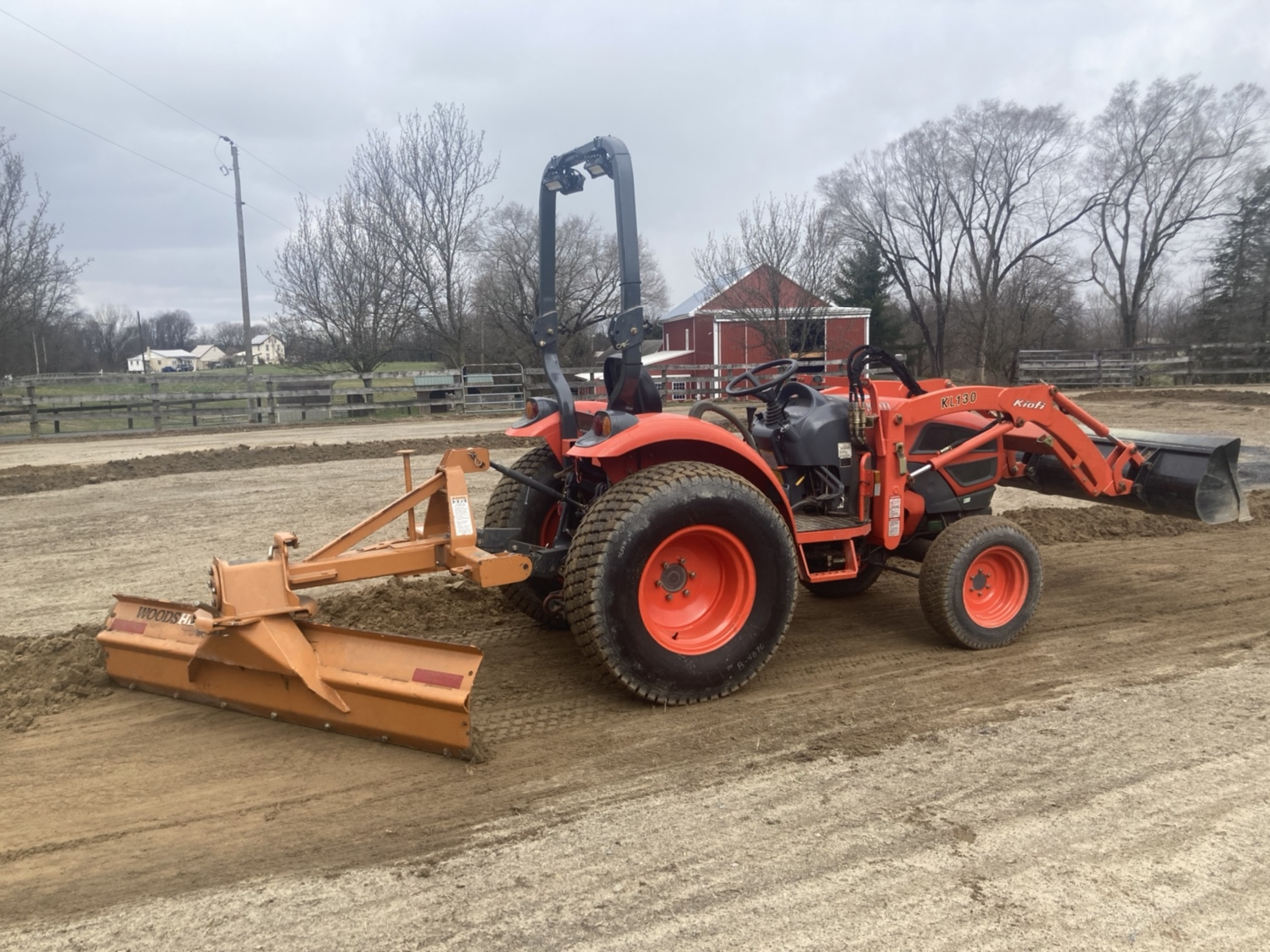

I borrowed on old 7 foot blade that only angled, it was pretty light but worked well scraping the footing in the arena. So then I bought a Woods 7 footer last week and find it too heavy for my uses. Not only does it feel really heavy when transporting (manual says it’s 565lbs), it digs in too much in the material I’m moving. I have to adjust the level constantly, can’t let it float like I could with the lighter blade. Also, the lower lift points are really high so I had to adjust my lift links and it still scrapes on inclines. This blade would be great in harder material, but my uses are loose material and light snow so I’m going to get a lighter one. Live and learn.
View attachment 739337View attachment 739338View attachment 739339
Maybe try rounding off the cutting edge a little with a angle grinder? Or just run it backwards?
For just a general smoothing in an area like that, back dragging with the loader is good and just adjust the bucket angle to suit, or an atv dragging square of chain link fence with a fence post or two on top.
I also find running a boxblade backwards with the tilt adjusted with my hyd toplink is very good for smoothing out loose gravel without moving too much of it.
