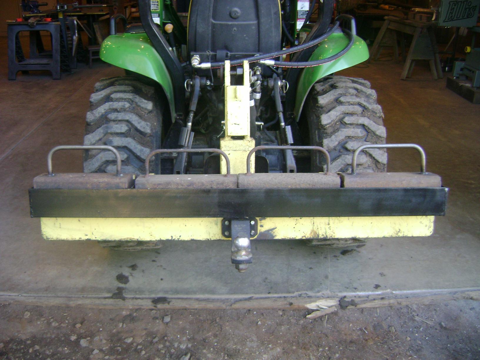

Anyone have a simple way to calculate weight of a hunk of concrete based on the type of concrete used and any aggregate added to it? I'm wanting to construct a rear ballast for my SCUT for use when I don't have the backhoe mounted. I figure I can build something cheaper and more versatile than shelling out big bucks for suitcase weights since the needed weight will pretty much always be the same and I can incorporate a 2 inch receiver in the design for moving trailers and whatever around.
I figure I can weld up a frame that can be attached to the 3pt with some scrap and then embed this in the concrete. I did something similar for a JD 212 I have that just bolts onto the rear and it worked out great, but what it would weigh when finished was a WAG at best. Frankly, I still don't know what it weighs, but I know it is heavy enough that I ended up laying on the garage floor for a couple hours waiting for someone to come home after I felt something in my lower back pop loud enough to be heard when I was just trying to roll the thing. Heck, I even thought of just making some kind of bracket to hang the weight I have off the back of the SCUT, but it's not an easy on/off the Deere and the Deere gets used quite a bit in situations where the weight comes in handy.

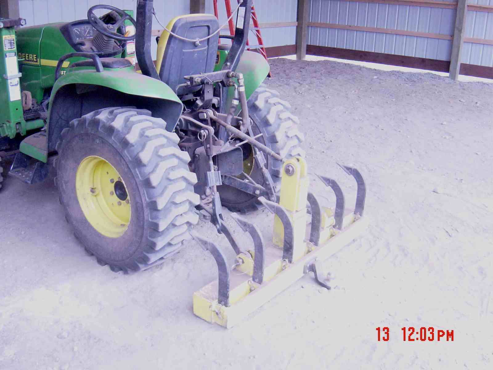

When ever I build something I like it to be multipurpose. I built this ripper, out of some 5 1/2-inch square stock. Then later built a bolt on angle iron frame to add more counterweight when needed. So far it has worked out real well for my small tractor. ;)

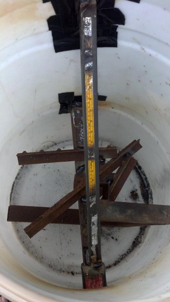

1209189_10200967184360322_1801564235_n.jpg1232649_10200967343604303_646587806_n.jpg1082713_10200967184080315_370065550_n.jpg

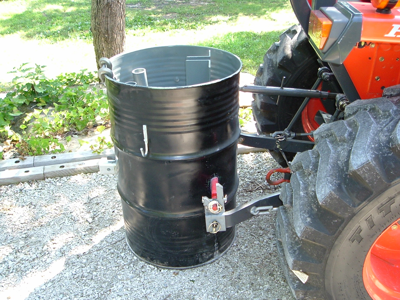

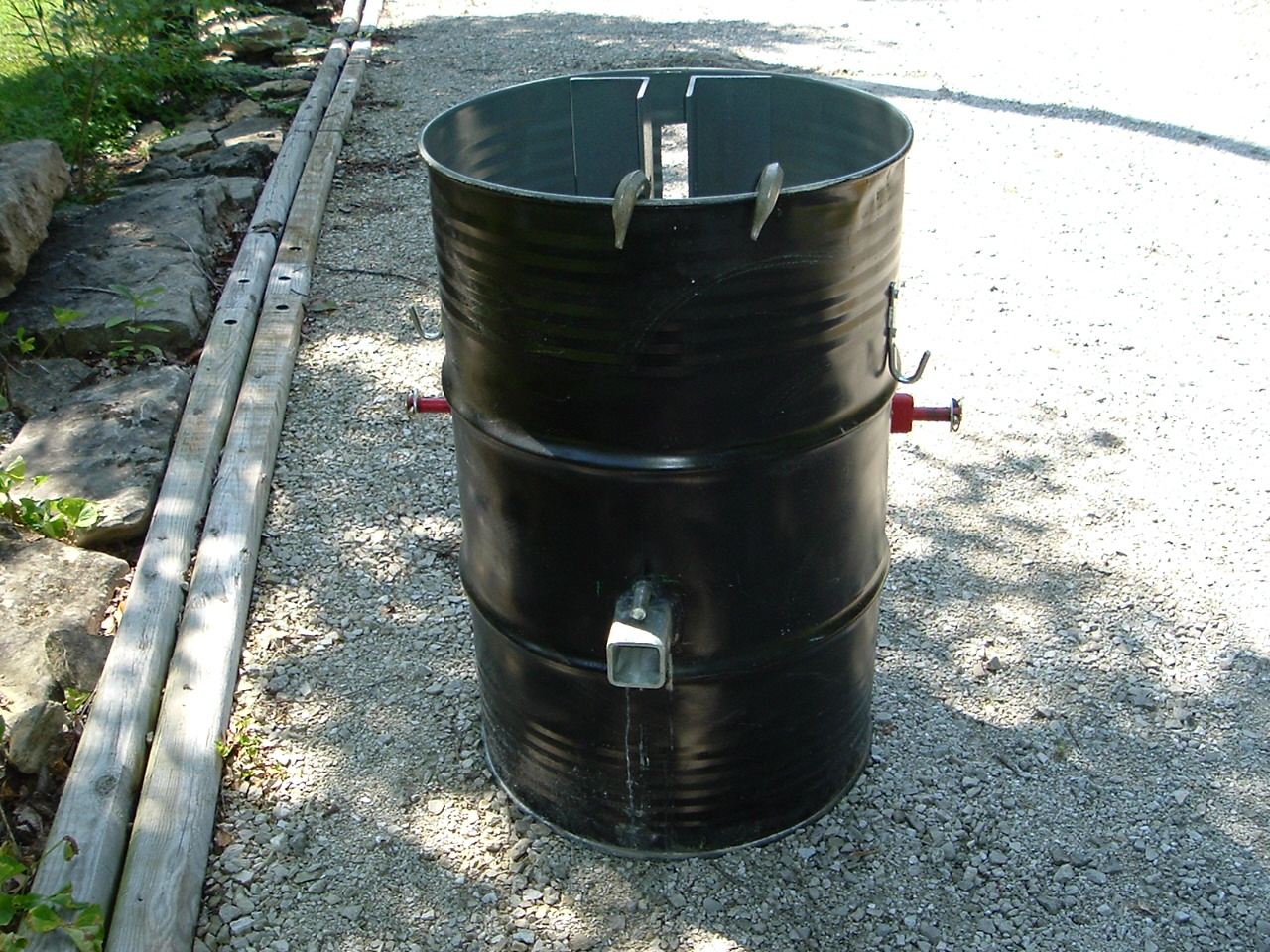

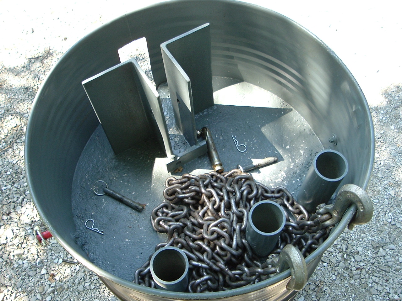

I threw this one together the other day now just waiting for the concrete truck to show up at the new house across the street for some leftovers (hopefully). All that jumble of stuff inside is my version or rebar.lol
I did add a couple pieces of pvc pipe to embed and use as a tool carrier.

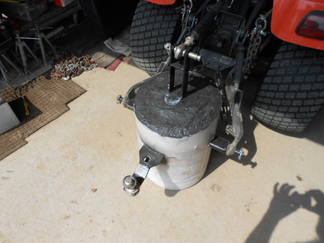

Made this one a few weeks ago, was able to use it today. Sure helped! balast.JPG
320lbs of concrete + 25-30lbs of steel.

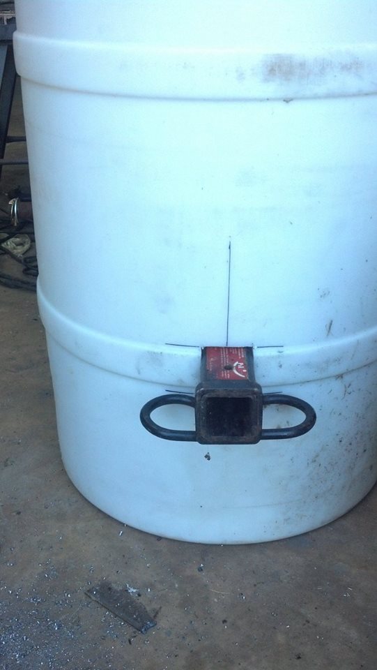

1231271_10201050316878583_2072684072_o.jpgI can tell you for sure that a B2620 cannot lift a full 55 gallons of concrete, but it can lift this much.
I filled mine and then had to shovel it out until i could pick it up hanging off a quick hitch.
