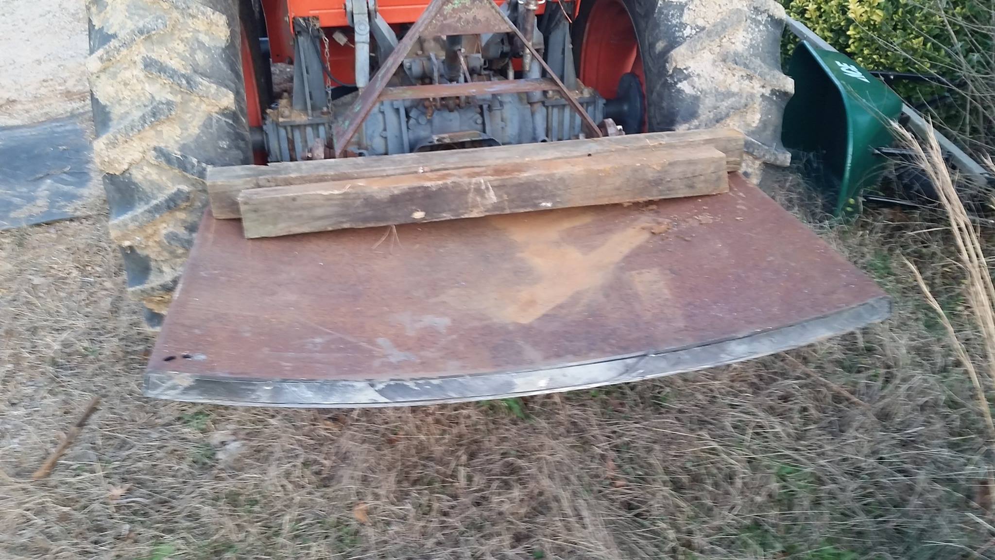

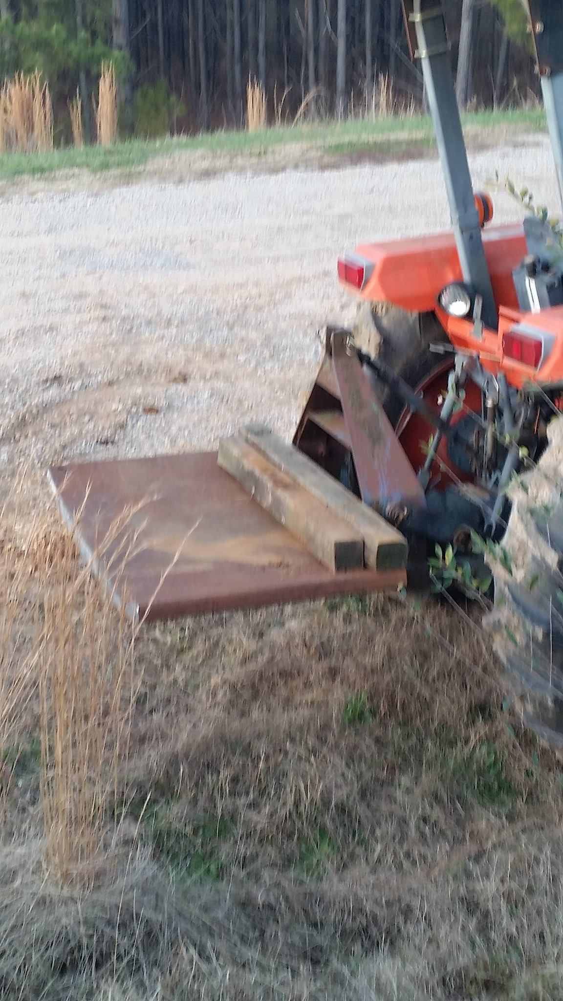

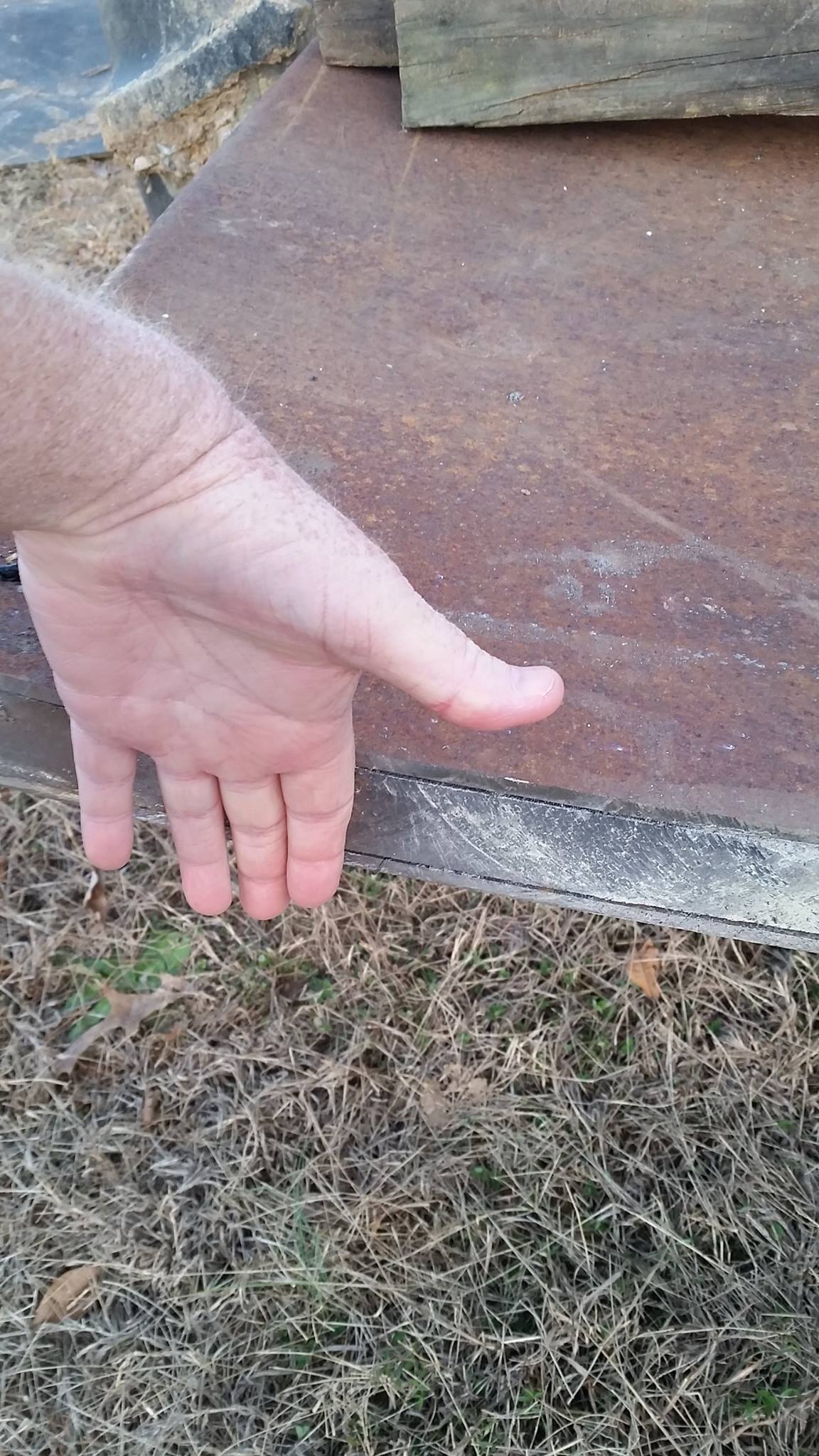

I took the easy route, but had 48,000 lbs of lead. These pics only show one piece, added one more after the pics were taken. Also had to replace that carryall this year. After moving 300,000 tons of limestone. It fell apart, bought a better one. Then drilled 1/2" holes dropped 2 long bolts through the bottom piece. That keeps it from moving. The 2 pieces weight around 2000 lbs. I buy my heating pellets by the trailer load. Use this to allow me to unload the ton pallets of pellets.
