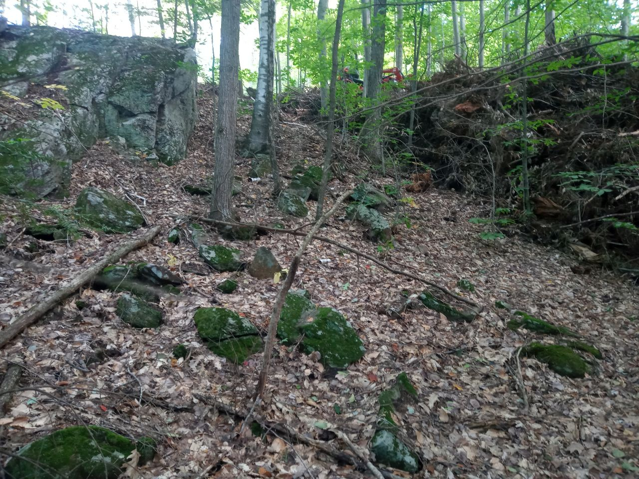

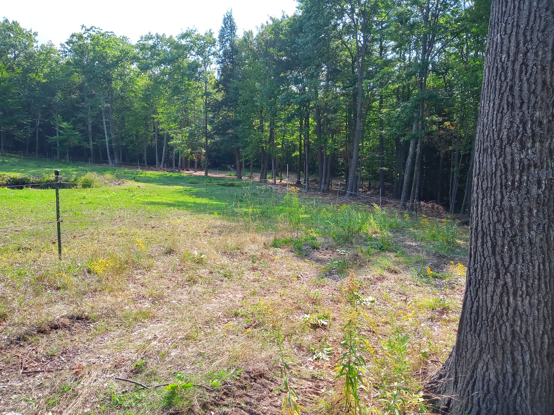

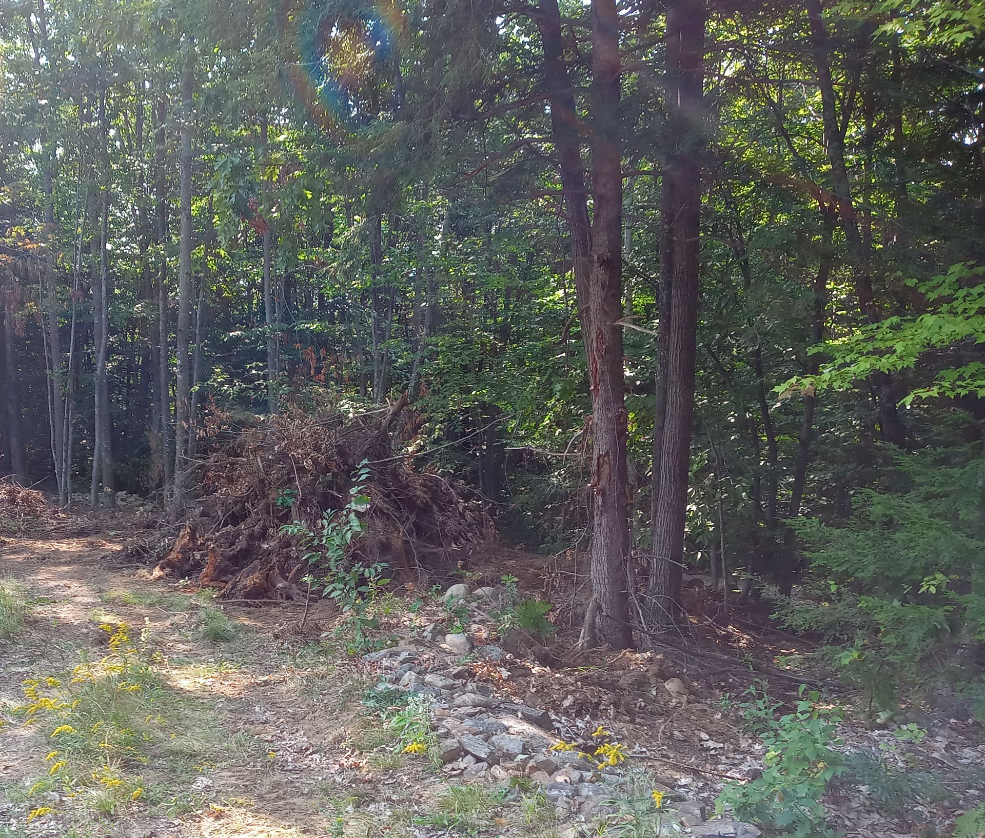

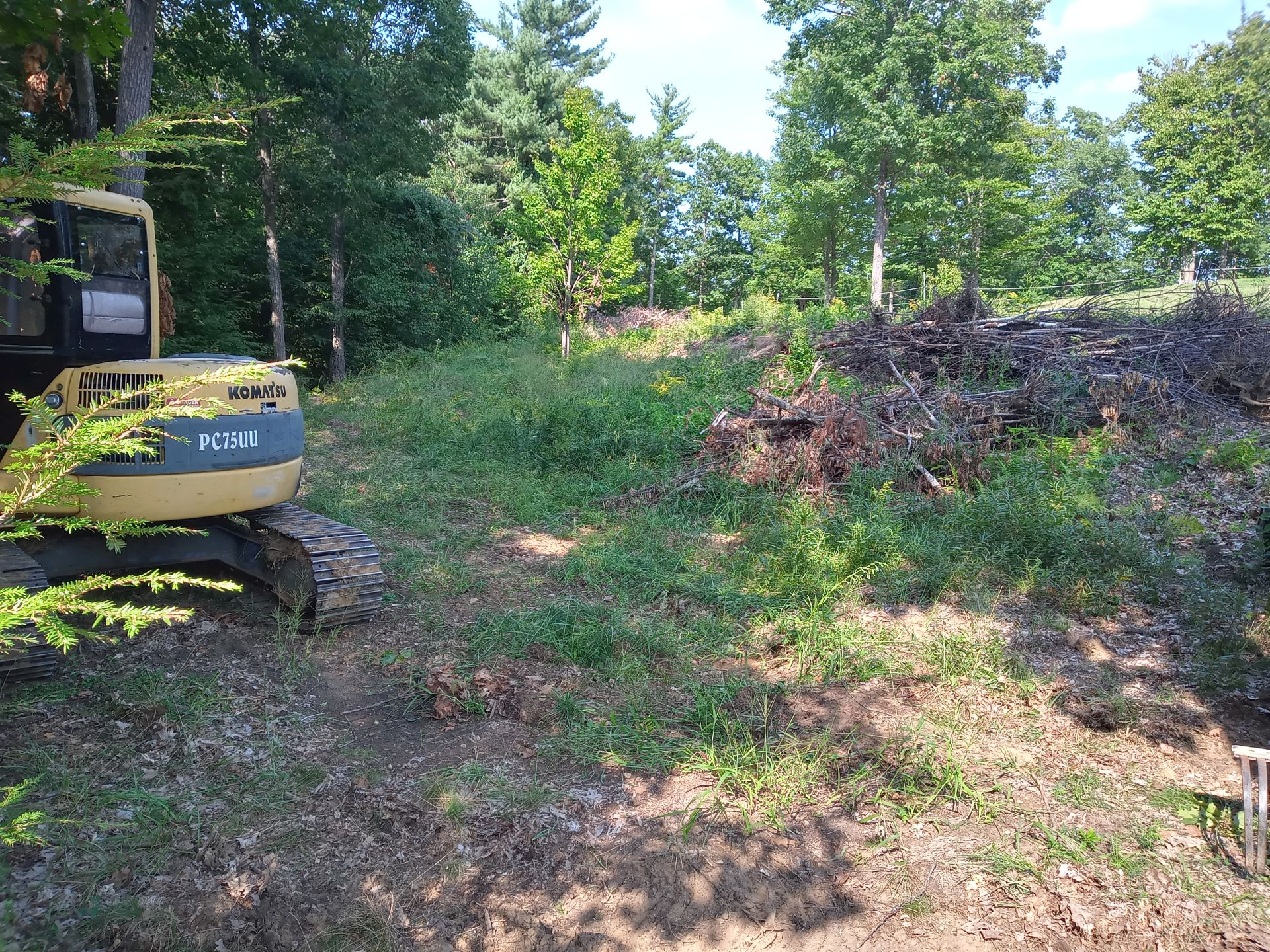

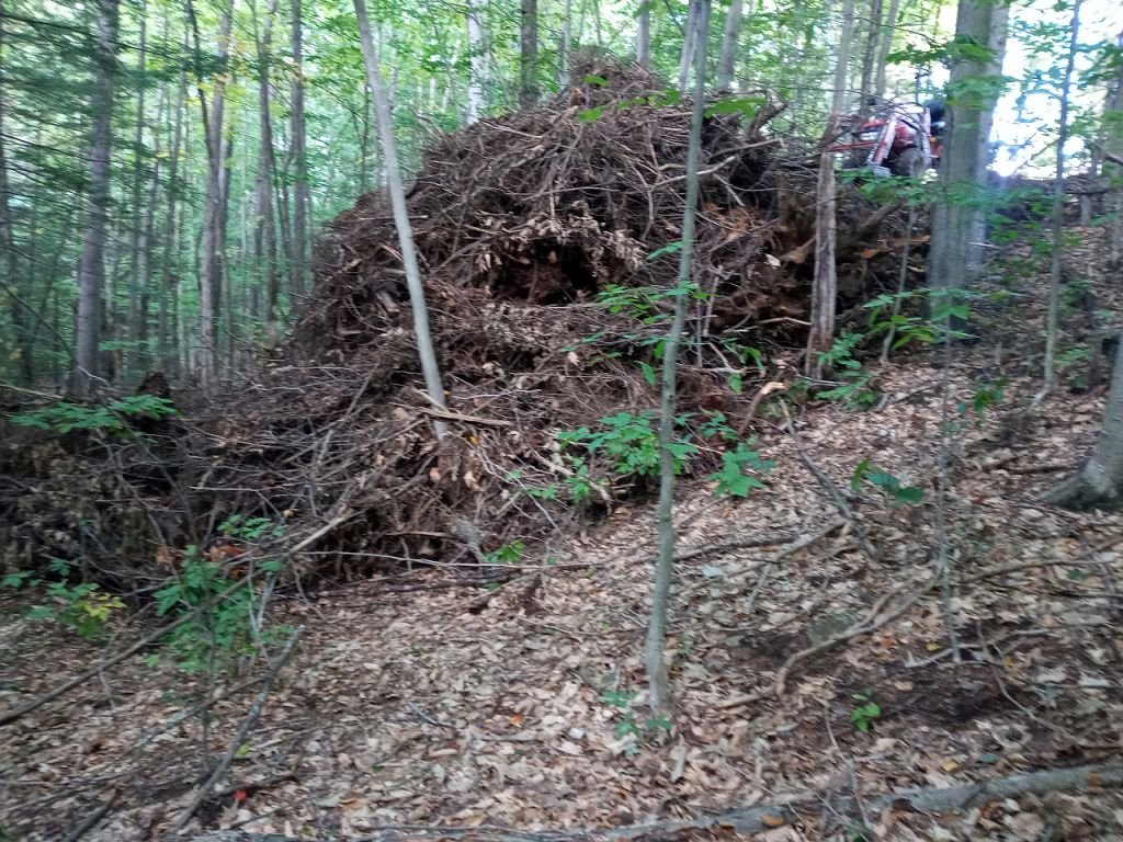

The I'st question is the best.
"Why am I clearing more land?"
I'm too old for this.
In less than a 70' x 50' area after harvesting a few cords of firewood look at the stump and brush piles.
Would not want to do this with an axe and Oxen.
Total new area cleared is at most an acre. and I even left it partially wooded.
Put an tank of fuel thru the repaired Max28 and used it very hard as my L39 is down for service for install of a new diverter valve.
Going to have lots of grapple work when I get it back.

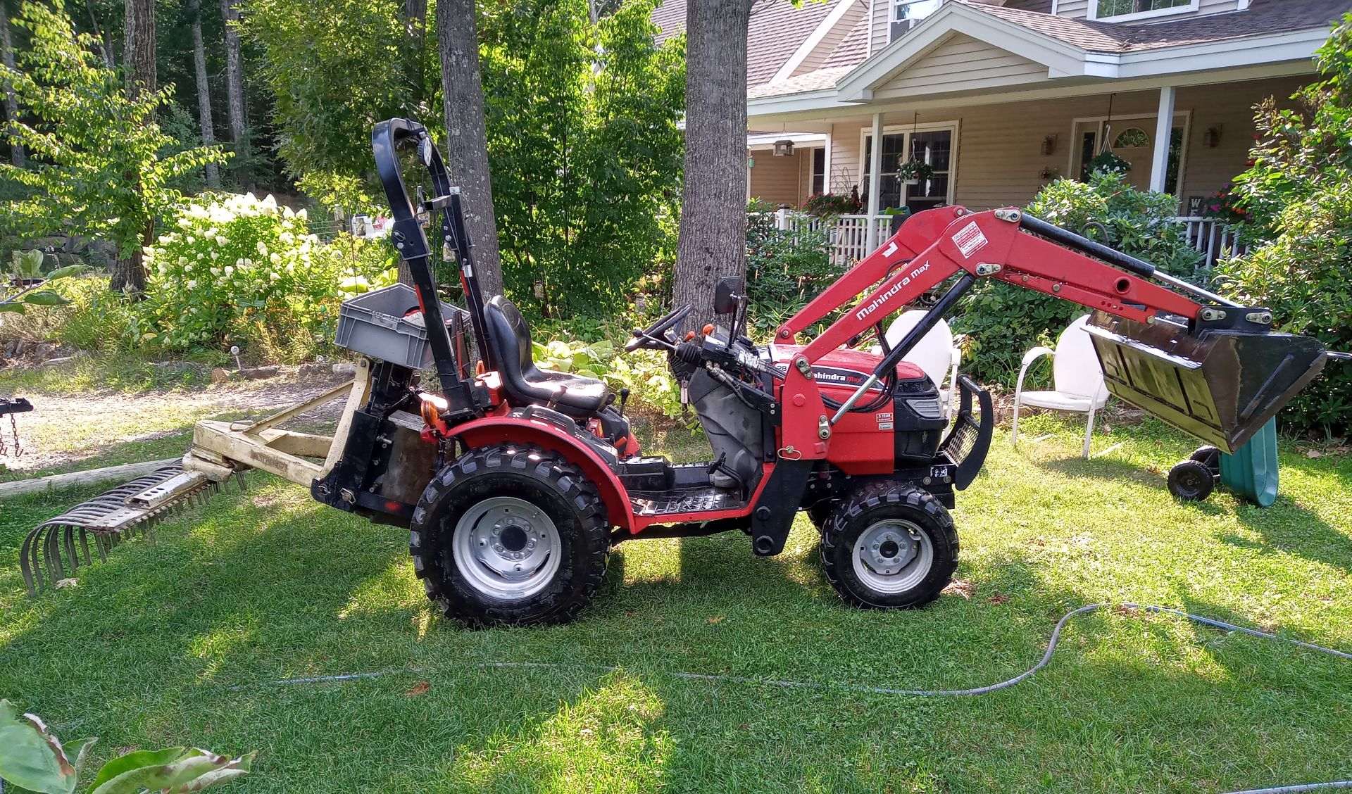

Still going strong, but I'm not, as shoulder surgery now has me out of commission at least 3 months.
PS,
My axle lock works great now, since I added the shim washer and replaced the chewed up dog sleeve.
From now on, I will be gentle using the axle lock to prevent damaging it again. Never engage it on the fly. It should be made of hardened steel.

My Max28 shuttle tractor now has +30 hours of typical hard use on it since my glue it back together repair. I think it is stronger than the original thin wall casting bearing support. I have no concerns. Also the rear axle lock shim modification makes it much easier and more positive to engage the axle lock.
Ps FYI: This filter is a bit longer, but this hydraulic filter fits just fine on my shuttle shift model.
